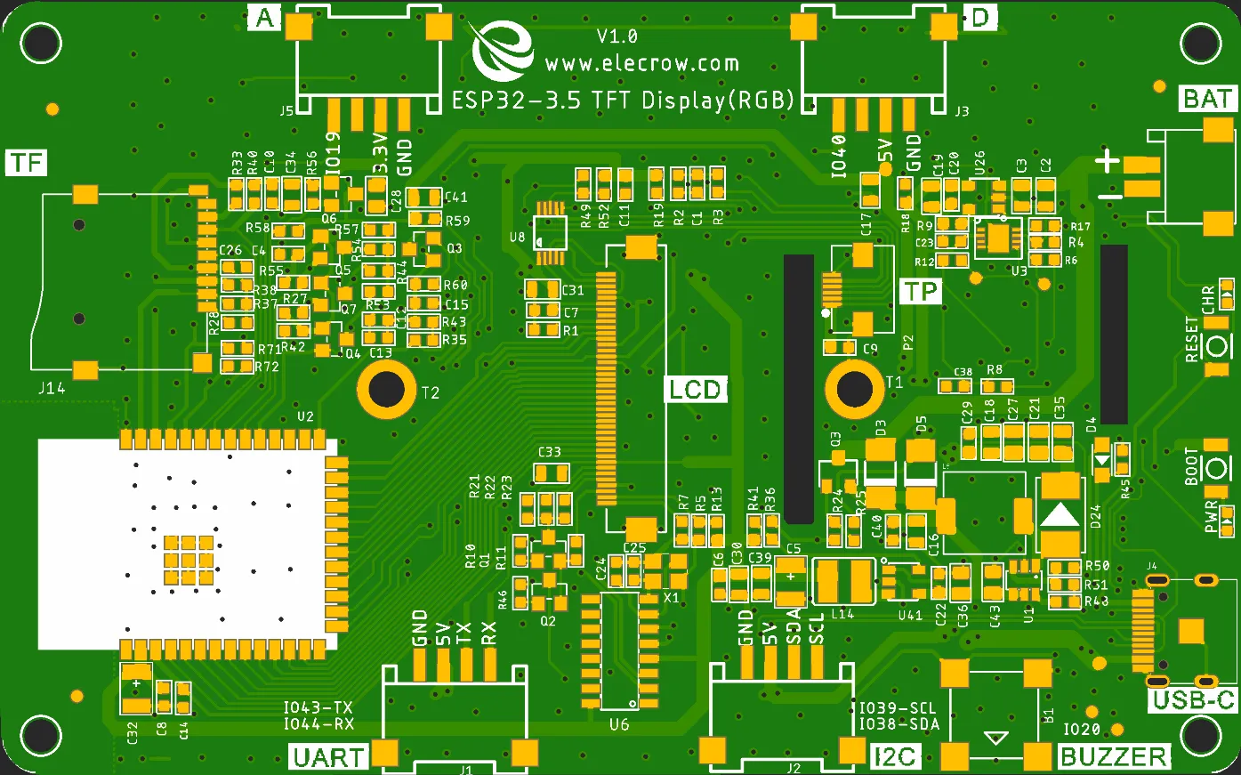

Hardware Information¶
| Pin Name | Description | Connector Type |
| PWR | Power LED | |
| RST | Reset button. Push it to reset the system | |
| BOOT | Long press the boot button for 3s and then press reset to put the board into download mode | |
| D Port | Digital I/O interface | HY2.0-4P |
| A Port | Analog I/O interface | HY2.0-4P |
| TF | Provide off-line save and extra storage space | |
| UART | Build the communication among logic modules, including serial communication module | HY2.0-4P |
| IIC | Connected to touch-screen. Bidirectional two-wire synchronous serial bus for connecting microcontrollers and peripherals | HY2.0-4P |
| BAT | Connect with the lithium battery. (With the battery charging circuit) | PH2.0-2P |
| 5V Power/Type C | The power supply for the development board and the communication interface between the PC and ESP32 S3 | USB-C |
| ESP32 Terminal RGB | Pin Number |
| D Port | IO40 |
| A Port | IO19 |
| UART | RX(IO44); TX(IO43) |
| I2C | SDA(IO38); SCL(IO39) |
| SD Card Slot(SPI) | MOSI(IO2); MISO(IO41); SCLK(IO42); CS(IO1) |
| Buzzer | IO20 |

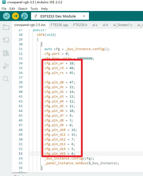

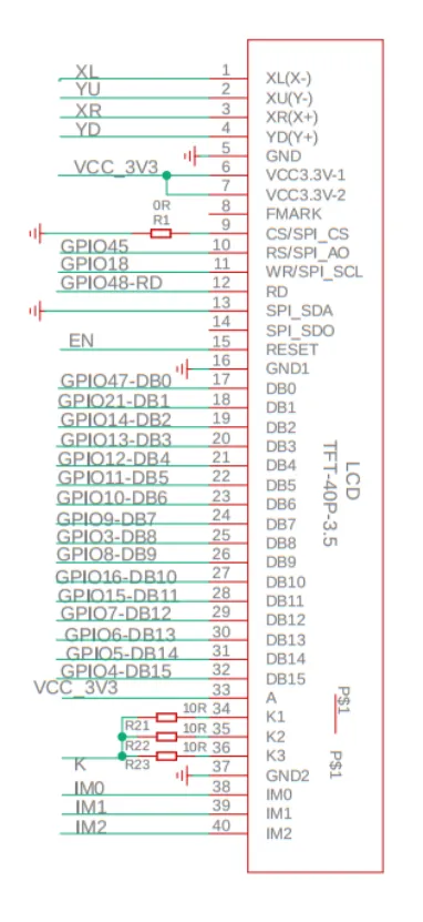

ESP32-S3 and display wiring
| Schematic | Code |
