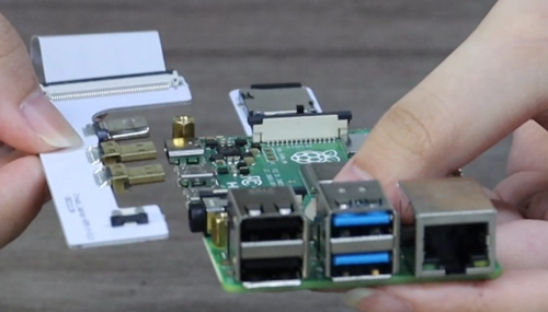

Install Raspberry Pi and boot¶
CrowPi L Rapspberry Pi Laptop Install Video
Correctly Install and Disassemble the Raspberry Pi Laptop
Step 1. Install the screws for Raspberry Pi which will be installed in the laptop
Step 2. Insert the 2-in-1 TF card adapter board into the TF card slot on the back of the Raspberry Pi
Step 3. Install HDMI expansion board
Step 4. Install USB adapter board and connect the flat cable to HDMI expansion board
Notice: The blue part is upward and the metal part is downward. Othervise there'll show nothing on the screen.
Step 5. Put the assembled Raspberry Pi into the Raspberry Pi storage compartment, there is a magnetic base at the bottom of the compartment to fix the Raspberry Pi.
Step 6. Connect the other end of the flat cable to the motherboard.
Warning: Don't install with power on!
Warning: Do not install it askew!
Otherwise, a short circuit may occur and the flat cable may be burnt, and fingers may be burned!
Step 7. Press the GPIO adapter board with fan from top to bottom to connect the 40 pins on both sides.
Step 8. Cover the Raspberry Pi protective cover.Step 9. Plug the 12V/2A type-c power adapter and press the power button at the top of the keyboard to start using. ![]()
