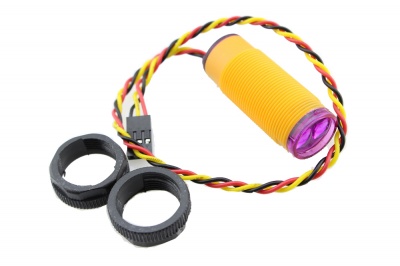

This infrared distance switch features a high-sensitivity photoreflector to perform distance detection function,ranging from 3cm to 80cm. When the infrared light emitted by the emitter gets reflected on a surface that blocked it, the phototransistor can pick up the signal for distance calculation. Also a potentiometer for adjustment is arranged for easy and clear use. It is small, easy to use/assemble, and inexpensive. Useful for robotics, interactive media, industrial assembly line, etc.
Model: SOD00380S
Features¶
- Power supply: 5V
- Current: 100mA
- Range: 3-80cm adjustable
- Red: +5V
- Yellow: Signal
- Black: GND
- Wire length: 20cm

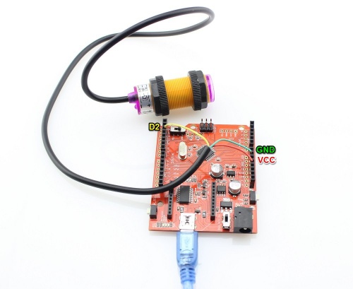

Connect this sensor to your Arduino/Crowduino digital pins( D2 for example). When there is an object behind this sensor, the output would be low. ![]()

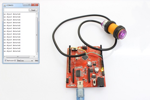

1.Download the following program to Arduino, Please refer to here
void setup() {
Serial.begin(9600);
pinMode(2,INPUT);
void loop() {
while(1) {
delay(500);
if(digitalRead(2)==LOW) {
Serial.println("object detected.");
else {
Serial.println("no object detected.");

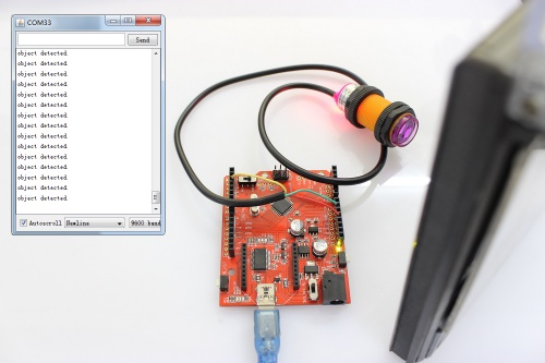

2.open the serial monitor , and set the baudrate to 9600, you will see the output changes with the object behind this sensor or not.
