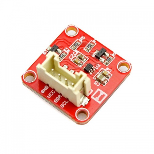

The MAX30105 is an integrated particle-sensing module. It includes internal LEDs, photodetectors, optical elements, and low-noise electronics with ambient light rejection. The MAX30105 provides a complete system solution to ease the design-in process of smoke detection applications including fire alarms. The MAX30105 is designed to operate at 5V and can communicate with both 3.3V and 5V microcontrollers.
Model: CRT00226P
Features¶
Built-in Red, IR, and Green LEDs
5V operation
Onboard 1.8V regulation and I2C interface circuitry
Sensitivity configurable down to 7.81pA
3200Hz maximum sample rate
Built-in 32 sample FIFO (First In, First Out
Dimensions(mm):20.0(L)x20.0(W)x11.8(H)
Application¶
Presence detection, distance sensing (18" max), pulse oximetry, blood oxygen saturation level (SpO2), smoke and particle detection
Usage¶
This demo will show you when When the sensor detects the object, the serial monitor will print "Something is there!".
Hardwire connection
The Crowtail- MAX30105 Particle Sensor is connecting to IIC port of Crowtail - Base Shield.
