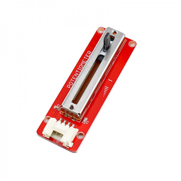

The Crowtail- Linear Potentiometer module uses a linear variable resistor with a maximum resistance of 10KΩ. When you move the slider from one side to the other, its output voltage will range from 0 V to the Vcc you applied. The panel mount design makes this module easy to be installed in projects.

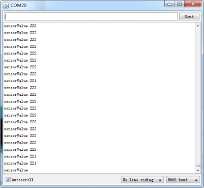

4.Open the serial monitor. You should see some data from ADC.
