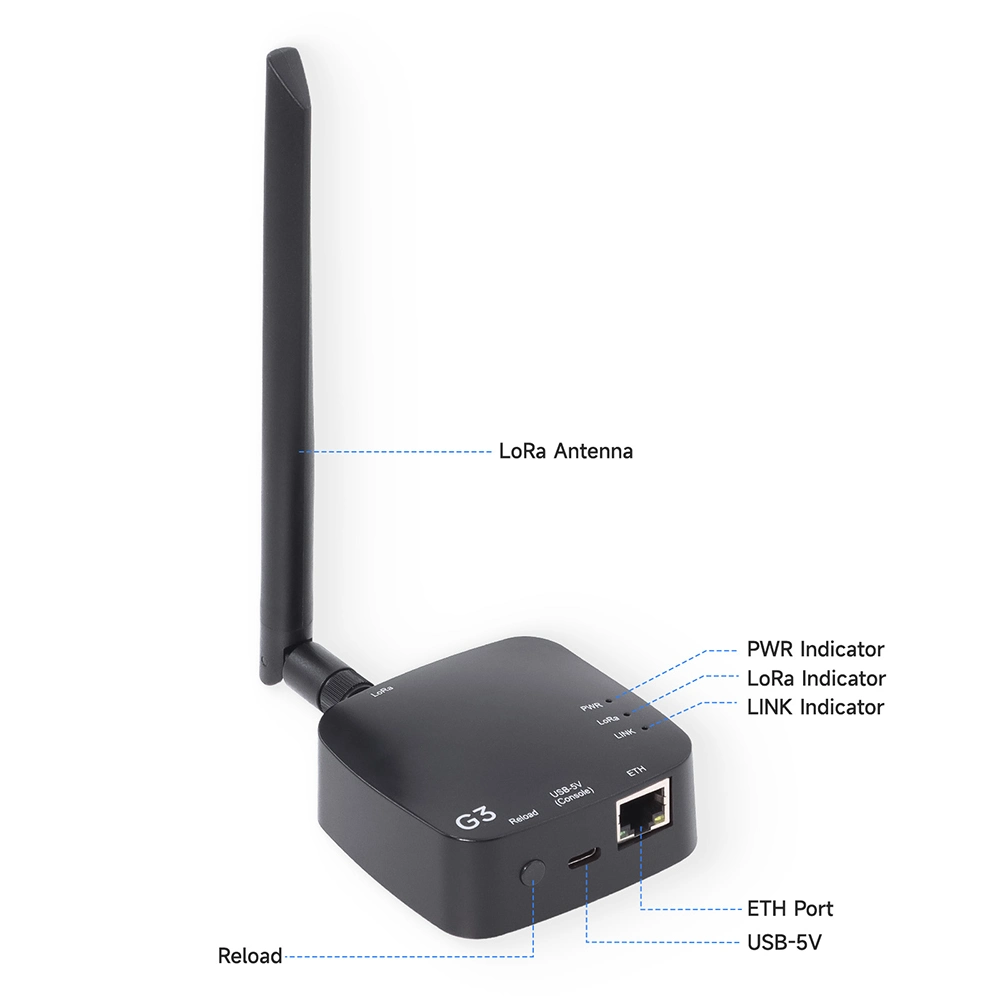

1、 Use type-c 5v power supply, connect the antenna to choose the corresponding frequency antenna, 868MHZ or 915MHZ antenna. The physical wiring diagram is as follows:¶
2、 Power on the device, press and hold the Reload button for 5 seconds, then release. The device will enter the gateway configuration mode, and the green LED(LINK) will blink, Use a computer or cell phone to connect to the gateway's Wi-Fi network (ThinkNode-G3_xxxxxx),with the password: 88888888.¶

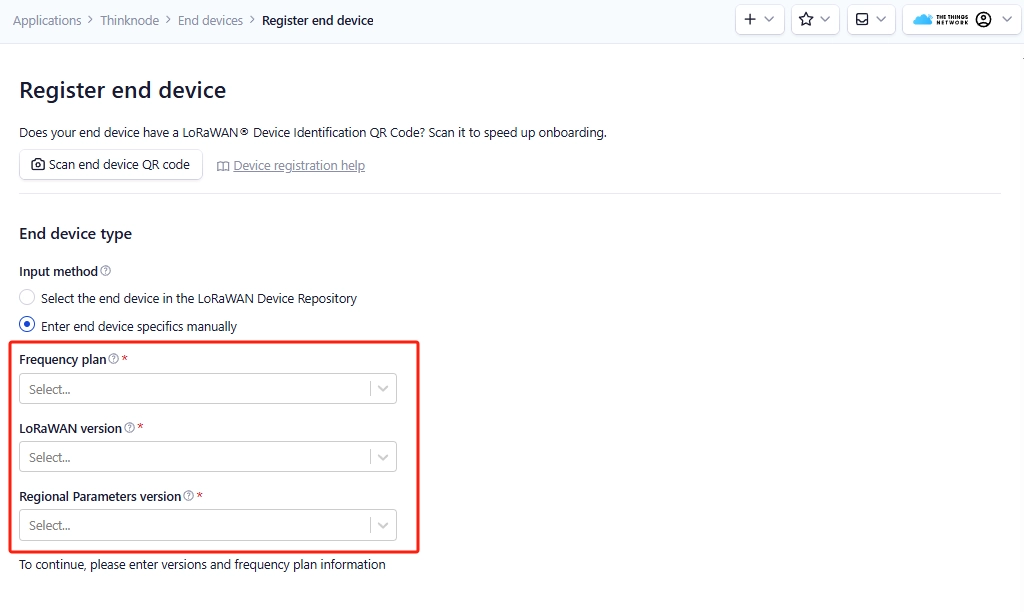

Step 4: In the “Register end device” page, click Enter end device specifics manually option.
Step 5: Set the Frequency plan, LoRaWAN version and Regional Parameters version to JoinEUI (APPEUI).
Note: JoinEUI means AppEUI.
Set the Frequency plan,note that the band range should be consistent with the gateway used.

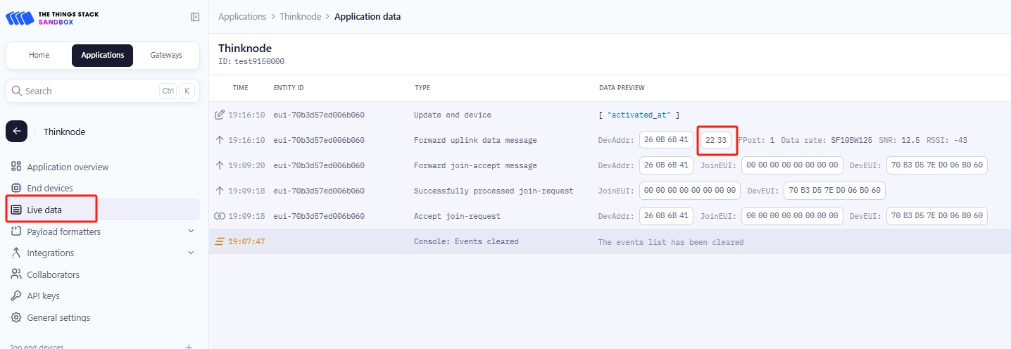

10、use “AT+SEND=1:0:2233” command to send data, in the background of the TTN server “Applications->Live data” you can see the node real-time sent data “2233”
