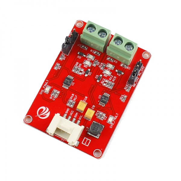

Crowtail Interface -Crowtail products have a eco system and all have a same connector which can plug onto the Base Shield. Connect this module to the I2C port of Base Shield, and then it can work well with Arduino. However, you can also connect Crowtail- I2C Motor Driver to Arduino without Base Shield by jumper wires.
CH1 fault indicator - Channel 1 fault indicator.
- CH2 fault indicator - Channel 2 fault indicator.
- Direction indicator - Motor direction indicator
- CH1 Output Connector - Motor 1 connector.
- CH2 Output Connector - Motor 2 connector.

The default maximum drive current of each channel is 200mA, see the front picture of the board
Each channel (CH1,CH2) has been added a resistor, and each value of resistor (R5,R12) is 1 Ω, so the maximum drive current is 200mA according to the following equation
Meantime, each channel provides a reserved solderable pad (R6 for CH1, R13 for CH2), so you can solder a resistor onto the board to change the resistor value of each channel. Following is the new equation if adding resistor to the board

The I2C address of each channel is changeable.You can find there's 4 jumper pin, A0_CH1 and A1_CH1 are for channel 1, A0_CH2 and A1_CH2 are for channel 2. As shown below:
You can Connect each jumper with jump hats to change the I2C address:
