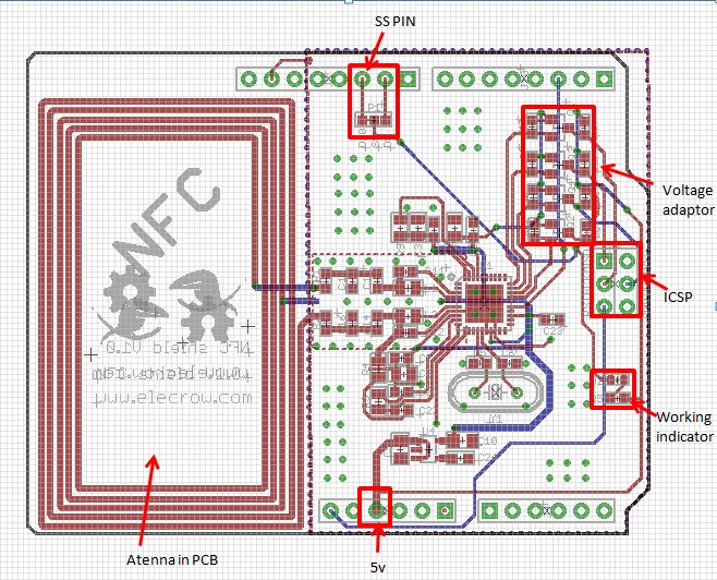

The NFC(Near Field Communications) Shield uses a highly integrated transceiver module PN532 which handles contactless communication at 13.56MHz. With the arduino library, you can read and write a 13.56MHz tag with this shield or implement point to point data exchange with two NFC Shields. This shield is designed to use SPI communication protocols. you can choose the PD9 or PD10 as SS pin. so it can be used compatible with more Arduino Shields which also uses the SPI communication protocal.

- Arduino Shield compatible. No soldering required.
- SPI interface. Hence, most Arduino pins are available for other applications.
- Built in PCB Antenna.
- Supports both 3.3V and 5V operation.
- Socket to connect other shields.

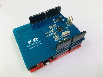

- Connect NFC Shield to Crowduino as shown below.

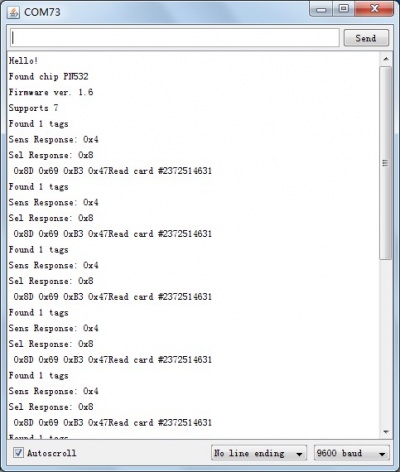

Donwload the PN532_SPI Library For NFC Shield and install it to \arduino\libraries. you can either copy the folling codes into Arduino IDE or open Open the examples in the library to start. Demo 1:Read the complete memory of a MIFARE card 1. Open and upload the example readAllMemoryBlocks example as show below.
This sketch reads the complete memory of a MIFARE Standard card using default authentication keys. The output gives typical memory layout of fresh MIFARE Standard card.

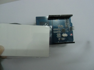

2. Bring a Mifare Card near the NFC Antenna ON PCB.
Note: Blocks are classified as Manufacturer Block(read-only), Data Block (user/application writable area), and Sector Trailer(authentication and access bits for that sector)
3.Open the serial monitor, you can see the score as shown below: ![]()

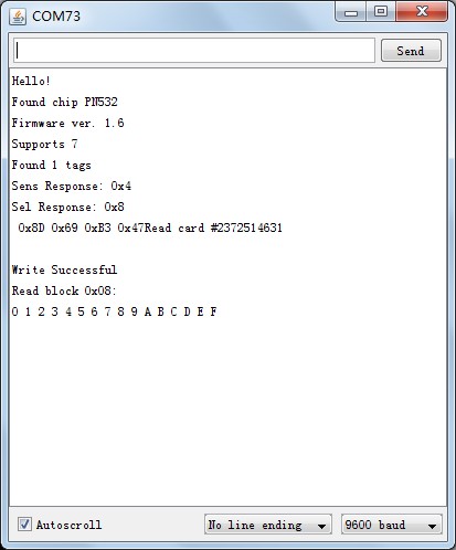

Demo 2: Write data to MIFARE Memory Block
1. Open the example writeMifareMemory. This example writes a MIFARE memory block 0x08 of a new MIFARE 1K cards using default authentication keys .Read the Block Memory after complete writing data to MIFARE Memory Block.
Note: Memory block 0 is readonly and contains manufacturer data. Do not write to Sector Trailer block unless you know what you are doing. Otherwise, the MIFARE card may be unusable in the future.
2. Compile and upload the example.
3. Bring a Mifare Card near the NFC Antenna.
4. Open the serial monitor, you can see the score as show below:
