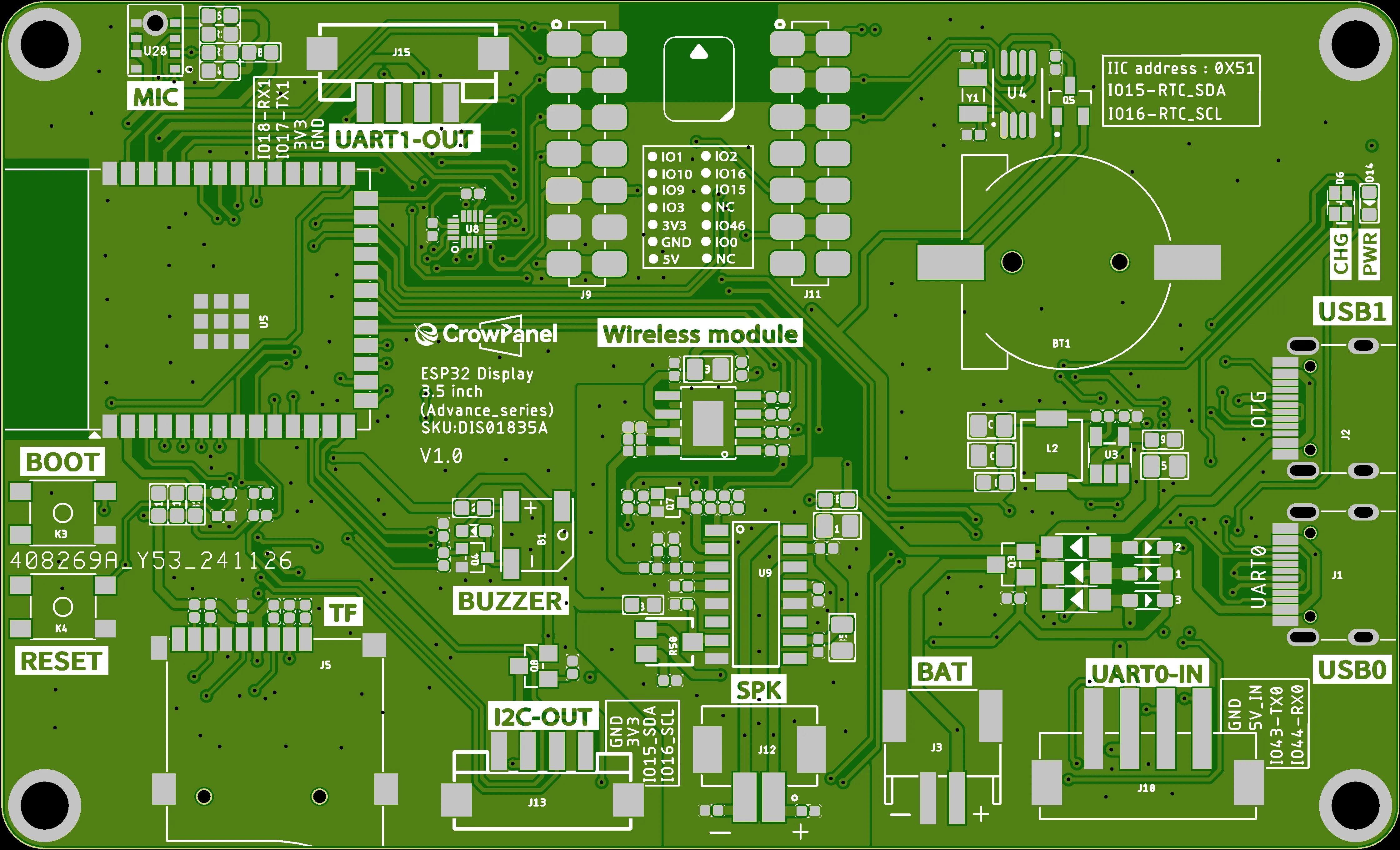

Functional description of the product's internal interfaces:
Pin Name Description Connector Type
SPK Output audio signals to connect to speakers. The main board comes with a power amplifier chip circuit. PH2.0-2P
PWR Power LED.
RST Reset button. Press it to reset the system.
boot
UART1-OUT Builds communication between Logic modules, including the serial communication module and the print module. HY2.0-4P
UART0-IN Input power supply and serial communication functionality XH2.54-4P
I2C-OUT Establish communication between the microcontroller and peripheral devices. HY2.0-4P
BAT Connect the lithium battery. (with battery charging circuit)(Input voltage: 3.7–4.2 V) PH2.0-2P

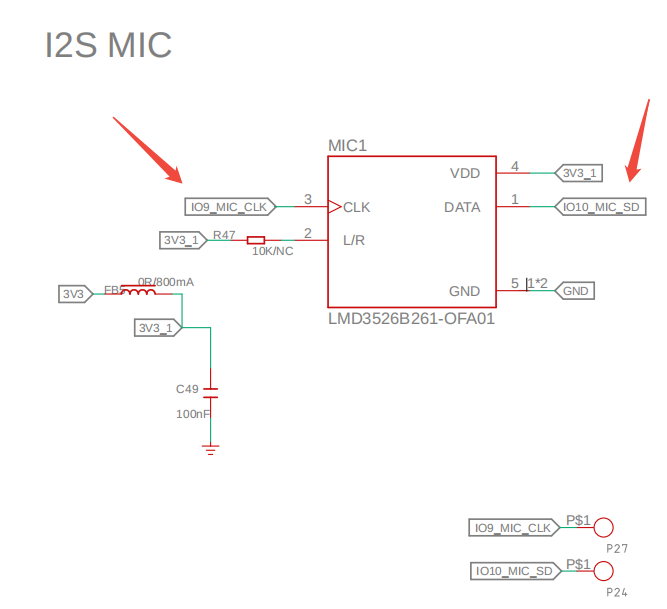

I2S MIC MIC_SD(IO10);MIC_WS(IO3);MIC_CLK(IO9) Maximum output current: 20mA
Signal type: 3.3V logic level, digital control signal

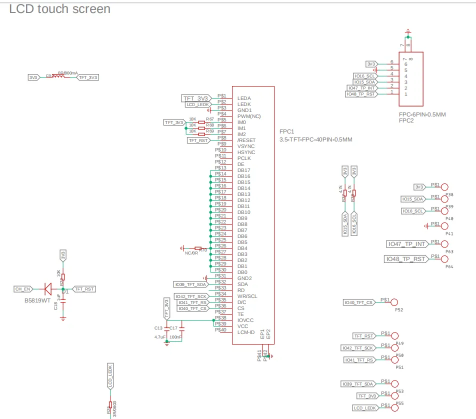

Schematic:
ESP32-S3 and ISP Display Wiring Pins:
advance-3.5-2

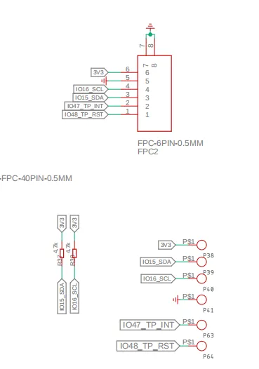

ESP32-S3 and Touch Driver Wiring:
i2c address: 0X5D.

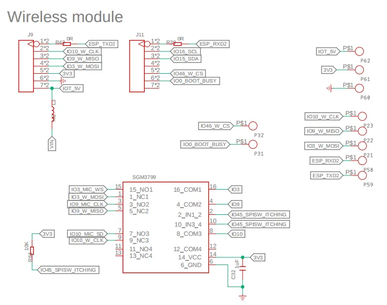

ESP32-S3 and wireless module wiring pins:
advance-3.5-4
Switching Function Keys:
IO45 level effective function
1 MIC
0 WM(wireless module)
Wireless module pins:
image-20250108175238121
IO1 IO2
IO10 IO16
IO9 IO15
IO3 NC
3V3 IO46
GND IO0
5V NC

V1.2 upgraded, optimized the amplifier circuit, better sound quality, and use IO21 to control mute. i2s_mic changed to two pins IO9 and IO10 control.
