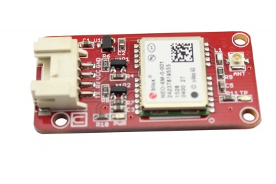

Crowtail- GPS
Description¶
This Crowtail - GPS module is a cost-efficient and field-programmable gadget armed with a SIM28 (U-blox 6 is old version) and serial communication configuration. It features 22 tracking / 66 acquisition channel GPS receiver. The sensitivity of tracking and acquisition both reach up to -160dBm, making it a great choice for personal navigation projects and location services, as well as an outstanding one among products of the same price class.
Model: CT0055GPS
Specification¶
- Input Voltage: 3.3V, 5V
- BaudRate: 4800 - 57600( u-blox version)
- BaudRate: 9600 - 115200
- Default BaudRate: 9600
- Supports NMEA and U-Blox 6 protocols
- Low power consumption
- Baud rates configurable
- Crowtail compatible interface
- Dimensions(mm):40.0(L)x20.0(W)x6.8(H)
