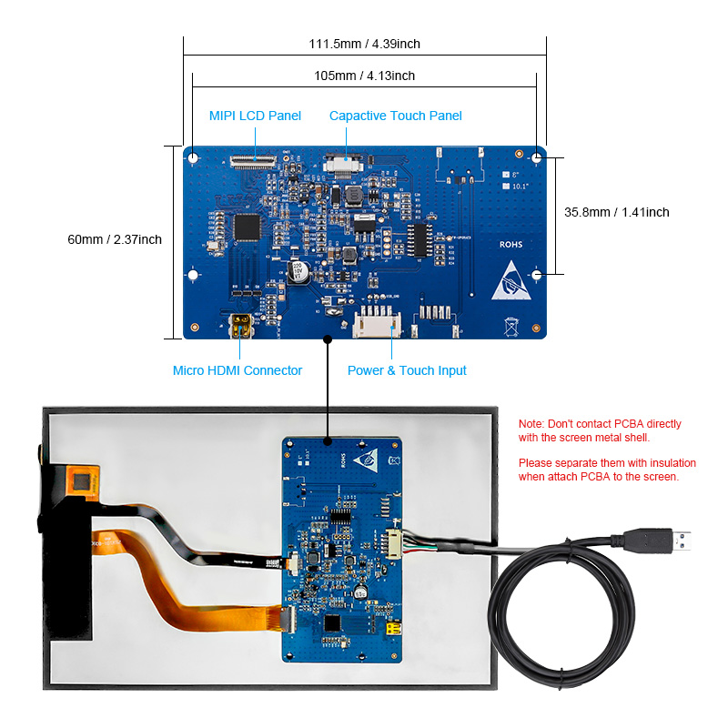

Driver Board
| PCBA Dimension | 111.5(W) x 60(H) x 7.5(T) mm |
| Supported Touch Panel | Capactive Touch Panel |
| Input Signal Interface | Micro HDMI Female Connector |
| USB Port Interface | 5 Pin 2mm Pitch Connector |
| Input Voltage | 5V |
| Operating Temperature | -10 ~60 ℃ |
| Storage Temperature | -20 ~80 ℃ |

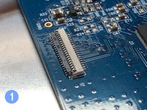

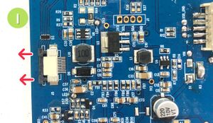

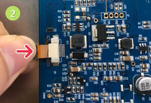

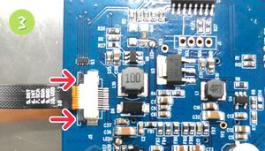

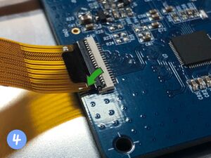

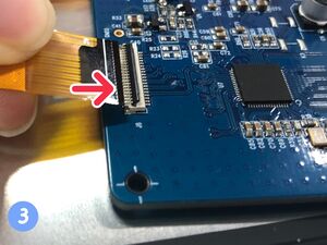

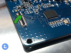

How to connect flat cable¶
1. MIPI LCD Panel
2. Capactive Touch Panel

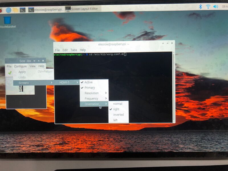

Raspberry Pi OS touchscreen rotate¶
Step 1 LCD Display rotate
Head to your Pi desktop and click on the Pin icon on the top left of the display. Hover on the preferences option and click on Screen configuration. Select the display you wish to rotate. Hover over orientation and choose the way you want to modify your Display. Click on the Ok button to confirm and wait for 10 seconds till the timer ends.

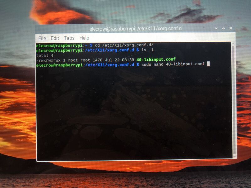

2.2 Modifying configuration files 2.2.1 Install libinput,Check whether there is the file 40-libinput.conf in the directory /usr/share/x11/xorg.conf.d/If not, it needs to be installed
2.2.2 Copy the file to /etc/x11/xorg.conf.d/ directory
2.2.3 Enter /etc/x11/xorg.conf.d/ directory and modify 40 libinput Conf file
Find touchscreensection
Section"InputClass"
Identifier "libinput touchscreencatchall"
MatchIsTouchscreen "on"
MatchDevicePath "/dev/input/event*"
Driver "libinput"
EndSection
Add a line of option "calibrationmatrix" "0 1 0 -1 0 1 0 0 1" The result is
Section"InputClass"
Option "CalibrationMatrix" " -1 0 1 0 -1 1 0 0 1“
Driver "libinput"
EndSection
Step 3 Reboot
Note:****1.CalibrationMatrix
90 degree rotation:Option "CalibrationMatrix" "0 1 0 -1 0 1 0 0 1"
180 degree rotation:Option "CalibrationMatrix" "-1 0 1 0 -1 1 0 0 1"
270 degree rotation:Option "CalibrationMatrix" "0 -1 1 1 0 0 0 0 1"
2.If you cannot rotate the touch screen through vim, please use nano
3.Get file permissions
