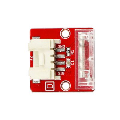

The Crowtail-knock sensor is a piezoelectric sensor that contains a piezoelectric sensing crystal and a resister. This crystal creates a small amount of voltage when shaken and takes advantage of this unique property. It will output a pulse when vibration is detected.
Model: CRT00516K
Features¶
- Digital Crowtail connector
Specifications¶
| Item | Value |
| Presence sensing | vibration |
| Sensor | KY-031 |
| Power supply | 5V |
| Dimensions(mm) | 20.0(L)x20.0(W)x7.1(H) |
Pin Map¶
| Pin Name | Description |
| VCC | Supply Voltage |
| GND | GND |
| SIG | Output a pulse when vibration is detected |
