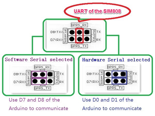

Serial port select - select either software serial port or hareware serial port to be connected to GPRS Shield
Hardware Serial - D0/D1 of Arduino/Crowduino/Seeeduino
Software serial - D7/D8 of Arduino/Crowduino/Seeeduino only

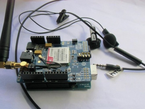

Microphone - to answer the phone call
Speaker - to answer the phone call

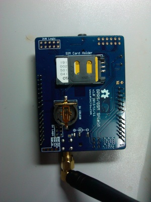

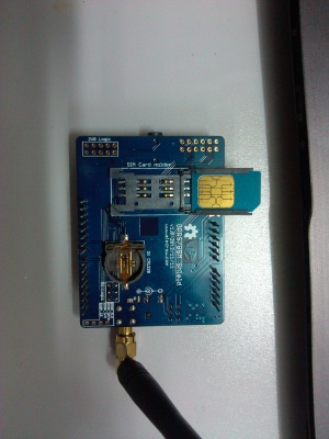

- Insert an unlocked SIM card to SIM Card Holder - 6 Pin Holder for SIM Cards. Both 1.8 volts and 3.0 volts SIM Cards are supported by SIM900 - the SIM card voltage type is automatically detected.

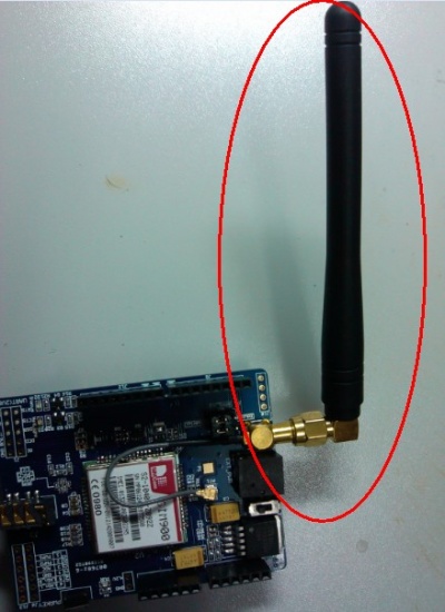

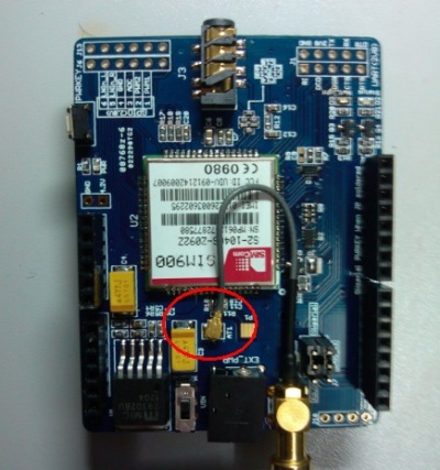

- Make sure the antenna pad buckled properly - A miniature coaxial RF connector is present on the GPRS Shield board to connect with a GSM Antenna. The connector present on the GPRS Shield is called a U.FL connecto. The GSM Antenna supplied with the GPRS Shield has an SMA connector (and not an RP-SMA connector) on it. A patch cord is also supplied with the GPRS Shield to interface the antenna to the board. The connection topology is shown in the diagram below:
- Assemble the GSM antenna

- Serial Port(UART) Communication
The GPRS Shield is used UART protocol to communicate with an Arduino/Arduino clone; Users can use jumpers to connect (RX,TX) of the shield to either Software Serial(D8,D7) or Hardware Serial(D1,D0) of the Arduino.Detailed information is showed as the following picture:
Selectalbe GPRS Shield Communication Port Note:

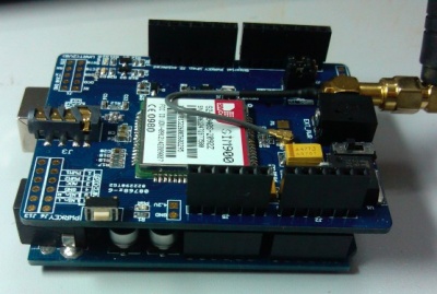

Plug to Arduino UNO R3 - The GPRS Shield, like any other well designed shield, is stackable as shown in the photo below.

- Set the Serial Port jumpers on the GPRS Shield in SWserial position, to use the Soft Serial port of Arduino.
- Connect the antenna to the GPRS Shield and insert the SIM Card.
- Mount the GPRS Shield on Arduino.
- Connect the Arduino to the computer by USB, and fire up your favorite serial terminal software on computer, choose the COM port for Arduino, set it to operate at 19200 8-N-1.
