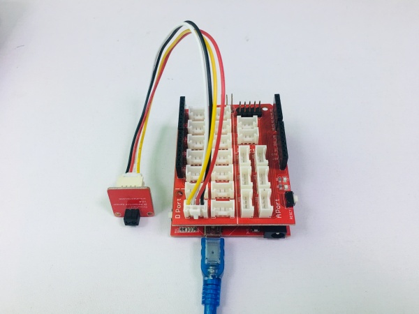

1.Hardware Connetion
The Crowtail- IR Reflective Sensor connected the D5 of Arduino.
2.Connect the board to PC using USB cable.
