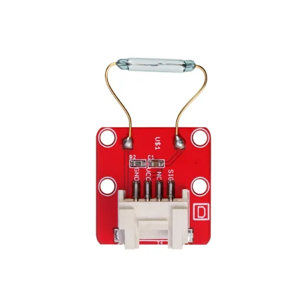

This is a Crowtail interface compatible Magnetic switch module. It is based on encapsulated dry reed switch MKA14103. MKA14103 is single-pole, single throw (SPST) type, having normally open ruthenium contacts. The sensor is a double-ended type and may be actuated with an electromagnet, a permanent magnet or a combination of both. The magnetic switch is a wonderful tool for designers who would like to turn a circuit on and off based on proximity.

1.The SIG pin of the module output LOW normally. When a magnet approaches the switch, the magnetic switch close and the SIG pin output HIGH. The following sketch demonstrates a simple application of using the Magnetic switch to control the led. When you put a magnet that has enough magnetic power close to the module, the switch is closed .Then the SIG pin out put a high voltage. You can use this to control the led. As the picture on the below indicates, the Magnetic switch is connected to digital port 2 of the Crowtail - Basic Shield and the LED is connected to digital port 5. When there is Magnetic approaches the switch, the SIG pin output a High voltage. Then the LED light. The hardware installation is as follows:
