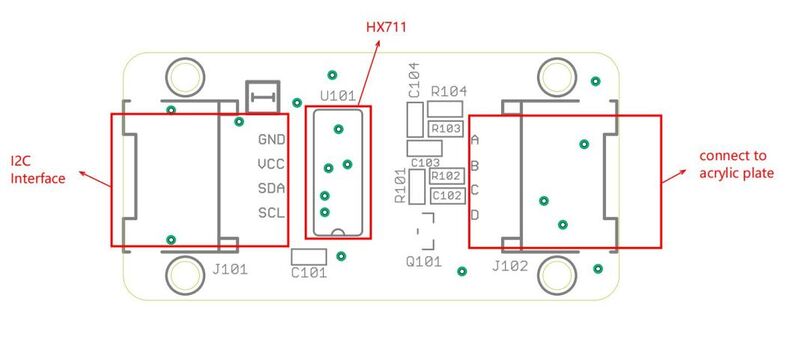

STEP4 Plug acrylic board to ABCD interface of Crowtail-Weight Sensor;

| Crowduino Uno | Weight Sensor |
| A4(J7) | SDA |
| A5(J7) | SCL |
| 5V | VCC |
| GND | GND |

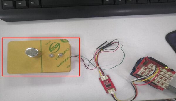

STEP6 After the program is burned, open the serial port monitor of Arduino IDE, set baud rate to 9600, and put no weight on the acrylic board, then the serial port print will be 0G, as shown in the figure:
STEP7 Put the weight on the acrylic plate, and the serial port will print the corresponding weight. For example, if I put a 50g weight, the serial port will print 50g, and the serial port print value is consistent with the actual value, as shown in the figure:
