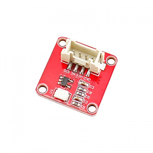

The Crowtail- UV Sensor(GUVA- S12SD) 2.0 is a module that can measures the intensity of ultraviolet light. It very suitable to measure the total amount of ultraviolet ray of sunlight, the response time is fast and have all interchangeability. It can aslo detect the 200-370nm UV wavelength.

1.Connect the LED to Base Shield's analog port A0 with 3pin Crowtail Cable.
2. Plug it onto the Arduino/Crowduino. Connect the board to PC via USB cable.
3.Copy the demo code to your sketch, then upload to Arduino or Crowduino board.
