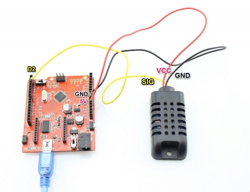

This Sensor has 3 wires, connect these wires to your Arduino/Crowduino Project as following:
| Sensor | Arduino/Crowduino |
| Red | +5V |
| Black | GND |
| Yellow | Digital I/O |
