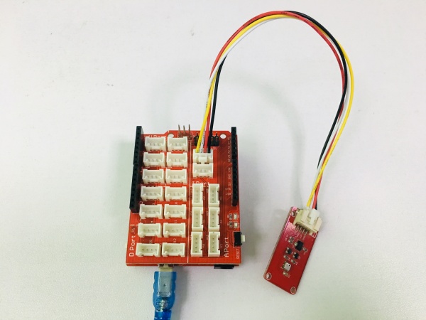

1.Hardware connection
Connect it to IIC port of Crowduino.
