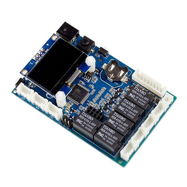

The smart Pump Shield is based on Arduino Lenardo which has integrated into the mainboard. The mainboard will send the command to turn on the pump and suck water into the switch, the switch will separate the stream and will give just enough water for your plants. Then it will close the pump and the switch and continue to check when does your plant needs water. We add a RTC to set timing watering and a 0.96 inch OLED to show the time and the soil moisture status.
Model: PSMC18001M
Features¶
- Eliminates the need for messy jumpers and breadboards, connect all sensors and modules with ease!
- Integrated Arduino UNO into the main board, program it easily.
- Power the board with single 12V power supply directly.
- 4 interfaces for sensors, one interface for water switch and one interface for motor or pump.
