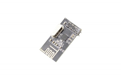

This module uses the newest 2.4GHz transceiver from Nordic Semiconductor, the nRF24L01.This transceiver IC operates in the 2.4GHz band and has many new features! Take all the coolness of the nRF2401A and add some extra pipelines, buffers, and an auto-retransmit feature.
Model:WRF24010R

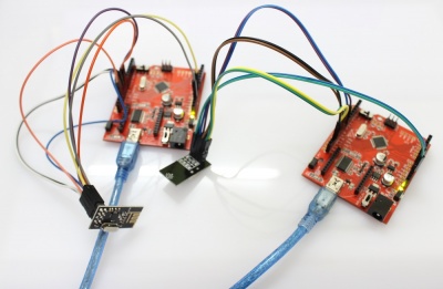

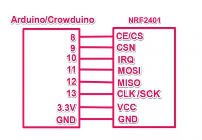

1.Hardware Connection.
First of all, of course, you need two Arduino boards and at least two RF modules, one to transmit and the other to receive.

** SPI-compatible **
** CS - to digital pin 8 **
** CSN - to digital pin 9 (SS pin) **
** IRQ - to digital pin 10 (IRQ pin) **
** MOSI - to digital pin 11 (MOSI pin) **
** MISO - to digital pin 12 (MISO pin) **
** CLK - to digital pin 13 (SCK pin) **

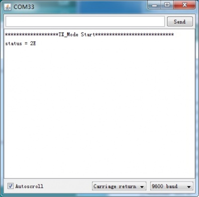

unsigned char sstatus=SPI_Read(STATUS);
Serial.println("*******************TX_Mode Start****************************");
Serial.print("status = ");
Serial.println(sstatus,HEX); // There is read the mode’s status register, the default value should be ‘E’
TX_Mode(); // set TX mode

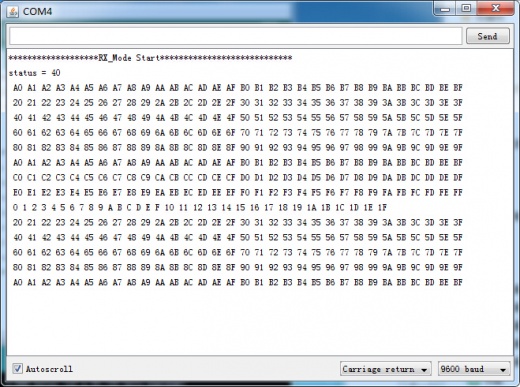

3.Download the code below into the RX Arduino (receive) – This code will drive the nFR24L01 module to receive the data that transmit form the TX module and print it to serial port.

unsigned char status = SPI_Read(STATUS); // read register STATUS's value
if(status&RX_DR) // if receive data ready (TX_DS) interrupt
SPI_Read_Buf(RD_RX_PLOAD, rx_buf, TX_PLOAD_WIDTH); // read playload to rx_buf
SPI_RW_Reg(FLUSH_RX,0); // clear RX_FIFO
for(int i=0; i<32; i++)
Serial.print(" ");
Serial.print(rx_buf[i],HEX); // print rx_buf
Serial.println(" ");
SPI_RW_Reg(WRITE_REG+STATUS,status); // clear RX_DR or TX_DS or MAX_RT interrupt flag

4.Now power on both Arduino , and connect the RX one to PC via USB. Open the IDE serial port monitor , change the baud rate to 9600 bps , and you can see the data that received.
