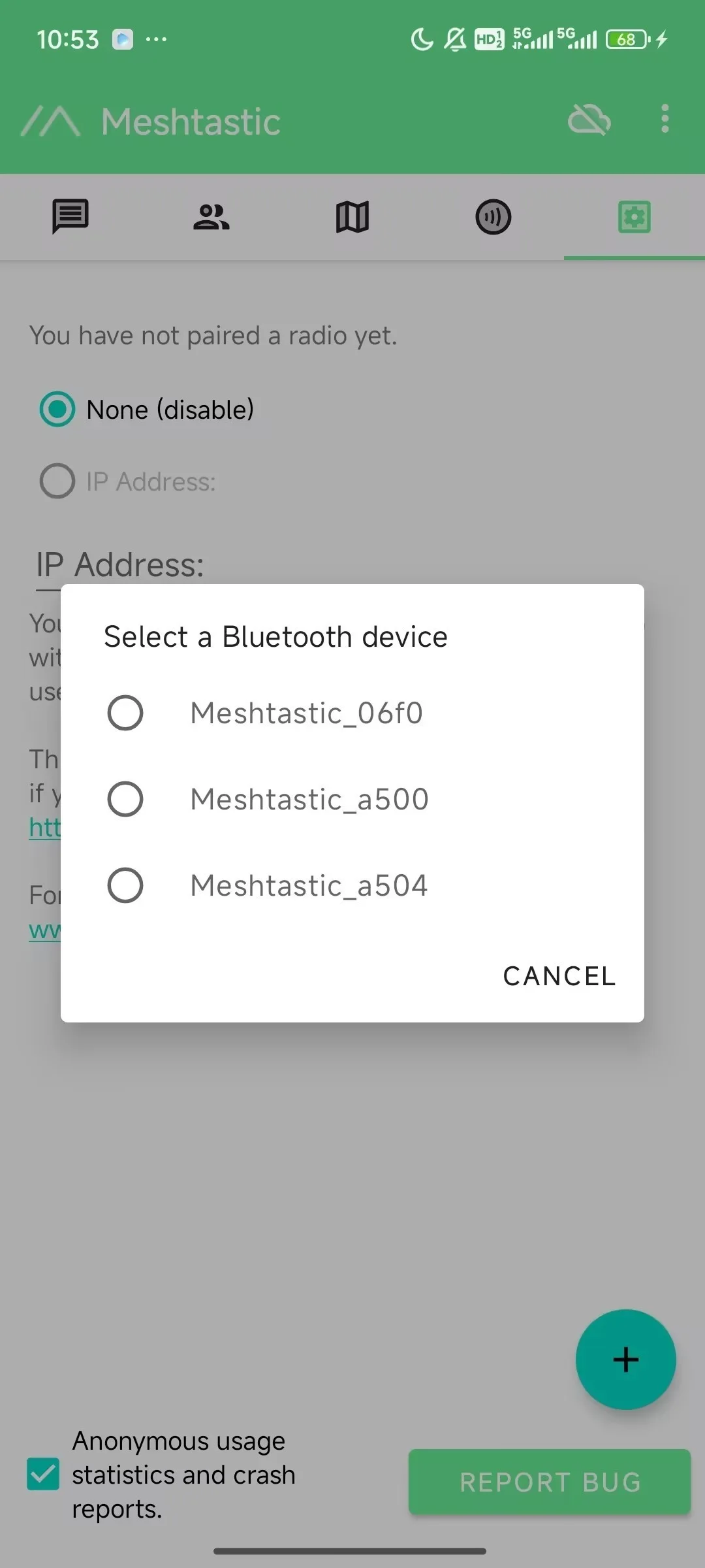

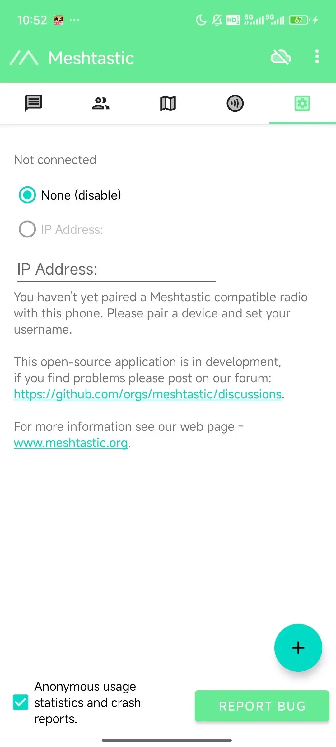

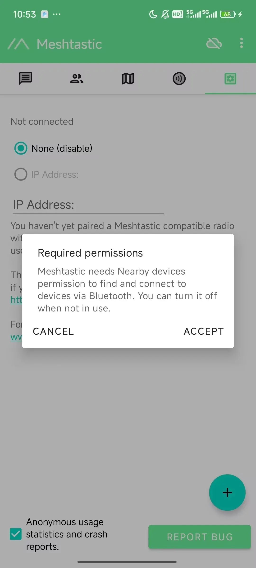

After opening the app, select the top far right and click on Configuration, click on the + in the bottom right corner to find the Meshtastic Bluetooth device.
ThinkNode-M2
ThinkNode-M2-2

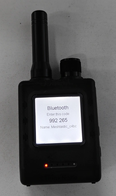

2)When the Meshtastic_xxxx device is searched, tap to enter pairing mode.

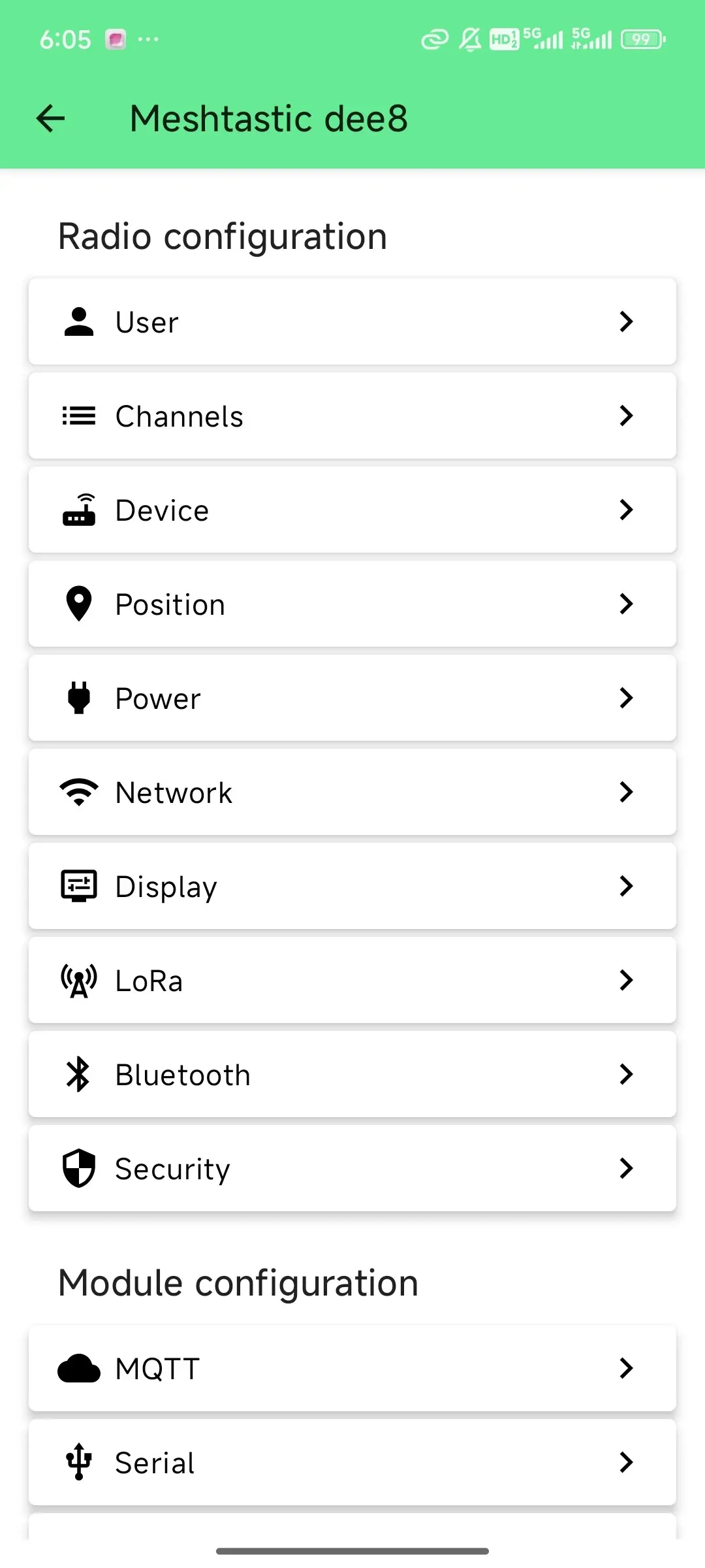

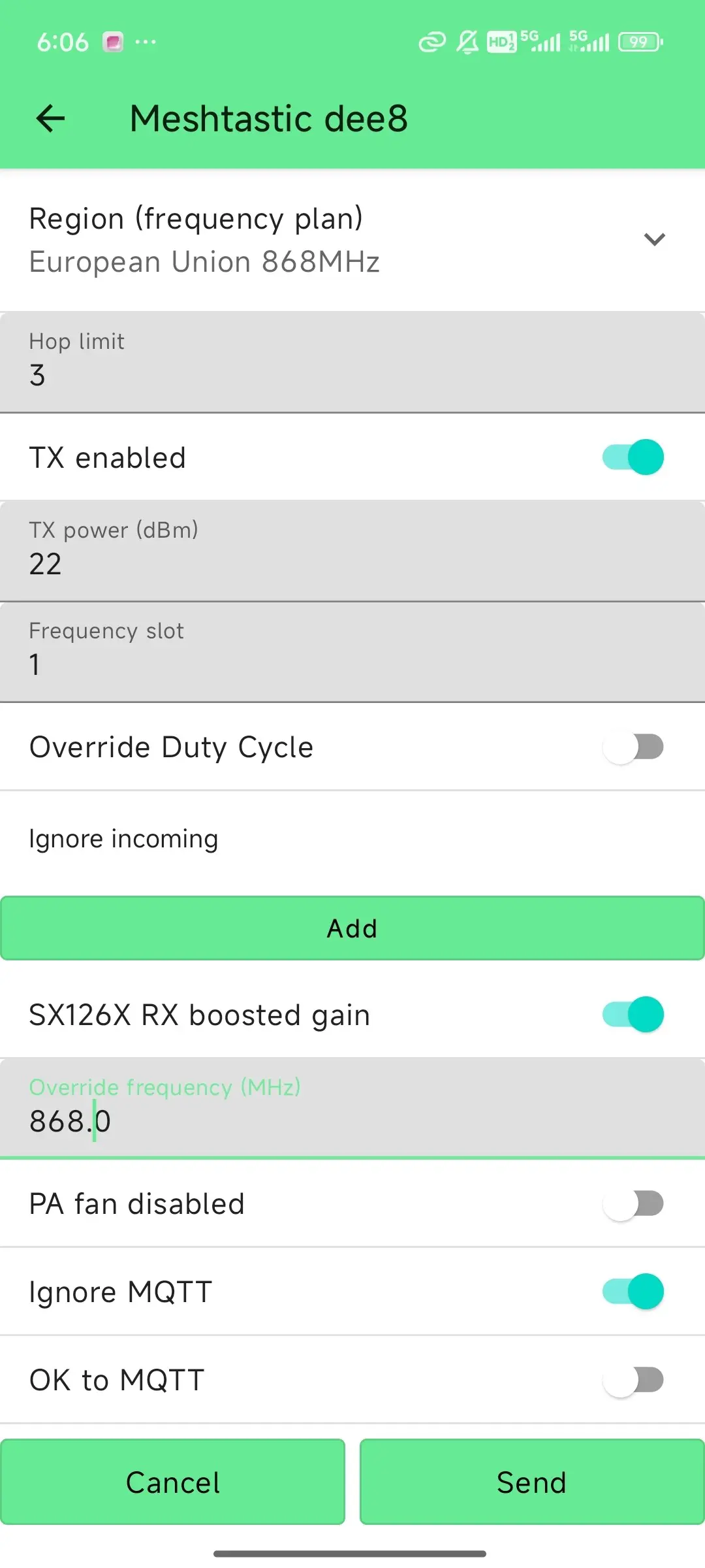

4) Set lora frequency, click on the upper right corner of the three points, click on “Radio configurtion”, and then click on “Lora”, scroll down to the ‘Add’ column, in the “Override frequency (Mhz)” at the corresponding frequency written.
lora setting-3lora setting-2
lora setting-3

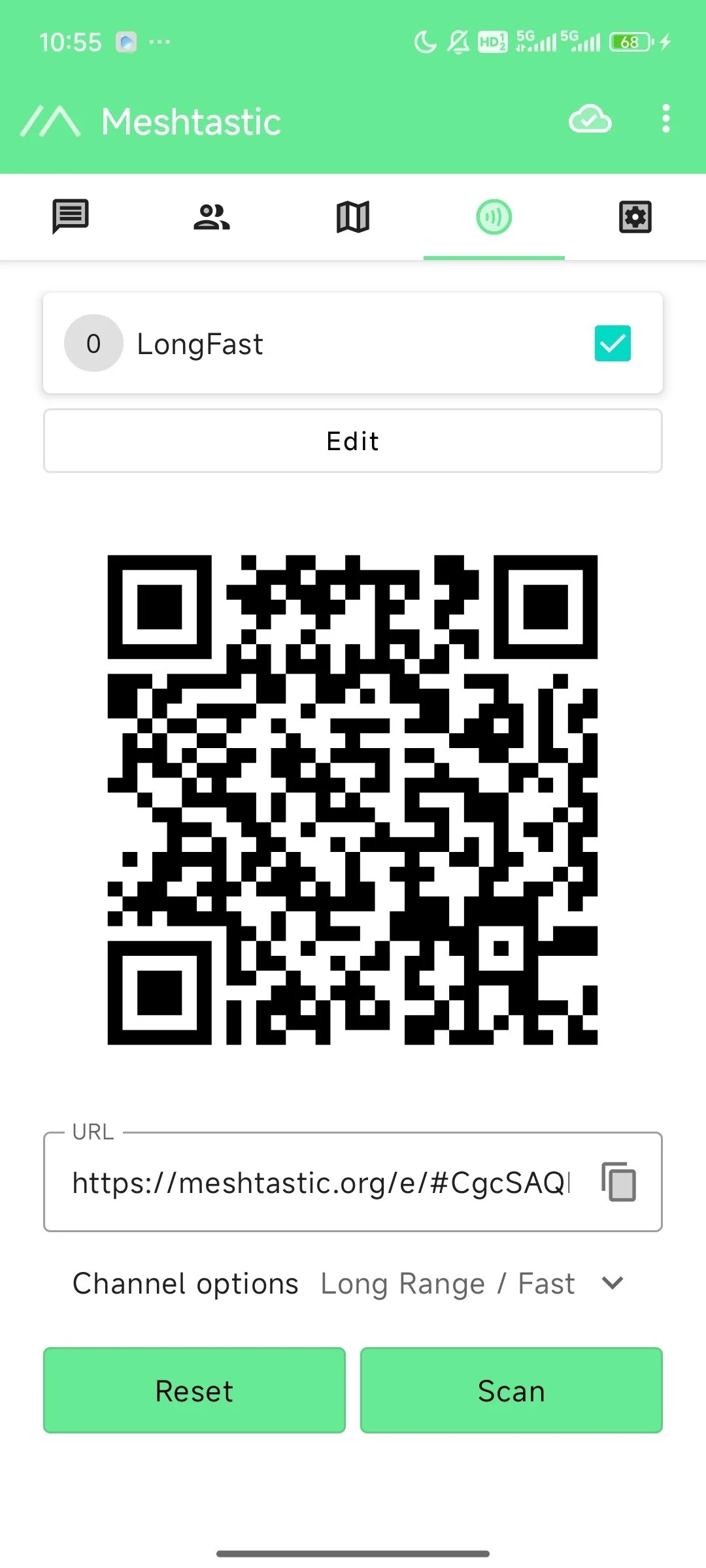

5)If two devices want to communicate, they need to join to the same channel, this time you need to select the fourth of the five options above, the other end of the phone needs to join to the same channel by scanning the code or entering the link, the channel can be customized name and so on.
ThinkNode-M2-7

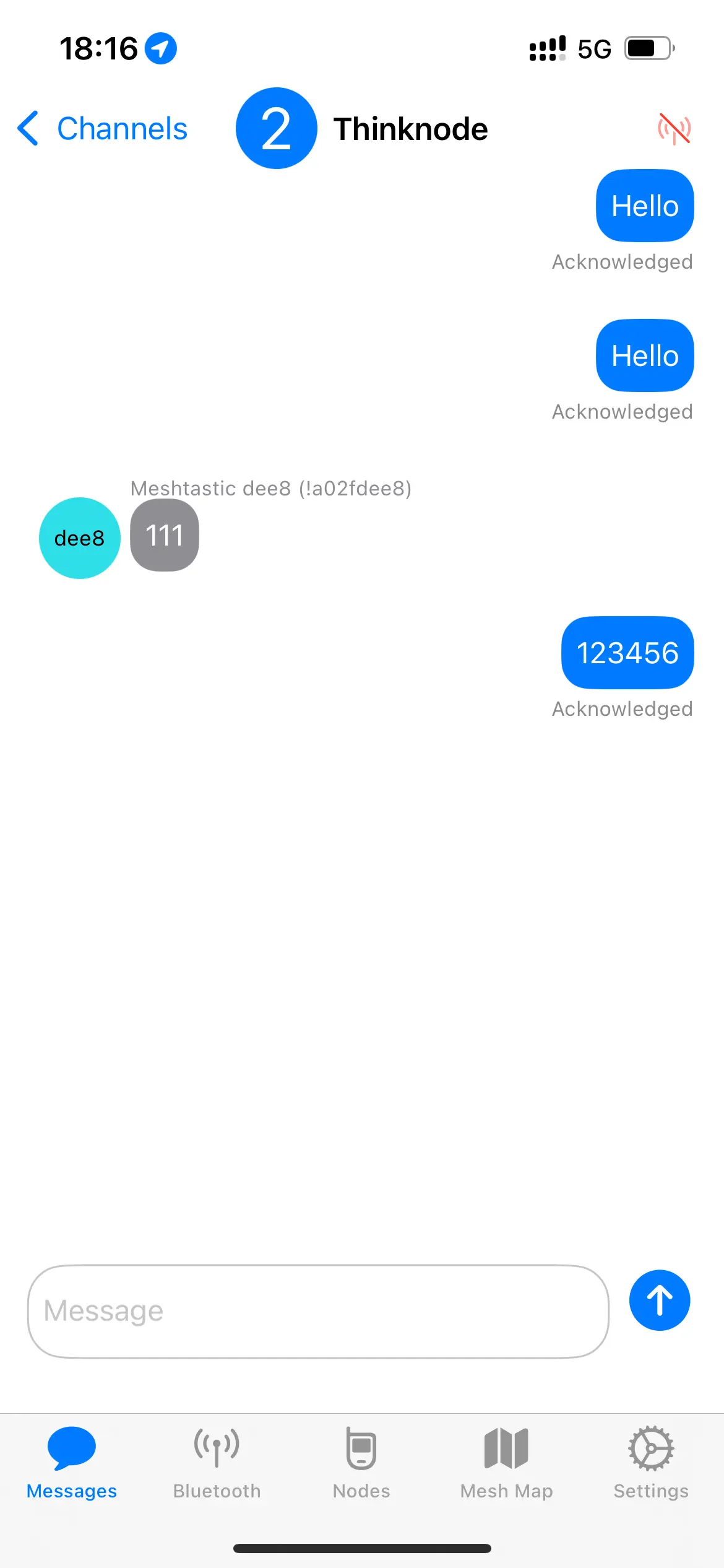

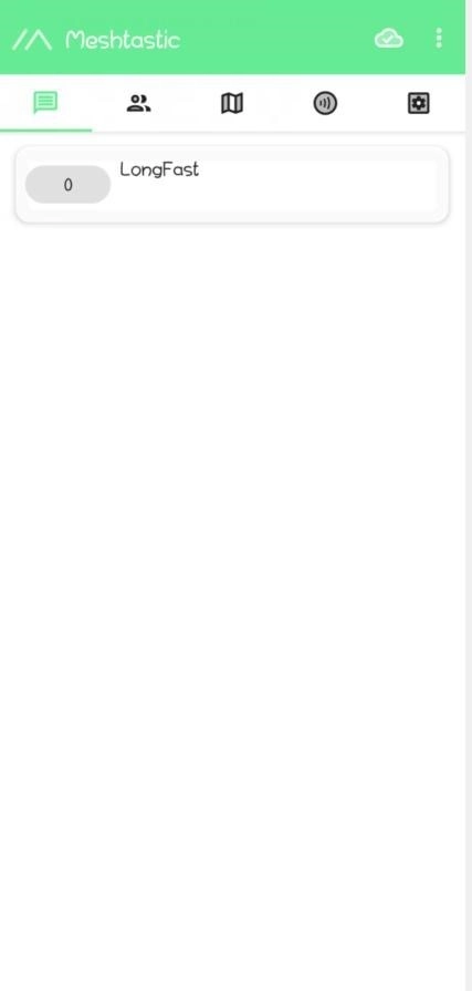

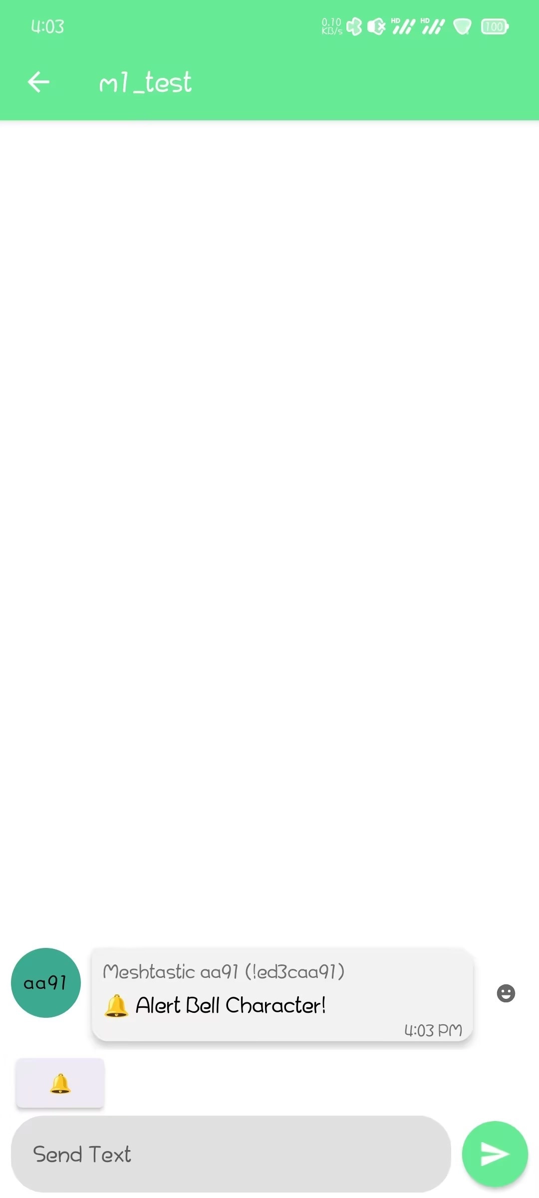

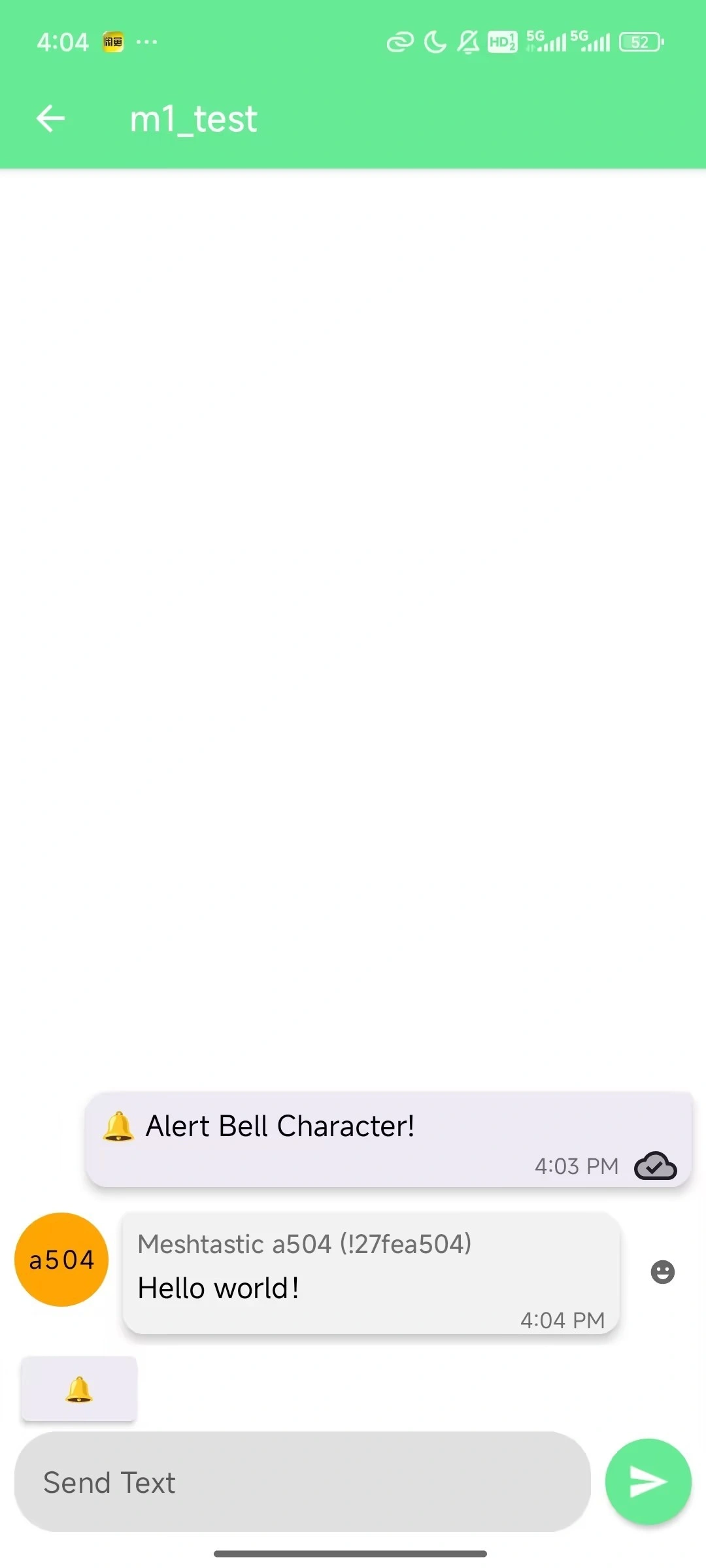

6)After joining, the two devices can now chat in the first screen by selecting Group Chat.
ThinkNode-M2-8
Mutual Messaging Interface.
A-end:
ThinkNode-A-end-5
B-end:
ThinkNode-B-end

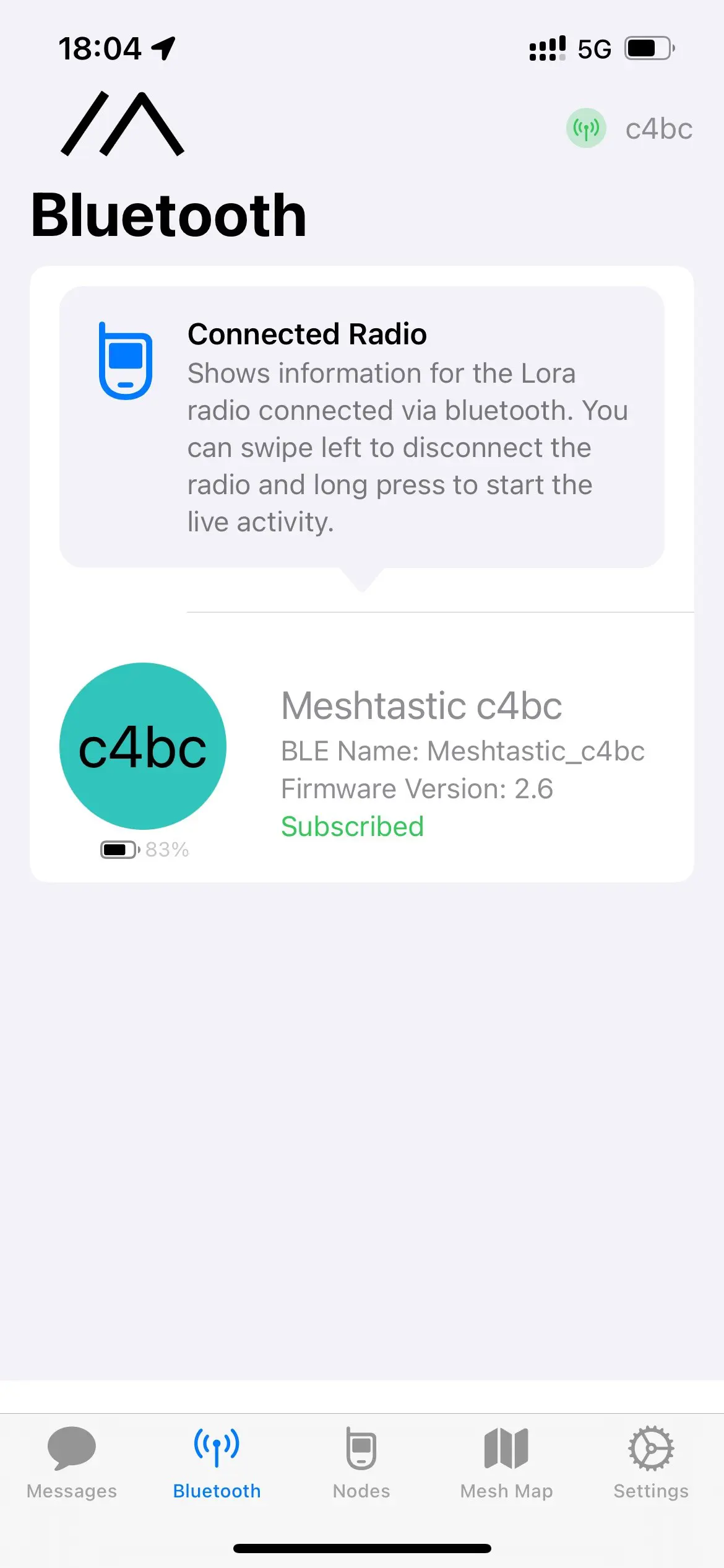

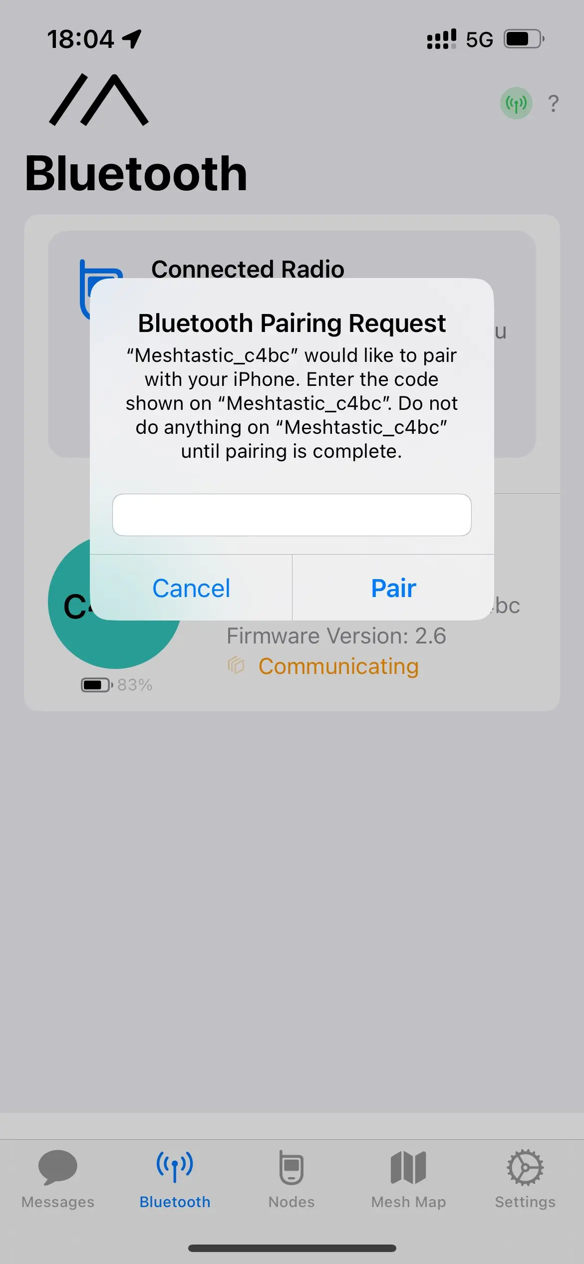

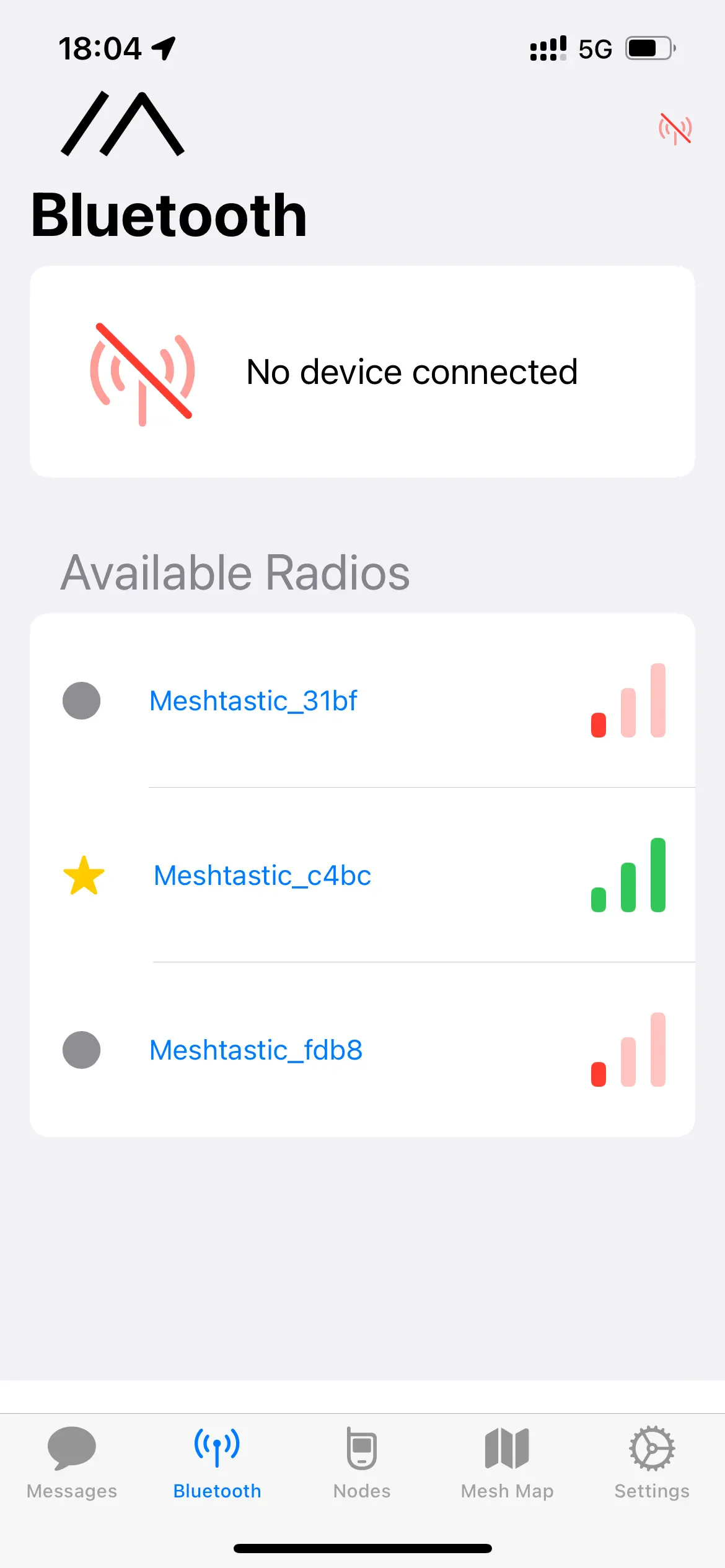

1)Open the app, tap Bluetooth on the home page and see the device you want to connect. Click on Pairing.
ios-1
ios-1
Snipaste_2025-06-19_19-05-44
ios-3

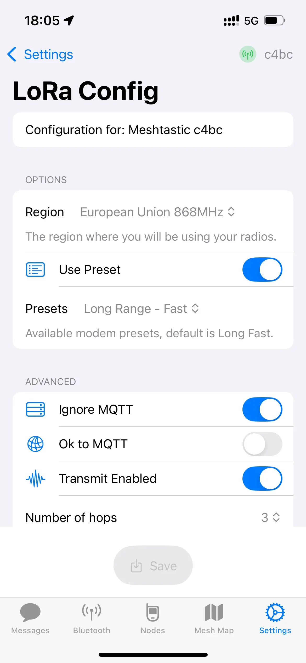

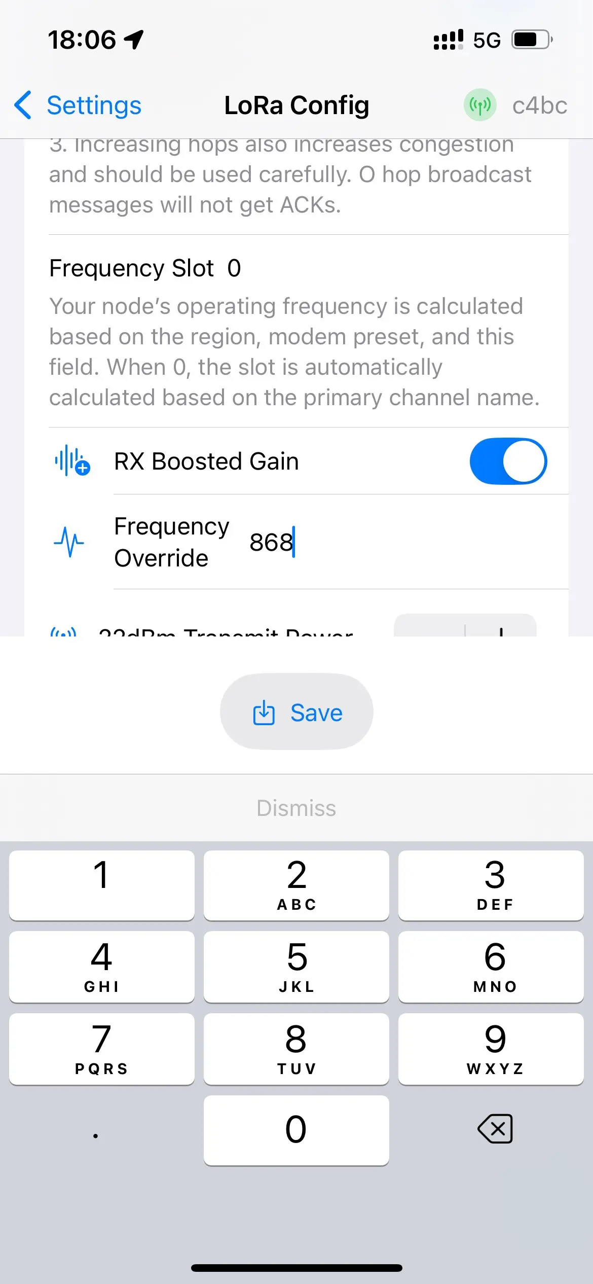

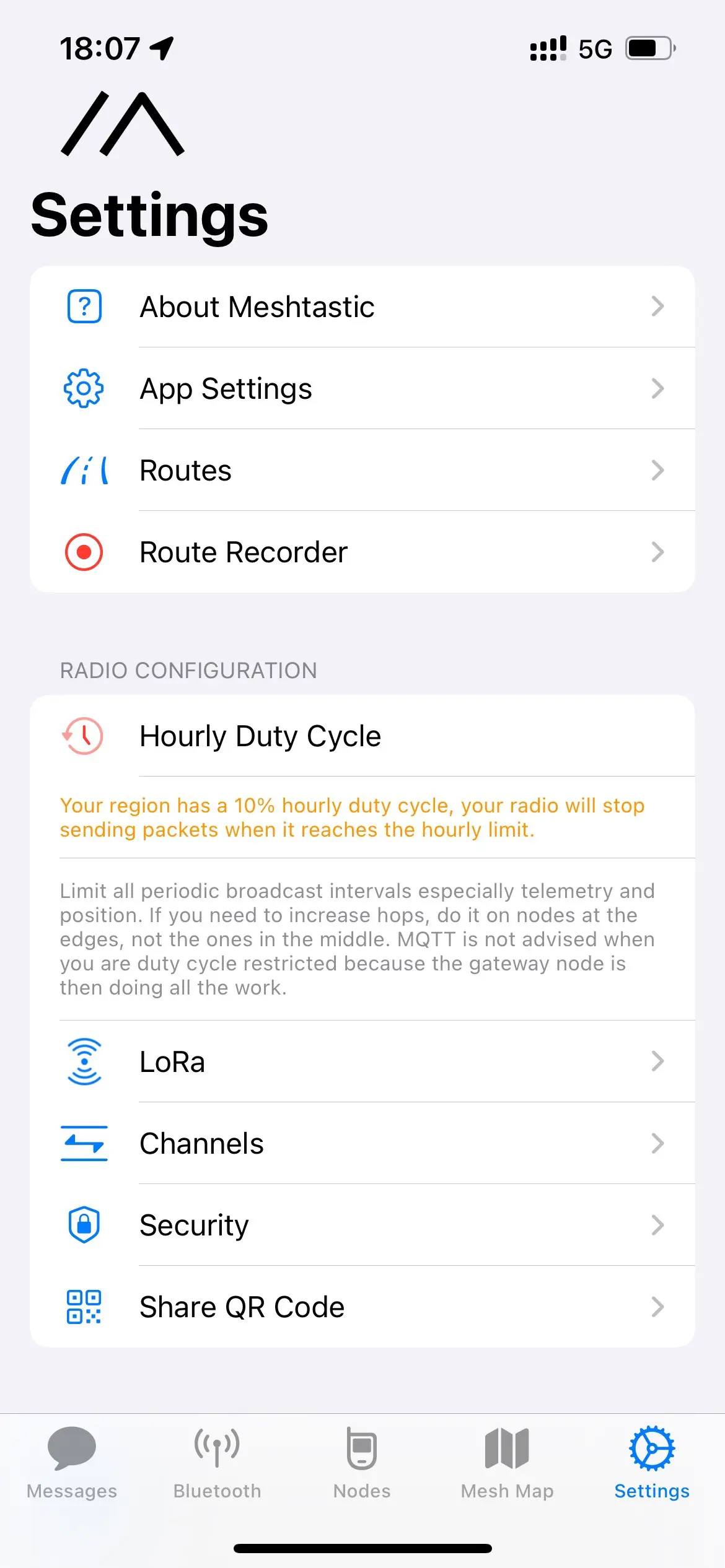

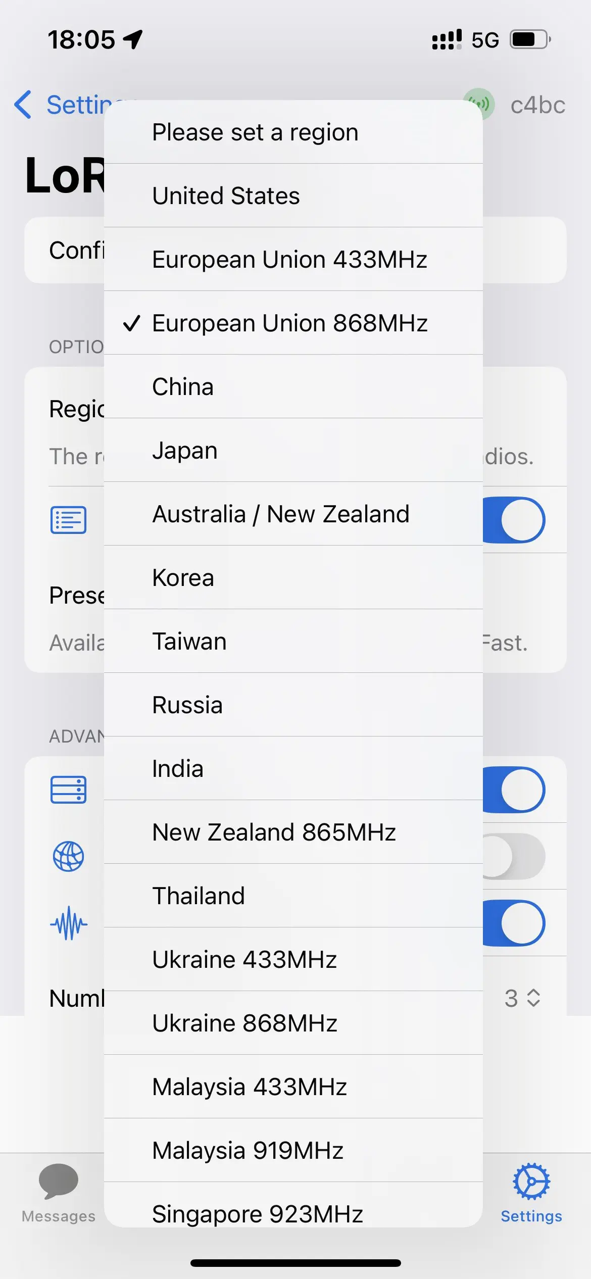

3)After successful Bluetooth pairing, You need to go to Settings and click on Lora Settings.ios-1

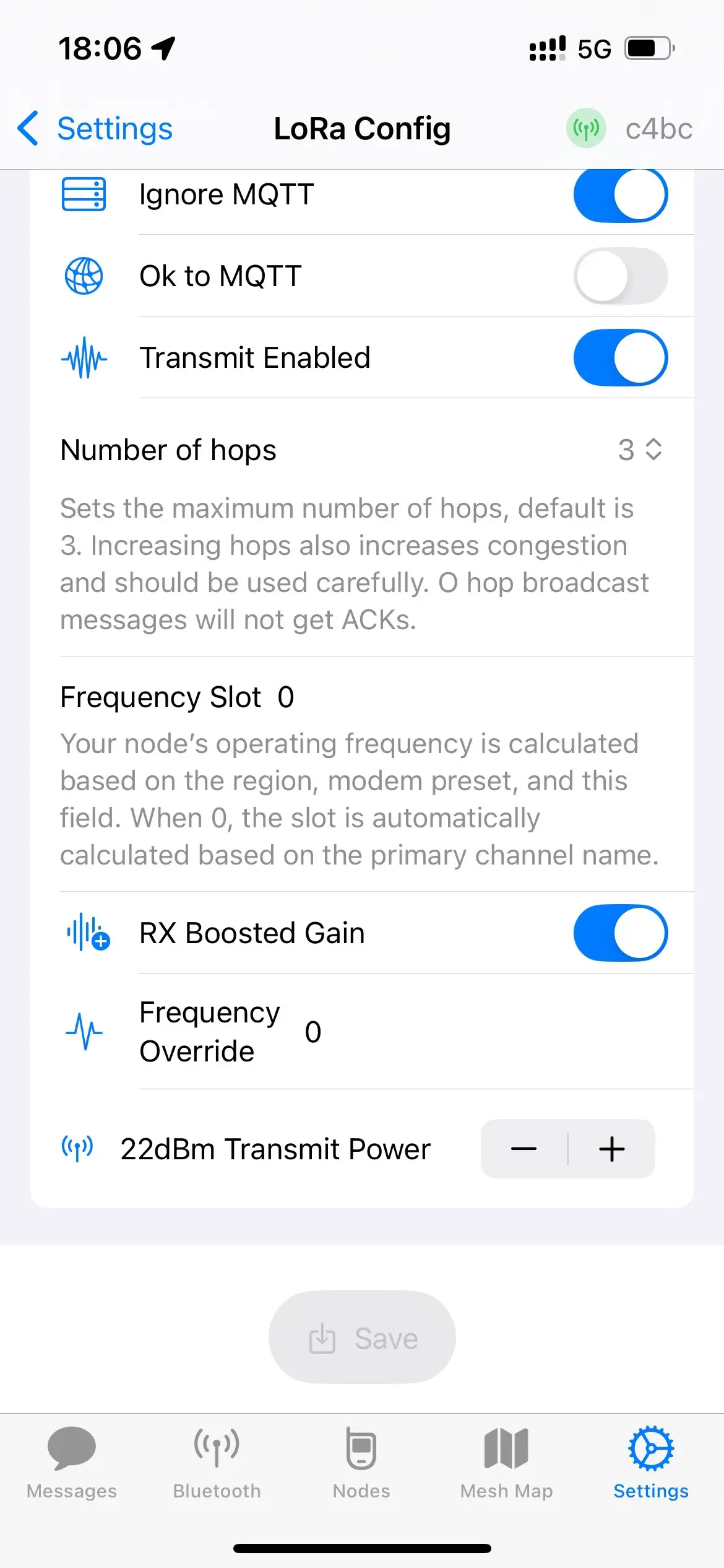

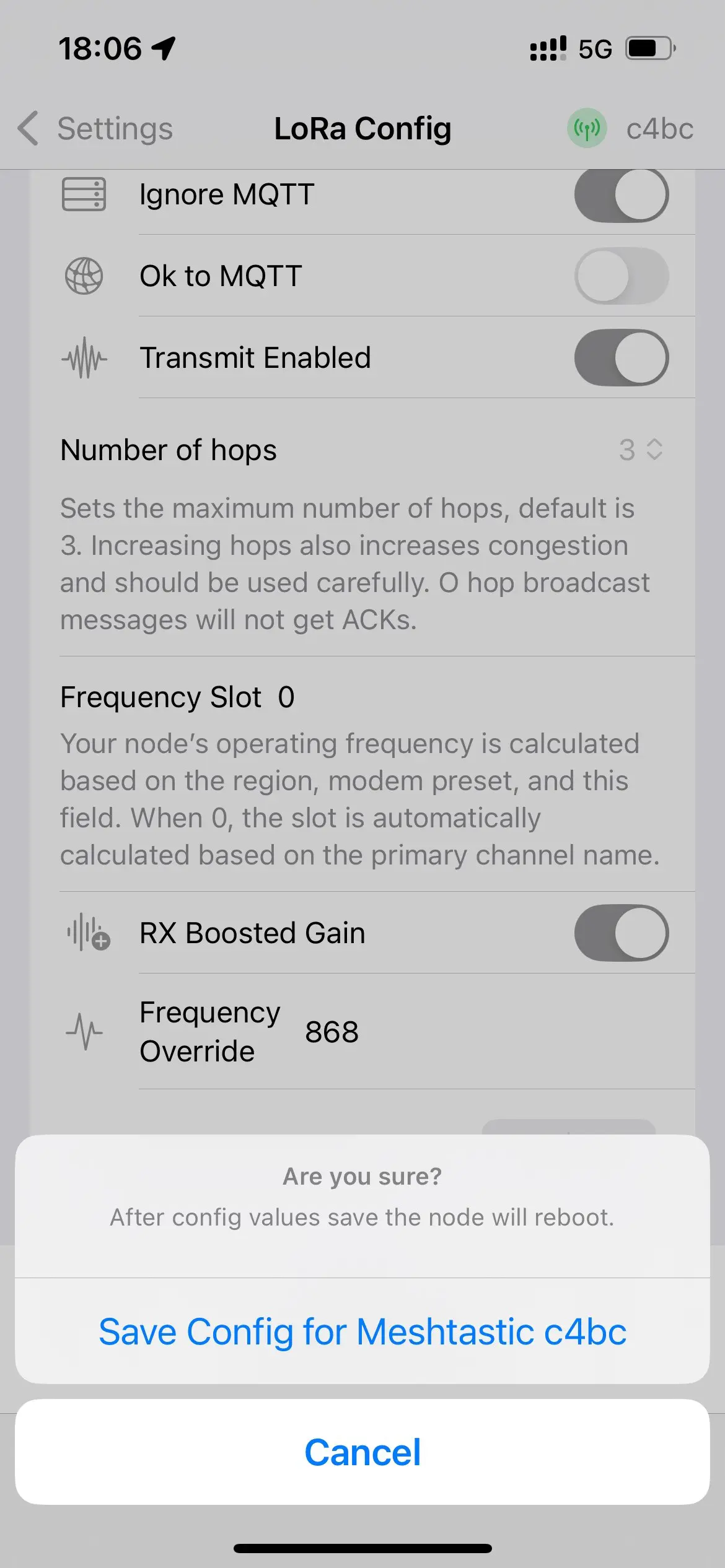

4) Set lora Region. and then scroll down to set the frequency. consistent with the previous settings for the region. Finally, check ignore MQTT and save.
ios-1

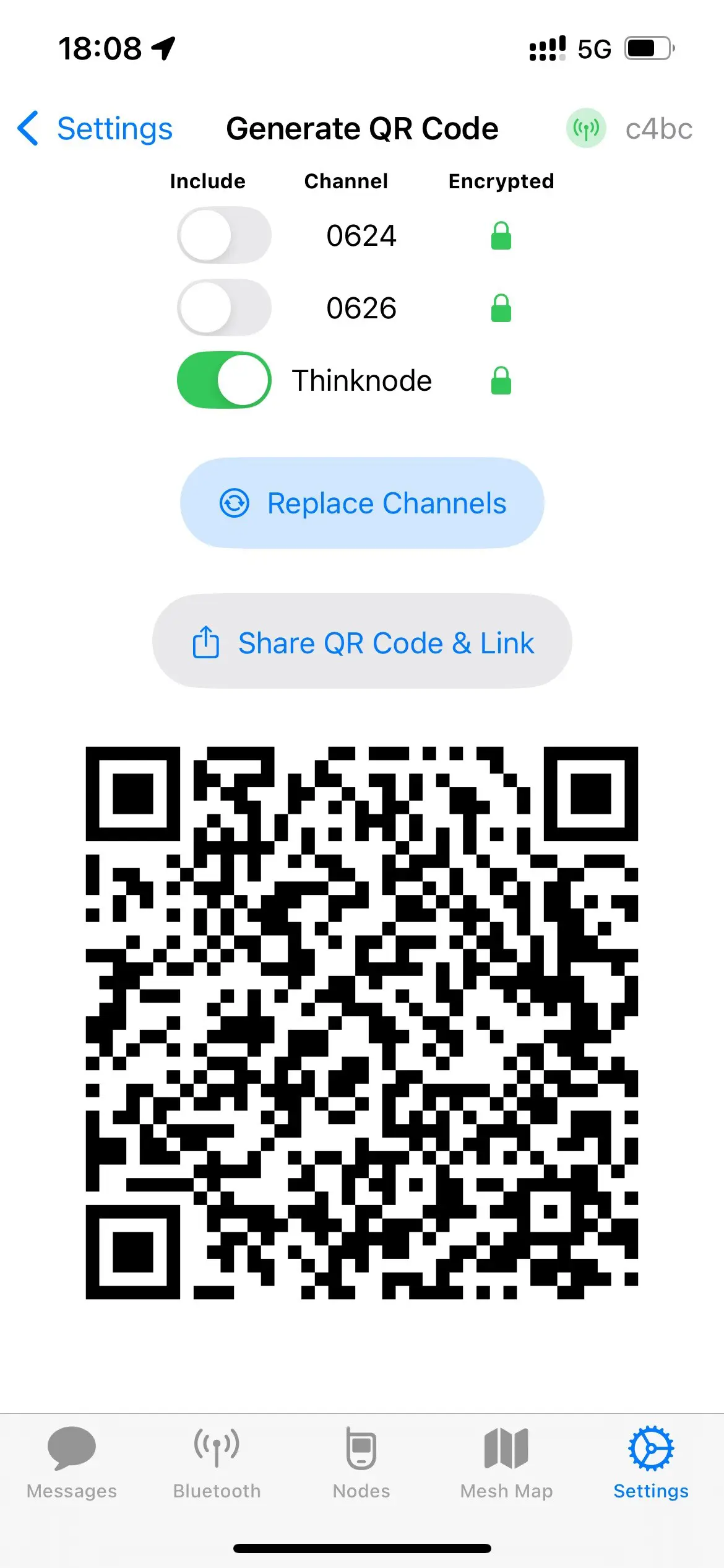

5)Go to the information page, select a channel and a QR code will appear, use another device to scan this QR code to enter.
ios-1
ios-1

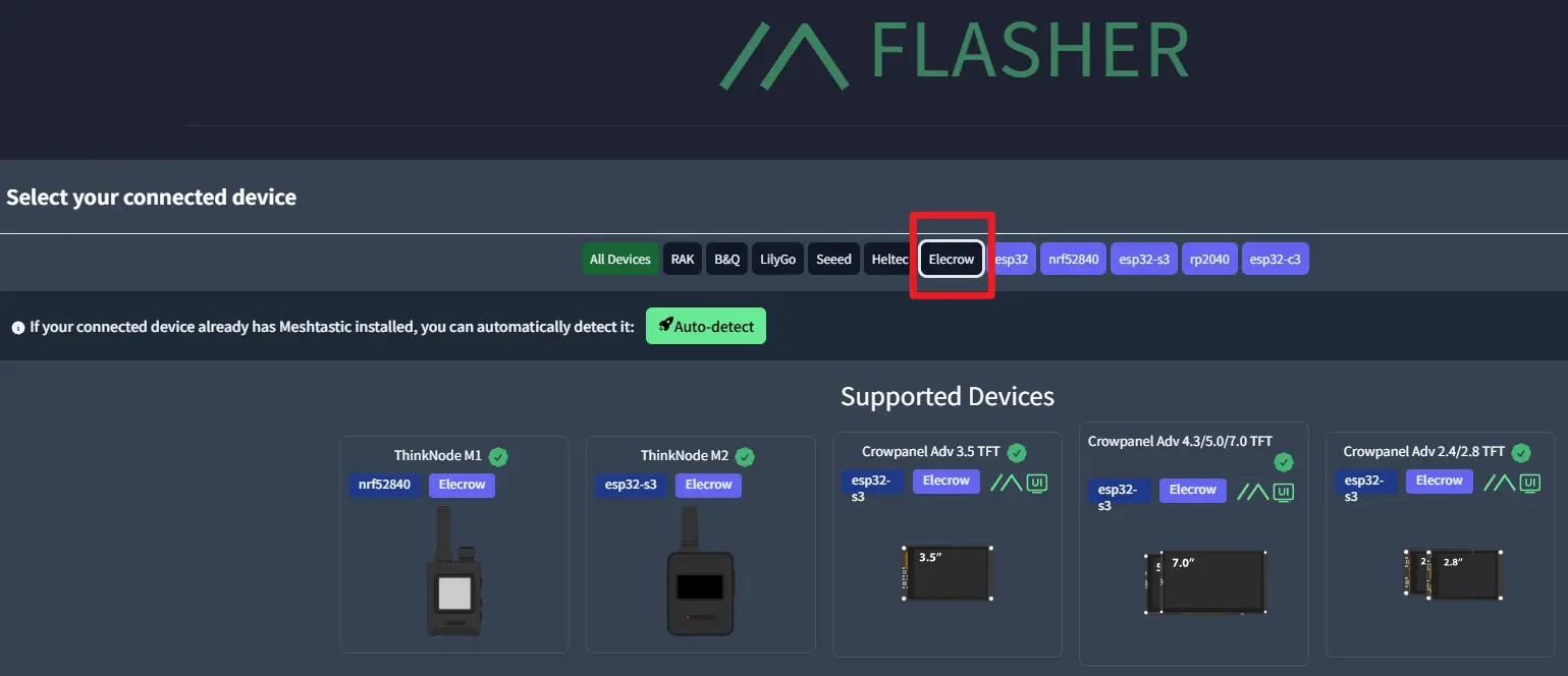

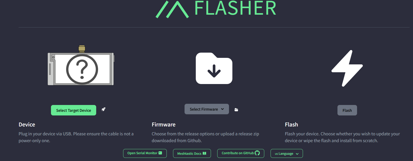

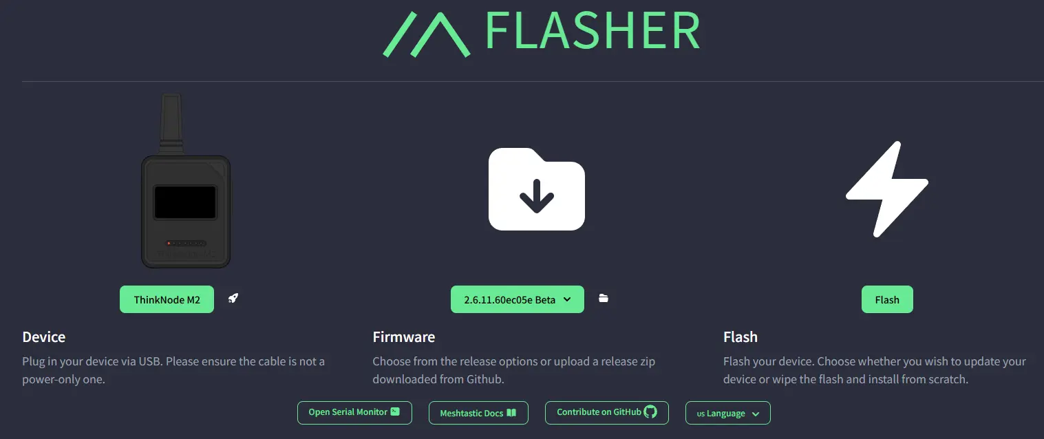

Burning Firmware
ClickMeshtastic firmware
firmware0
1,Select the corresponding firmware.
firmware1
2, follow the steps to download the firmware.
firmware2
