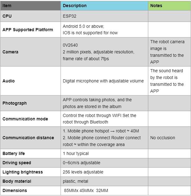

This video tank robot vehicle uses ESP32 as the main board, with OV2640 camera, and can control the movement via WiFi. It has a digital microphone interface, which can adjust the volume. The APP can control the shooting, and transmit video recordings to the APP in real-time. It has two lights at the same time, and the dark environment can be unobstructed. Support secondary development, app running environment supports Android 5.0 or above, but does not support IOS system.
Model: ACC35076R
Feature¶
- Simple connection, say goodbye to complicated cable connection
- Control the smart car via WiFi
- Real-time transmission of photos and videos

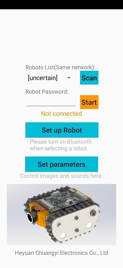

Step 2: Turn on the Bluetooth on your phone. Open the ReconnaissanceRobot APP, click Set Up Robot,

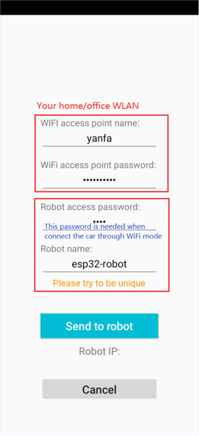

Step 3: Find "esp32-robot" device and click it to enter settings page. Enter your home/office WiFi name and password, set the name and WiFi for your robot car. Then click Send to robot to send these data to smart car. The smart car will connect to your WLAN.

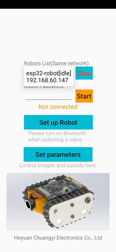

Step 1: Return to home page of APP, click Scan to find your smart car and select it. Here my car's name is esp32-robot.
Step 2: Enter the robot access password(the one you set at BT mode). I use the default password "1234". Then click Start to connect. Wait for a second... If there's no respond, please try to click the Start button again.
