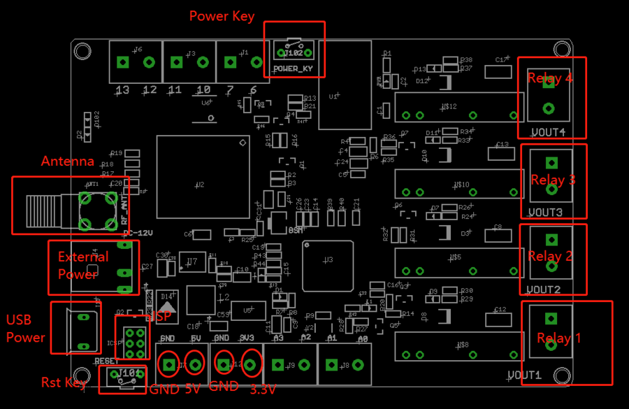

Interface Function¶
Net Status - tell the status about SIM808 linking to the net
Antenna - connected to external antenna
External Power - Vin connected to external 5~9VDC power supply
USB Power - connected to computer and power supply
ISP - Burn bootloader
Rst Key - Restart system
Power key - power up and down for SIM808 Power Status - tell whether sys power
Work Status - tell whether the power of SIM808 is on
Relay1-4 - relay channel,normall off
