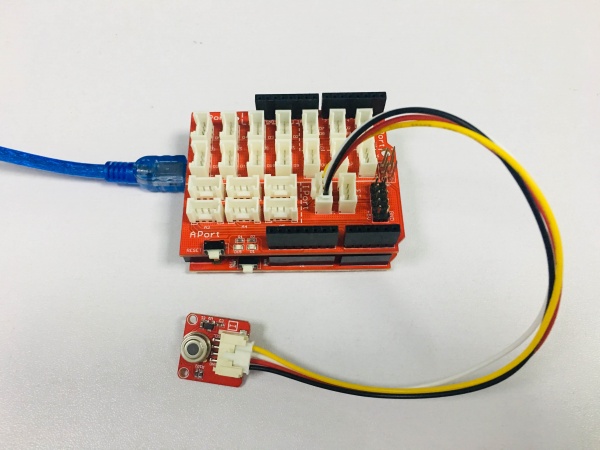

This demo is going to show you how to read temperature information from this Crowtail- Infrared Temperature Sensor.
1.Hardware Connection The Infrared Temperature Sensor is connecting to IIC interface of Crowtail - Base Shield.
2.Download I2Cmaster library for Arduino boards with 16MHz XTAL; Unzip and put it in the libraries file of Arduino IDE by the path: ..\arduino-1.0\libraries;
3.Open “MLX90614” example via the path: File -->Examples -->I2Cmaster --> MLX90614.

4.Upload it into your Arduino board and open the serial monitor to observe the temperature information of the environment.
