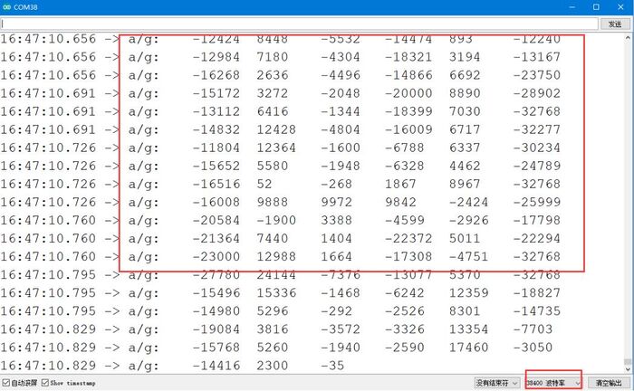

STEP6 After the program is downloaded, open the Serial port monitor of Arduino IDE, set baud rate to 38400, turn the sensor, and the printed value will change, as shown in the figure
