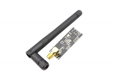

NRF24L01+PA+LNA Wireless Module
Description¶
NRF24L01P + PA + LNA wireless module operates in Free license 2.4G ISM band, you can do point to point application and can also be composed of star network. The Data transmission chip NRF24L01+, and match with the department's professional design, Add the the chip of power PA and LNA, RF switch, band pass filter composed of a professional full two-way RF power amplifier, making the effective communication distance has been greatly expanded. Small size: 45.54mm x 16.46mm, easy to embed in any space-constrained products, customers can use the SPI port of Arduino or any other MCU to control NRF24L01P + PA + LNA, Wireless module to complete long distance wireless data transmission system desige.
Model:WRW24015R
Features¶
- It uses 2.4G global open ISM band, with license free.
- Transmit power is greater than +20 dbm.Support six-channel data reception. 2Mbit/s speed makes high-quality VoIP possible Low
- operating voltage: 2.7 to 3.6V
- Multi-frequency points: 125 frequency points meet the needs of multi-point communications and frequency hopping.
- Low cost: integrated with high-speed signal processing parts associated with RF protocol, such as: automatically re-send lost packets and generate acknowledge signal; SPI interface facilitates the communication with MCU I/O port.
- Facilitate the development for customers, without development RF part.
- Software programming is fully compatible with NRF24L01 modules.Size: 37.4mm * 16.6mm
- Applications: remote control, telemetry, wireless meter reading, access control systems, residential paging, industrial data acquisition systems, wireless tags, identification, contactless RF smart card, small wireless data terminal, fire
- safety systems, wireless remote control systems, bio-signal acquisition, wireless 232, wireless 422/485 data communications.
