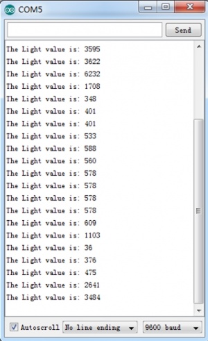

Open the Sscom32 terminal or the Serial moniter , and set the baudrate to 57600, you will see the output changing with light density.
