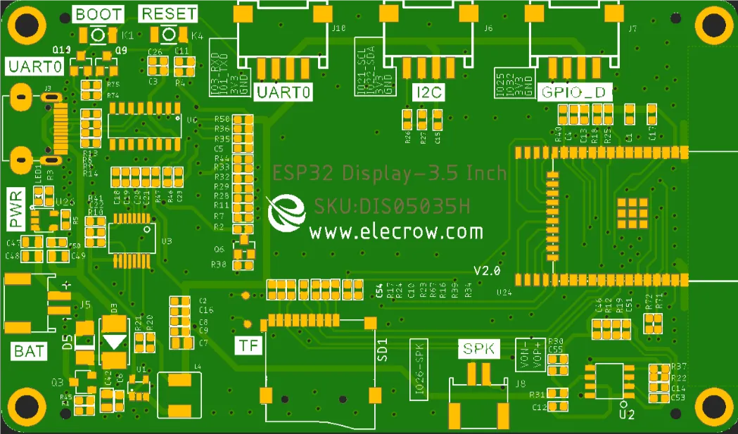

Pin Out¶
| Pin Name | Description | Connector Type |
| SPK | Output audio signal,connected with speakers. The motherboard comes with a power amplifier chip circuit. | PH2.0-2P |
| PWR | Power LED. | |
| RST | Reset button. Push it to reset the system. | |
| BOOT | ||
| GPIO_D | Digital and artificial I/O interface. | HY2.0-4P |
| I2C | Build the communication among micro controller and peripheral devices. | HY2.0-4P |
| TF | Provide off-line save and extra storage space. | |
| BAT | Connect with the lithium battery. (With the battery charging circuit) | PH2.0-2P |
| UART0 | Provide serial communication, supply voltage(transform USB to UART0) and serial information printing. | HY2.0-4P/USB-C |
| 3.5-inch HMI Port** | Pin Number |
| GPIO_D | IO25; IO32 |
| UART | RX(IO3); TX(IO1) |
| I2C | SDA(IO22); SCL(IO21) |
| SPK | IO26 |
| SD Card Slot(SPI) | MOSI(IO23); MISO(IO19); CLK(IO18); CS(IO5) |

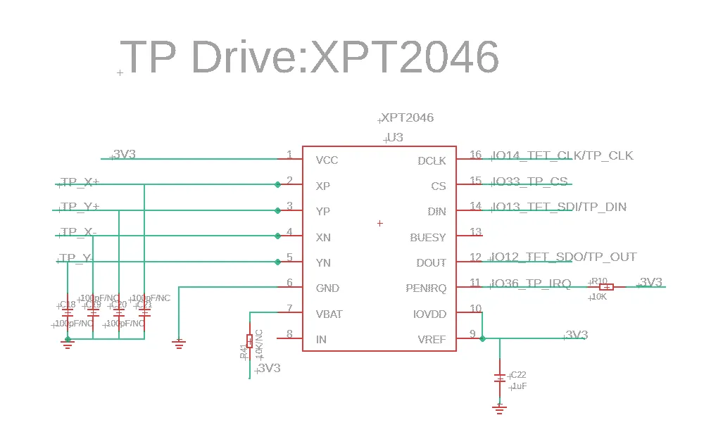

Schematic Diagram¶
ESP32-WROOM-32 and TFT display wiring pins
Schematic Diagram:
ESP32-WROOM-32 and touch driver wiring
Schematic Diagram:
