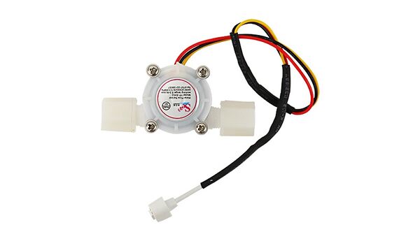

Water flow sensor consists of magnetic core, rotating impeller, external casing and sensor and a hall-effect sensor. When water flows through the rotor, rotor rolls, it activates the magnetic core to trigger switch action speed changes with different rate of flow. The hall-effect sensor outputs the corresponding pulse signals, users can get the flow speed via detecting the pulse. It is suitable to detect flow in water dispenser or coffee machine
