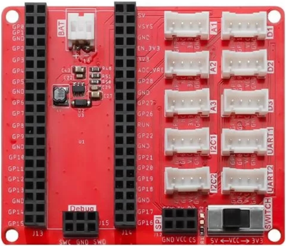

Crowtail Shield for Pi Pico is a plug-and-play expansion board for Raspberry Pi Pico, integrating various Crowtail connectors, including 2*I2C, 3*Analog, 2*UART, 3*Digital ports, 1*BAT, SWD debug interface and SPI pin, 3.3v/5v selectable power switch. The shield board is a stackable add-on board. You can directly use the Pre-Soldered Pico and plug it into the shield board, connect the Crowtail series sensors, and start developing your new project. Learn more about the Crowtail series, click here. Get the Pico board together, click here.

- Analog Port: Include 3 analogs ports, A1, A2, A3
- Digital Port: Include 3 digital ports, D1, D2, D3
- UART Port: Include 2 UART port
- I2C Port: Include 2 I2C ports
- SPI Port: Provide one SPI port
- BAT Port: Provide one BAT port
- Power Switch: Provide 5V/3.3V selectable power switch
- Platform support: MicroPython & Arduino
- Operating Temperature: -25℃ to +85℃
- Operating voltage: Input power ⅗ V
- Dimension: 65mm * 56mm
- Weight: 26g
