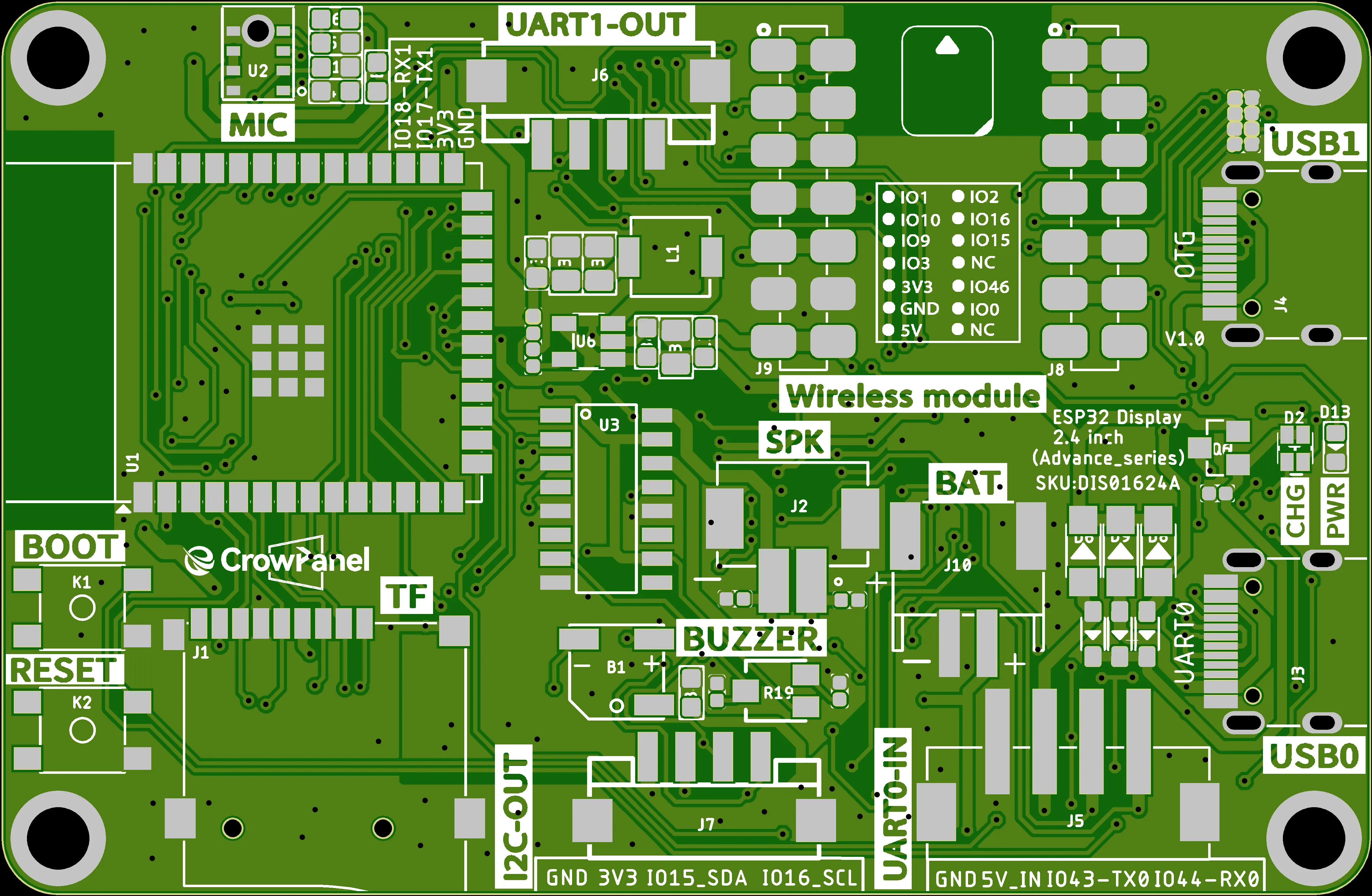

Pin Output:¶
Functional description of the product's internal interfaces:¶
| Pin Name | Description | Connector Type |
| SPK | Output audio signals to connect to speakers. The main board comes with a power amplifier chip circuit. | PH2.0-2P |
| PWR | Power LED. | |
| RST | Reset button. Press it to reset the system. | |
| boot | ||
| UART1-OUT | Builds communication between Logic modules, including the serial communication module and the print module. | HY2.0-4P |
| UART0-IN | Input power supply and serial communication functionality | XH2.54-4P |
| I2C-OUT | Establish communication between the microcontroller and peripheral devices. | HY2.0-4P |
| BAT | Connect the lithium battery. (with battery charging circuit)(Input voltage: 3.7–4.2 V) | PH2.0-2P |

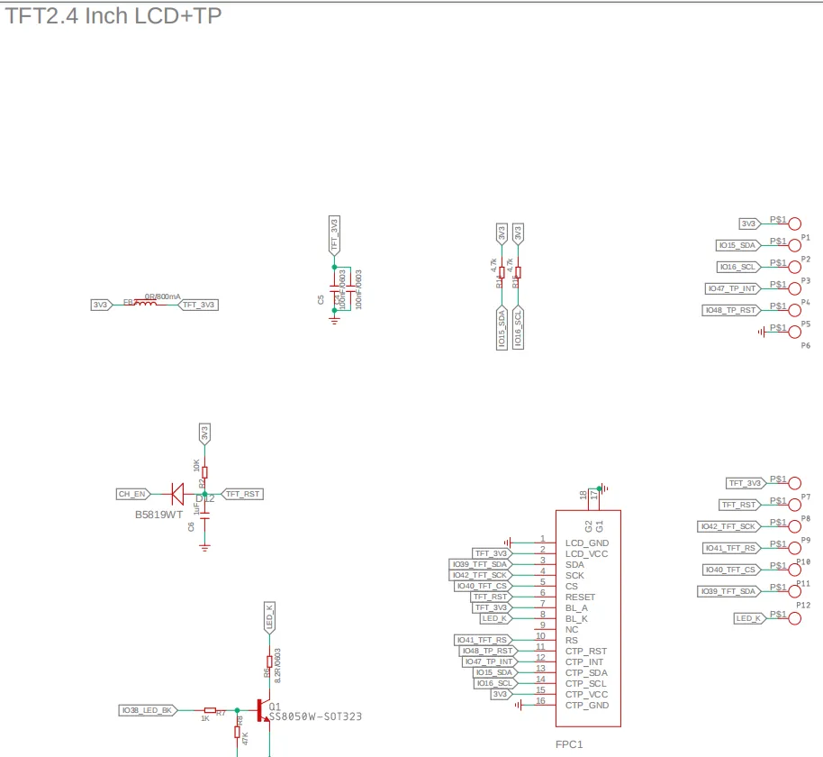

ESP32-S3 and ISP Display Wiring Pins:¶

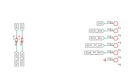

ESP32-S3 and Touch Driver Wiring:¶
i2c address: 0x38.

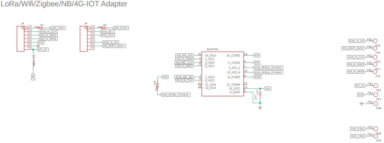

ESP32-S3 and wireless module wiring pins:¶
Switching Function Keys:¶
| IO45 level | effective function |
| 1 | MIC |
| 0 | WM(wireless module) |
Wireless module pins:¶
| IO1 | IO2 |
| IO10 | IO16 |
| IO9 | IO15 |
| IO3 | NC |
| 3V3 | IO46 |
| GND | IO0 |
| 5V | NC |
