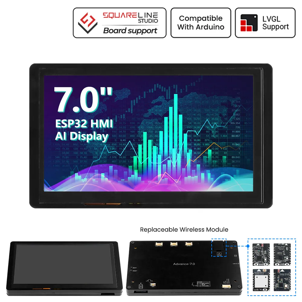

CrowPanel Advance 7.0-HMI ESP32 AI Display¶
Description¶
The ESP32 Display-7.0 inch (Advance_Series) display module is a powerful HMI touchscreen with an 800*480 resolution IPS display. It utilizes the ESP32-S3-WROOM-1-N16R8 module as the main control processor, with a built-in dual-core 32-bit LX7 microprocessor up to 240MHz, 512KB SRAM, 8M PSRAM, and extended 16M Flash to ensure powerful data processing. The integrated 2.4GHz Wi-Fi and Bluetooth 5 (LE) functions, together with the module's own RF antenna, provide users with a stable and reliable wireless connection. In addition, a wide range of peripheral interfaces and excellent low-power performance make this series of products ideal for HMI application scenarios with stringent requirements for wireless connectivity.
A distinctive feature of the Advance version is its advanced AI functionality. Utilizing the microphone and speaker equipped on the motherboard, users can achieve voice command interaction, voice recognition, voice synthesis, and deep communication with intelligent assistants to easily access the information they need. Diversified wireless communication options are also provided through a modular design that allows users to change different modules as needed, supporting a variety of communication protocols including Zigbee, LoRa, NF2401, Matter, Thread, and Wi-Fi 6.
The module includes a 7.0-inch IPS display and driver board. The display utilizes capacitive touch technology and is equipped with a resistive stylus for more flexible use. In addition, the motherboard has a TF card slot, multiple peripheral ports, USB ports, speaker ports, battery ports, and wireless extensions, providing more expansion possibilities.
It supports development environments such as Arduino IDE, Espressif IDF and Micro Python, and is compatible with the LVGL graphics library and supports openHASP, which helps developers to easily customize the UI interface, quickly develop interesting projects, and significantly shorten the development cycle.
ESP32 Display-7.0-inch display module is suitable for many scenarios, such as automotive HMI, medical equipment, industrial control, electric power, civil electronics, automation, GPS, new energy and IoT applications. Its rich interfaces and expansion functions can meet the needs of different industries and provide users with more comprehensive solutions.
Model DIS02170A

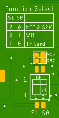

Switching Function Keys¶
| S1 | S0 | effective function |
| 0 | 0 | MIC&SPK |
| 0 | 1 | WM(wireless module) |
| 1 | 0 | TF Card |

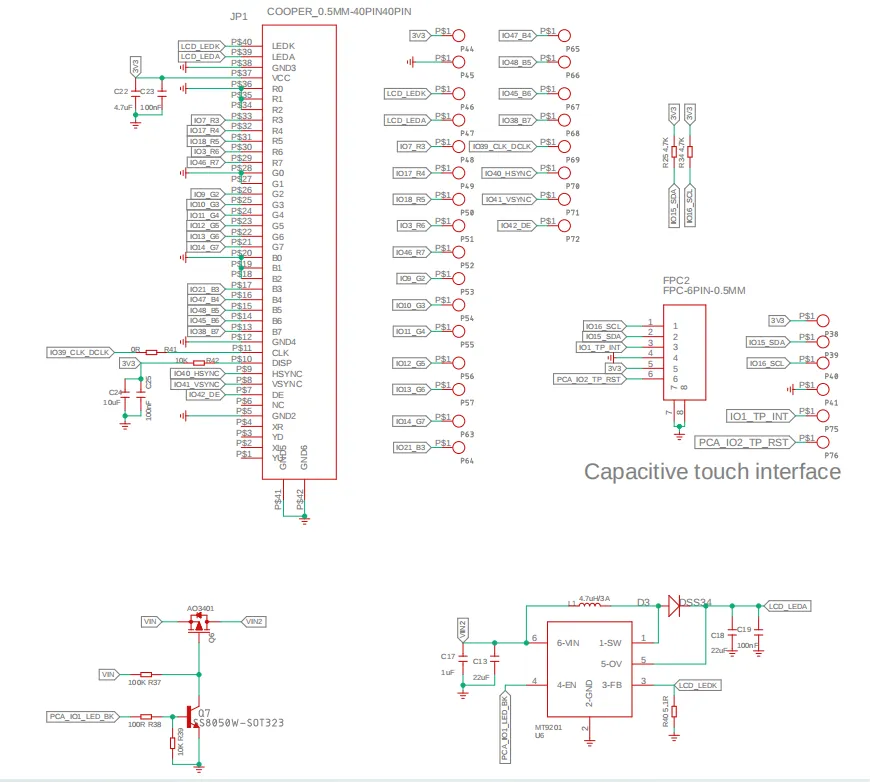

Schematic:¶
ESP32-S3 and ISP Display Wiring Pins:¶

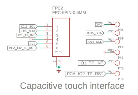

ESP32-S3 and Touch Driver Wiring:¶
i2c address: 0x5D.

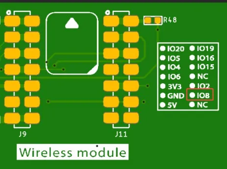

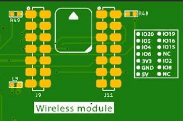

ESP32-S3 and wireless module wiring pins:¶

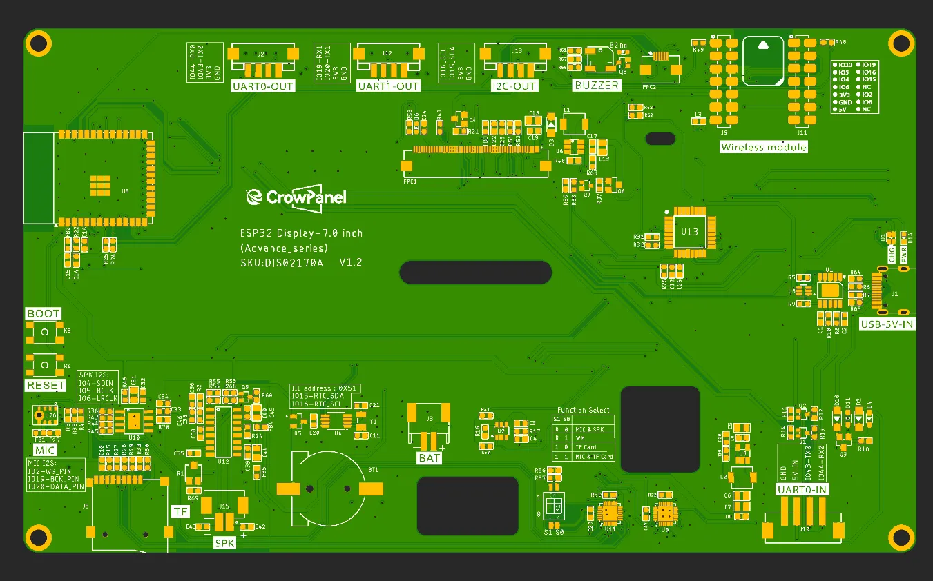

Version 1.2¶
Pin Output:¶
| 7.0-inch HMI port | pin number | Electrical Characteristics |
| UART0-OUT | RX(IO44); TX(IO43) RX; | Output voltage: 3.3V Output current: 1A max. Use: Power supply output and communication. |
| UART1-OUT | RX(IO19); TX(IO20) RX; | Output voltage: 3.3V Output current: 1A max. Use: Power supply output and communication. |
| UART0-IN | RX(IO44); TX(IO43) RX; | Input voltage: 5V ± 5%. 5.5V max. Input current: 2A max. Purpose: Power supply input and communication. |
| I2C | SDA(IO15); SCL(IO16) ; | Output voltage: 3.3V Output current: 1A max. Use: Power supply output and communication. |
| SPK | I2S_LRCLK(IO6);I2S_BCLK(IO5);I2S_SDIN(IO4); | Maximum output current: 20mA Signal type: 3.3V logic level, digital control signal |
| SD Card Slot | MOSI(IO6); MISO(IO4); CLK(IO5); CS(GND) | Maximum output current: 20mA Signal type: 3.3V logic level, digital control signal |
| LCD Backlight | P3.5(STC8H1K28) | Maximum output current: 20mA Signal type: 3.3V logic level, digital control signal |
| Backlight Adjustment | P1.1(STC8H1K28) | |
| I2S MIC | MIC_SD(IO20);MIC_WS(IO2);MIC_CLK(IO19) | Maximum output current: 20mA Signal type: 3.3V logic level, digital control signal |
| BUZZER | P2.7(STC8H1K28) | Maximum output current: 20mA Signal type: 3.3V logic level, digital control signal |
| TP_RST | P1.7(STC8H1K28) | |
| power amplifier MUTE | P3.7(STC8H1K28) | |
| power amplifier SHUT | P3.6(STC8H1K28) |

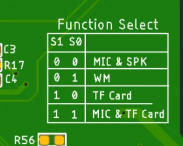

Switching Function Keys:¶
| 0 | 0 | MIC&SPK |
| 1 | 0 | TF Card |
| 1 | 1 | MIC&TF Card |

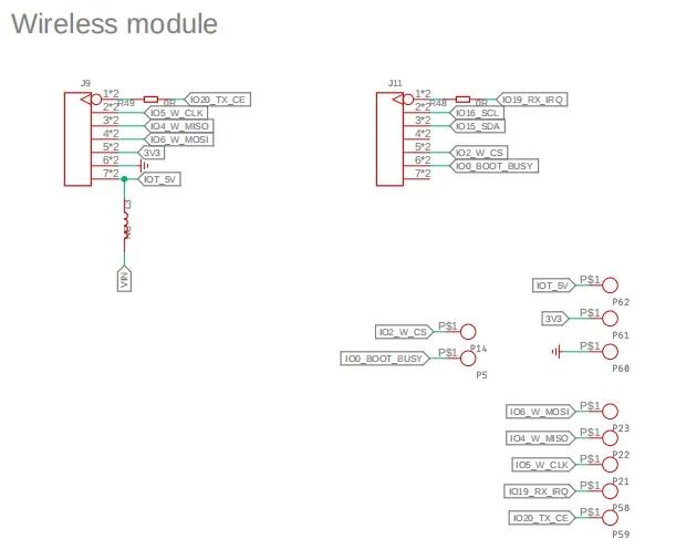

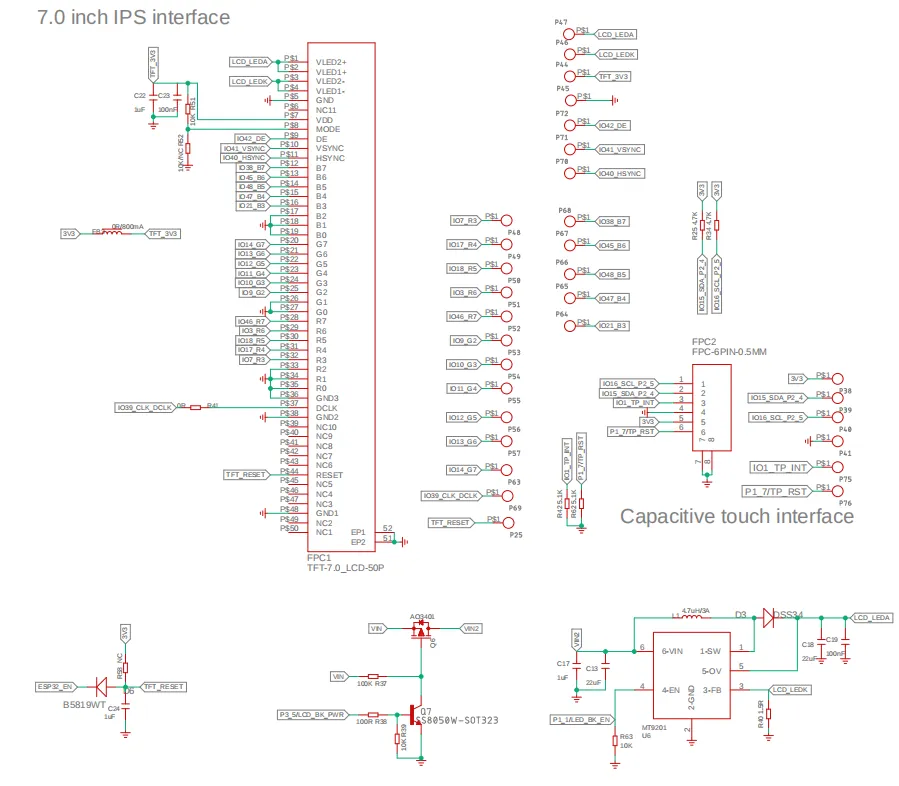

Schematic:¶

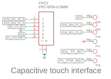

i2c address: 0x5D.

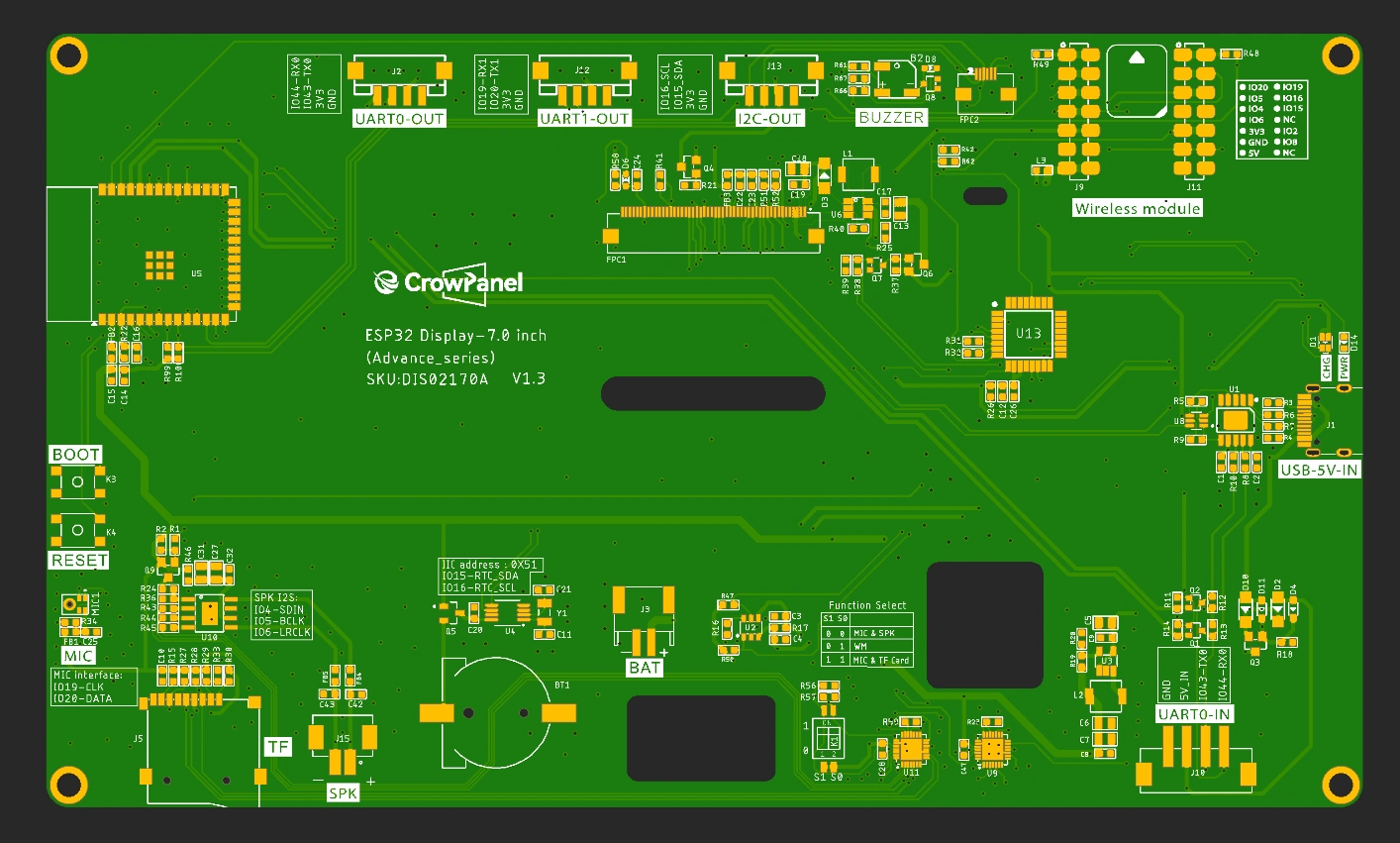

Version 1.3¶
| I2S MIC (LMD3526B261-OFA01) | MIC_SD(IO20);MIC_CLK(IO19) | Maximum output current: 20mA Signal type: 3.3V logic level, digital control signal |
