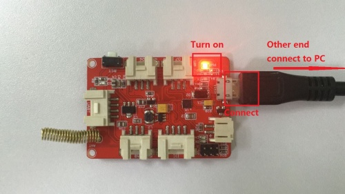

a.Connect USB and the other end connect to PC.When the board is working properly, PMR LED turn on,as follow picture:

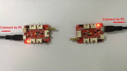

b.Connect any two pieces of board onto the computer by USB, the two antennas corresponding to each other, as shown in the following picture:

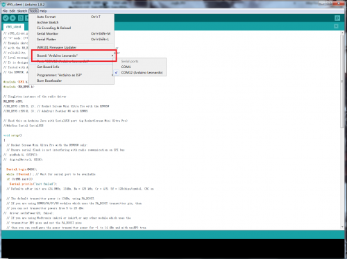

2.Download the file¶
1.Download the RadioHead library and put the RadioHead file under the Arduino IDE installation directory Library
3.Download¶
3.Copy the following code, one is the sending program, one for the receiving program, downloaded to two boards:

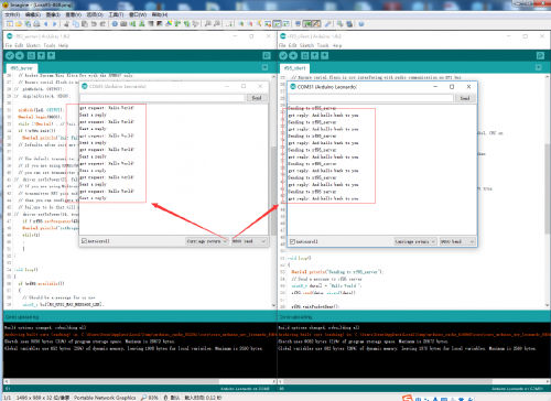

4.Observe¶
Open Arduino IDE serial monitor, and then observe the serial port debugging window display data, as shown in the following figure:
