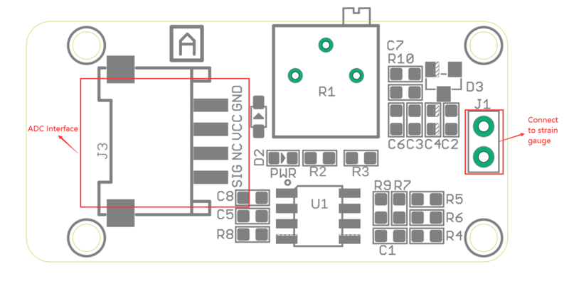

Interface¶

| Crowduino Uno | Crowtail- Strain Gauge Sensor |
| ANALOG 0 | SIG |
| 5V | VCC |
| GND | GND |
