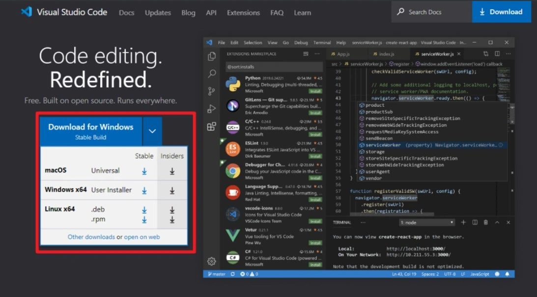

(1) First, download Visual Studio Code from https://code.visualstudio.com/. Select the version compatible with your computer's operating system and download it.
halow-idf-1

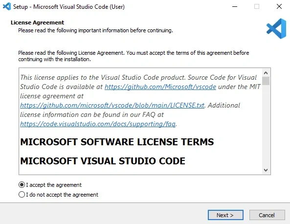

(2) Double-click to install Visual Studio Code software, and simply proceed with the default installation throughout.
P4-idf-2
P4-idf-3
P4-idf-4
P4-idf-5

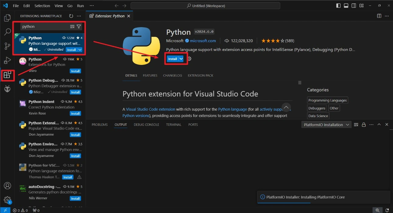

(3) Open Visual Studio Code, click on ‘Extensions’, search for Python, and install it.
P4-idf-6

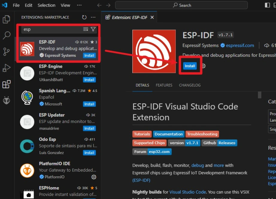

(4) Search for ESP-IDF and install it.
P4-idf-7

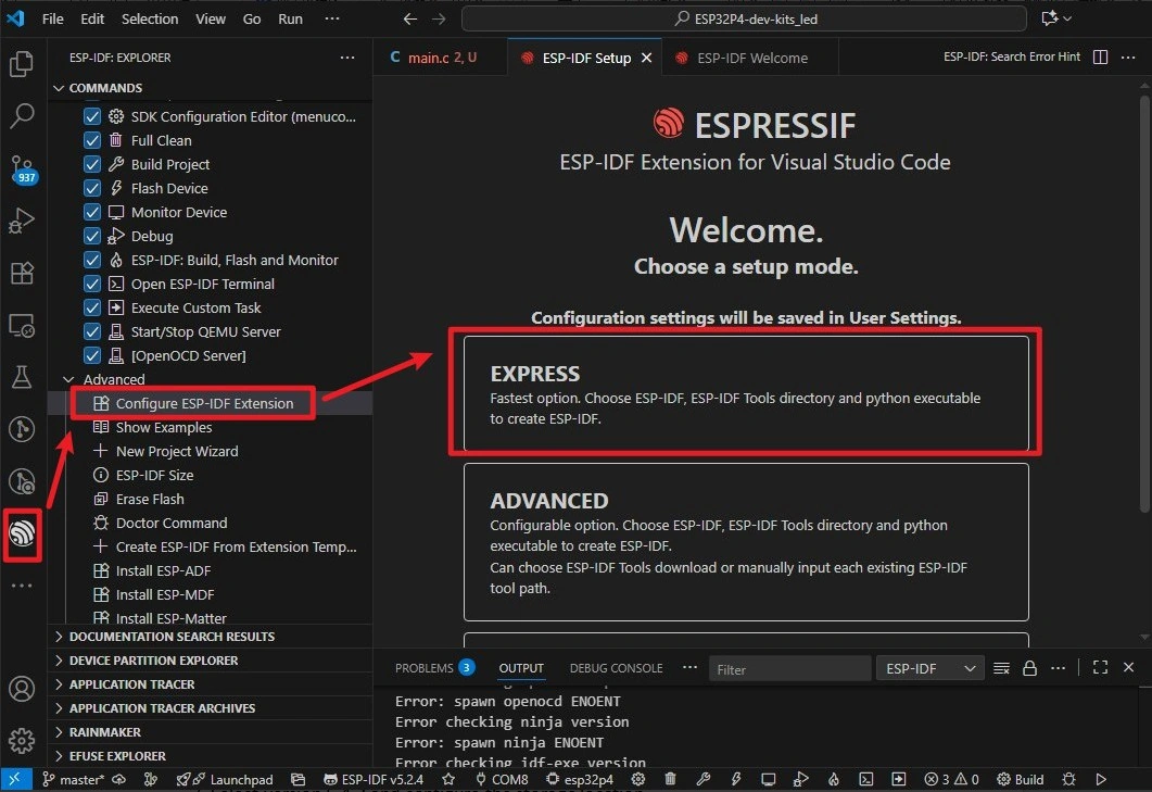

(5) Install the ESP-IDF tools.
P4-idf-8

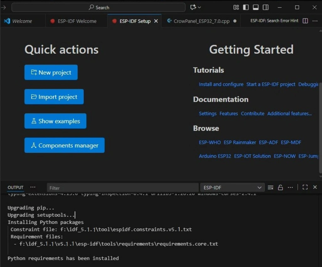

(8) Installation successful.
P4-idf-11
