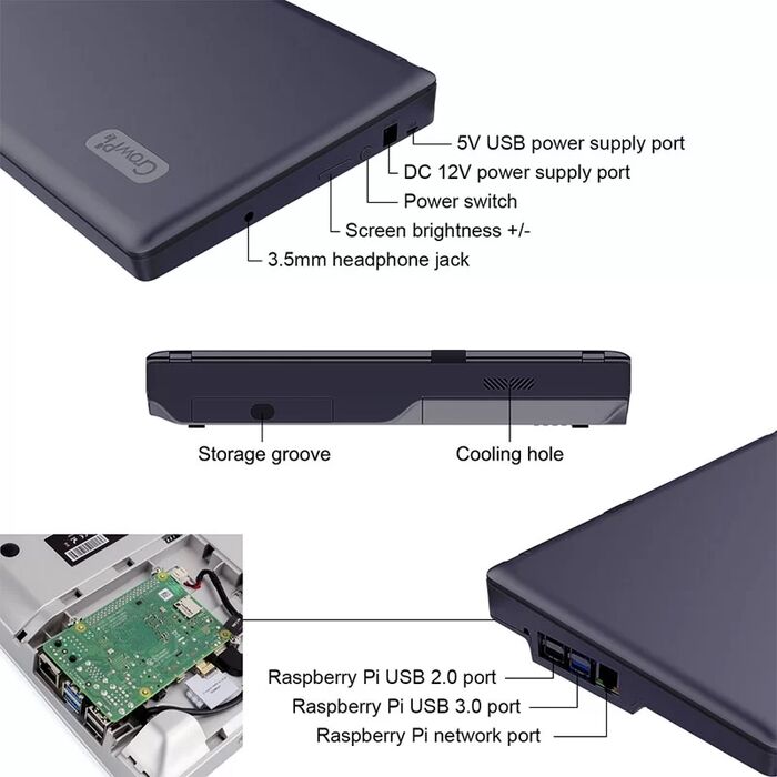

  • 11.6-inch 1920*1080 IPS screen
  • Sleek body made out of environmentally-friendly material, portable for on-the-go use
  • The wireless keyboard detaches from the body or stays connected via a magnet
  • Convert between playing and learning in second
  • Get started via the one-step installation of Raspberry Pi 4B
  • 2-MP camera, microphone, and stereo output built-in
  • Switch between projects using one button and get creative using Raspberry PI GPIO pins, all of which connect to the onboard sensors or function as independent outputs

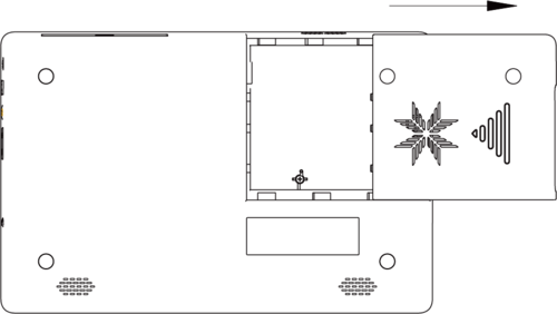

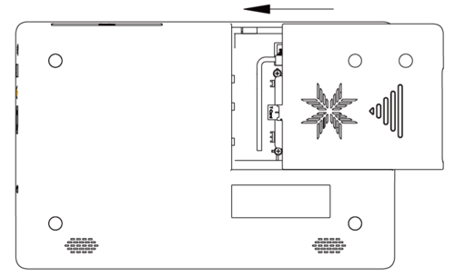

Step 2. Push to the right to open the back cover of the CrowPi 2 Raspberry Pi compartment.

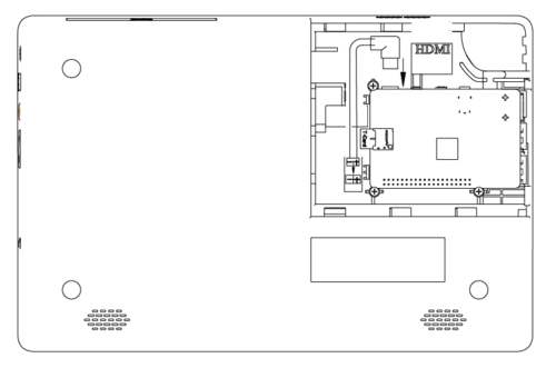

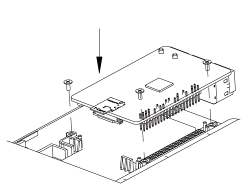

Step 3. Vertically install the Raspberry Pi 4 with the TF card inserted into the Raspberry Pi compartment.

Step 8. Connect the power supply, Use the 12V power supply in the accessories, insert the DC round head into the DC12V power supply port.

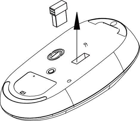

Step 1. Remove the wireless receiver in the mouse compartment .

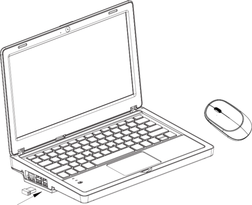

Step 2. Insert any USB port of the Raspberry Pi. .

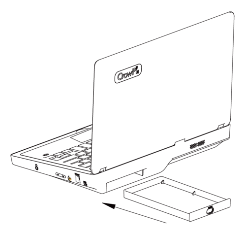

Use your finger to open and close the storage compartment.
Power bank
1 Install 5v power
1.1. Open the storage compartment, put the powerbank into the compartment, insert the wire through the wire hole, and then push it into device.
1.2. Access to 5V micro USB port.
2. Press the power button
Screen brightness adjustment
Press the + button to increase the brightness, press - to decrease.

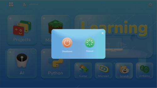

Click "shutdown"shutdown the device or"reboot" to reboot.

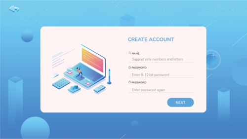

Enter Name, only support numbers and letters. Enter Password, limit the number of characters to 6-12 bits Reconfirm the password entered in the second step, Click "NEXT"

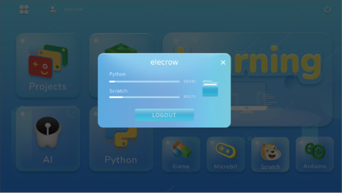

Once you've successfully logged in, click on the user icon, pop up a personal user window, where you can view the progress of your course and your private folder. Click "LOGOUT" to log out of your account.
