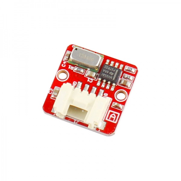

Crowtail- Analog Gyro is based on an angular velocity sensor(Murata-ENC-03R) that uses the phenomenon of Coriolis force.which is generated when a rotational angular velocity is applied to thevibrator.One sensor detects rotation on one axis.
Model: CT0015AG
Feature¶
- Standard Crowtail Interface
- Input Voltage:5V
- Light Weight
- High Speed
- Measure X-axis Angular Velocity
- Dimensions(mm):20.0(L)x20.0(W)x6.8(H)

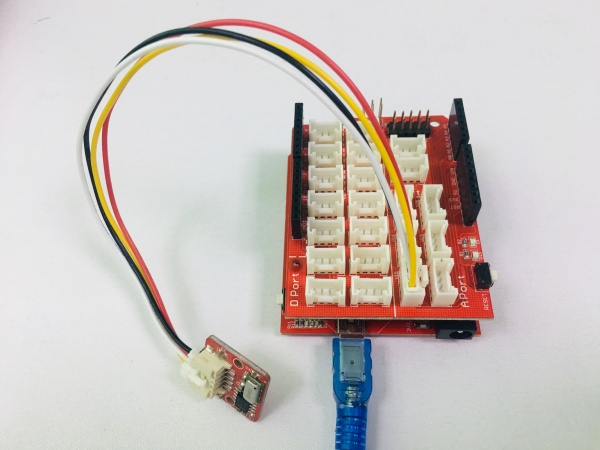

1.Hardware Connection
Connect it to A0 port of Crowtail - Base Shield,Plug the Grove - Base Shield into Arduino/Crowduino and connect them to PC using a USB cable.
2.Upload the below code.
