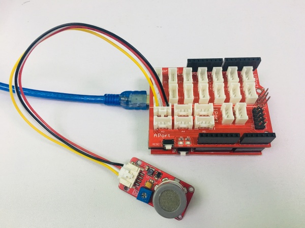

This is a Analog output sensor. This needs to be connected to any one Analog socket in Base Shield. The examples used in this tutorial makes uses of A0 analog pin. Connect this module to the A0 port of Base Shield.
It is possible to connect the Grove module to Arduino directly by using jumper wires by using the connection as shown in the below table:

Connect the Crowtail- Gas Sensor(MQ9) to A0 port as shown in the above picture.
