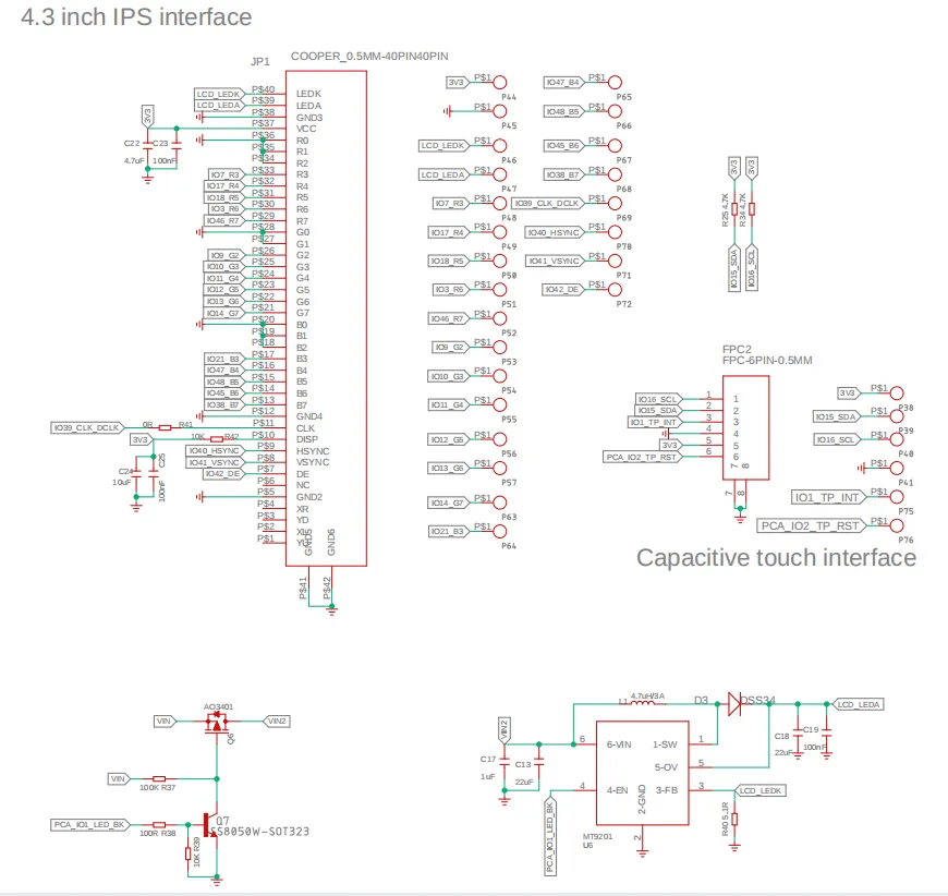

ESP32-S3 and ISP Display Wiring Pins:
advance-4.3
ESP32-S3 and Touch Driver Wiring:
i2c address: 0x5D.
advance-4.3

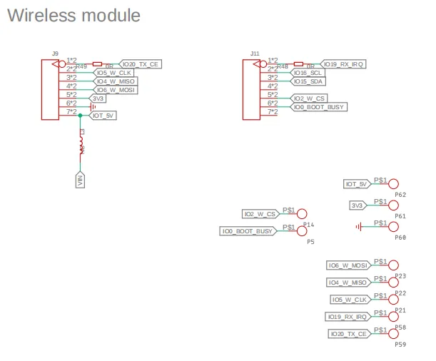

ESP32-S3 and wireless module wiring pins:
advance-4.3

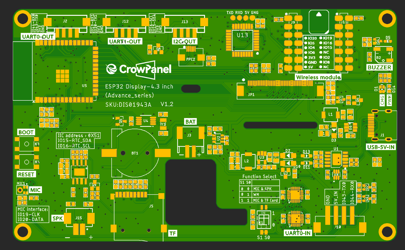

Version 1.1
advance4.3_1.2
4.3-inch HMI port pin number Electrical Characteristics
UART0-OUT RX(IO44); TX(IO43) RX; Output voltage: 3.3V Output current: 1A max. Use: Power supply output and communication.
UART1-OUT RX(IO19); TX(IO20) RX; Output voltage: 3.3V Output current: 1A max. Use: Power supply output and communication.
UART0-IN RX(IO44); TX(IO43) RX; Input voltage: 5V ± 5%. 5.5V max. Input current: 2A max. Purpose: Power supply input and communication.
I2C SDA(IO15); SCL(IO16) ; Output voltage: 3.3V Output current: 1A max. Use: Power supply output and communication.
SPK I2S_LRCLK(IO6);I2S_BCLK(IO5);I2S_SDIN(IO4); Maximum output current: 20mA Signal type: 3.3V logic level, digital control signal
SD Card Slot MOSI(IO6); MISO(IO4); CLK(IO5); CS(3.3V) Maximum output current: 20mA Signal type: 3.3V logic level, digital control signal
LCD Backlight_PWR P3.5(STC8H1K28) Maximum output current: 20mA Signal type: 3.3V logic level, digital control signal
Backlight Adjustment P1.1(STC8H1K28)
I2S MIC MIC_SD(IO20);MIC_CLK(IO19) Maximum output current: 20mA Signal type: 3.3V logic level, digital control signal
BUZZER P2.7(STC8H1K28) Maximum output current: 20mA Signal type: 3.3V logic level, digital control signal
TP_RST P1.7(STC8H1K28)
power amplifier SHUT P3.6(STC8H1K28)
Switching Function Keys:
advance4.3_1.2-1
S1 S0 effective function
0 0 MIC&SPK
0 1 WM(wireless module)
1 1 MIC&TF Card

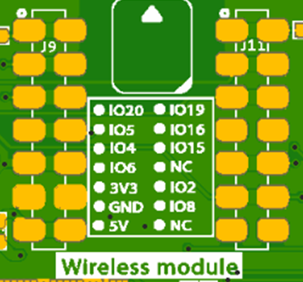

advance4.3_1.2-2
