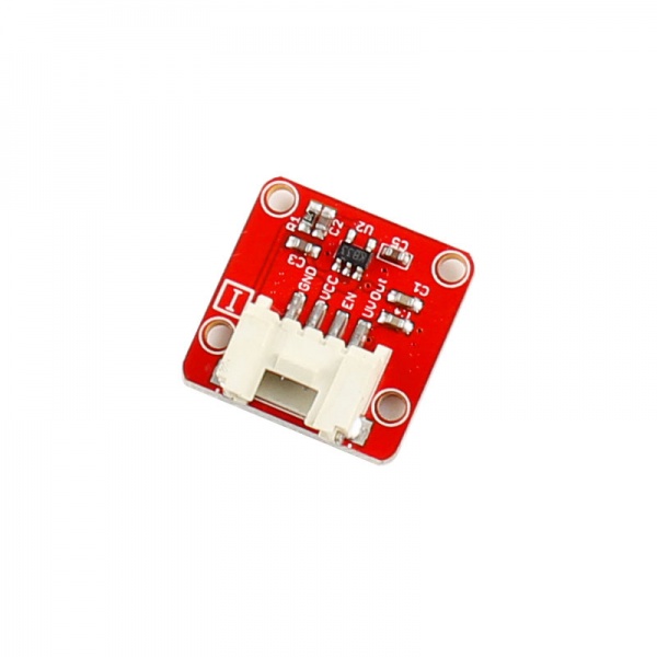

The Crowtail- UV Sensor ML8511 is an easy to use ultraviolet light sensor. The MP8511 UV (ultraviolet) Sensor works by outputing an analog signal in relation to the amount of UV light that’s detected. This breakout can be very handy in creating devices that warn the user of sunburn or detect the UV index as it relates to weather conditions.

The Crowtail- UV sensor connectde to the I port(A4 and A5) of Crowtail- based shiled.
