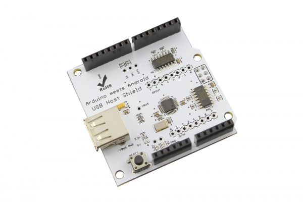

Assemble these parts together like the picture below. And mount the shield onto your Arduino/Crowduino.
