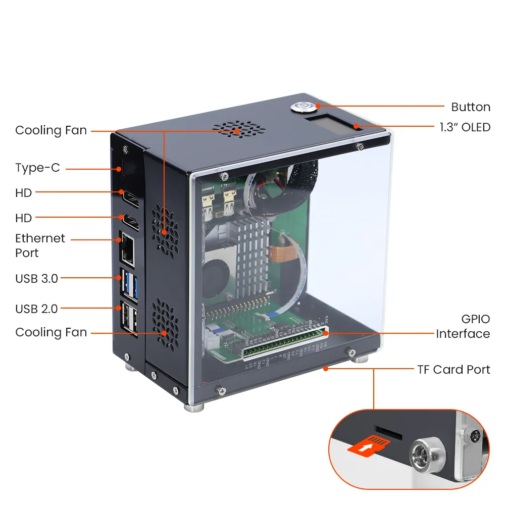

This Mini PC case is a versatile, DIY enclosure solution designed for Raspberry Pi 5 and Jetson Orin Nano single-board computers. The design concept of this chassis shell is to provide users with an integrated, high-performance, and easy-to-expand hardware platform.
Hardware_Overview_of_Raspberry_Pi_Mini_PC_Case
Compatible Device Raspberry Pi 5/Jetson Nano(Optional)
Screen 1.3” OLED

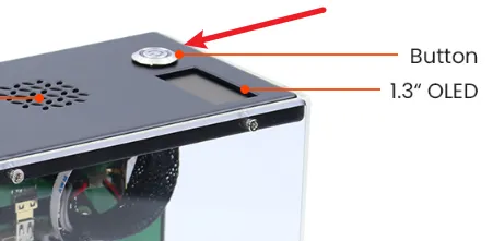

Power Button Yes
SSD Support Type(Raspberry Pi ) Solid state 2230,2242,2260,2280
Material Aluminum alloy + acrylic
Power Supply(Raspberry Pi) 5V 5A
Power Supply(Jetson Nano) 12V 2A
Fan 3x Cooling Fans
Dimension 120*120*72mm

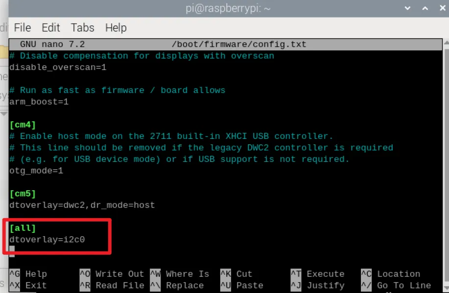

Modify the contents of config.txt
sudo nano /boot/firmware/config.txt
Add "dtoverlay=i2c0" to the last line of config.txt, save it, and then restart the system.
mini_case_4
Then restart the system.

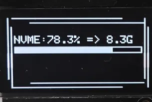

You can see different statuses about your computer on oled. It shows time, temperature, CPU and memory utilization.
