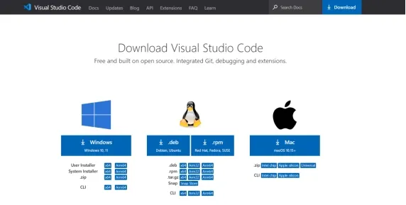

Search for Visual Studio Code download on Google or enter the https://code.visualstudio.com/download, select the version compatible with your computer system and download Visual Studio Code installer. In this instructions we are selecting Windows.
Double-click the VSCodeUserSetup file to install the Visual Studio Code.

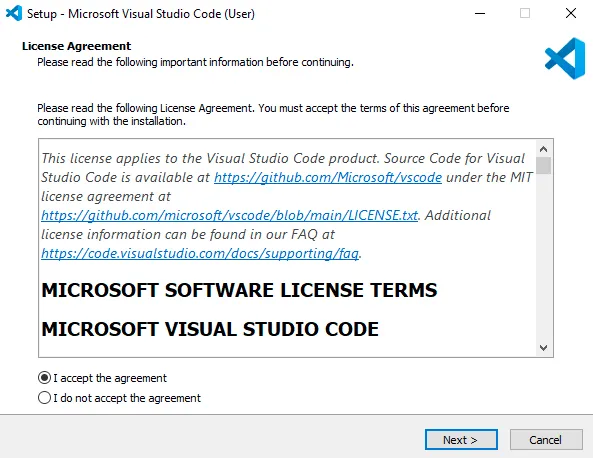

Accept the license agreement and go next.

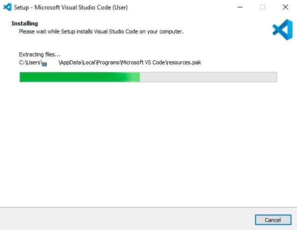

Click install and waiting for the installation ...
Click 'Finish' to exit the installation and (by default) launch Visual Studio Code:

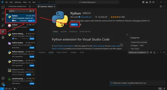

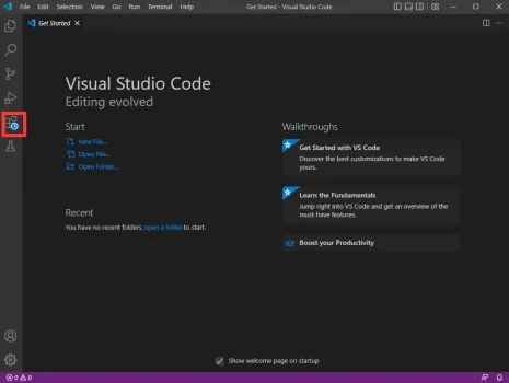

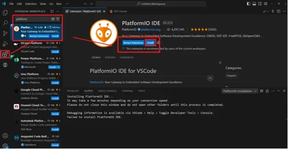

Open Visual Studio Code and open Extension Manager.
Install Python
Search for 'Python' and install.
Install PlatformIO
Search for 'PlatformIO' and install.

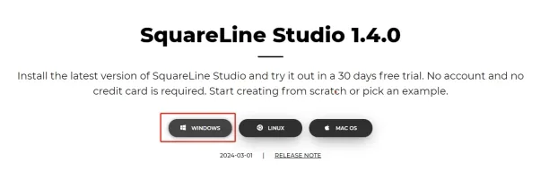

4.1 Installation Guide
Download the version 1.4.0

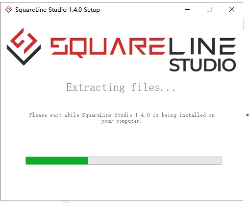

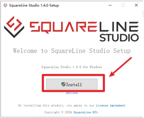

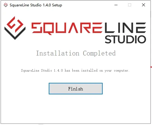

Click install.
Wait for installation.
Installation finish.

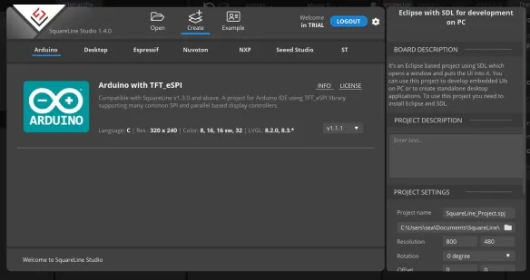

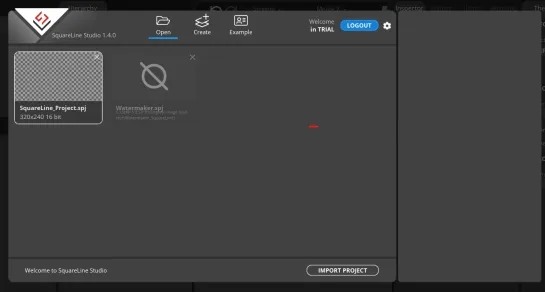

Open the software
Note:Please select the corresponding resolution and color depth according to the screen specifications.

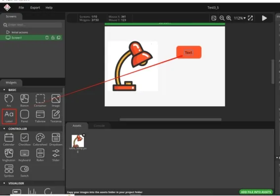

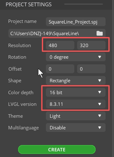

5. Use SquareLine Studio to create UI control interfaces

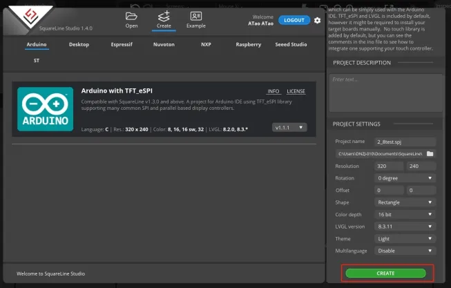

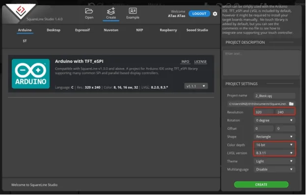

5.1 Create a new SquareLine Studio project.
The 3.5-inch version has a resolution of 480×320.

5.2 Add functions to the buttons to enable them to turn on and off lights
Select 'event' to add in the right sidebar.
After selecting, click ADD.
After adding, run

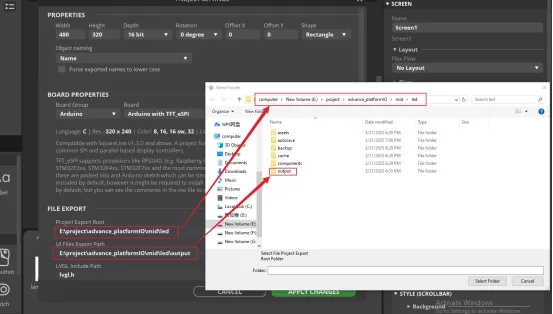

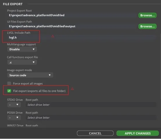

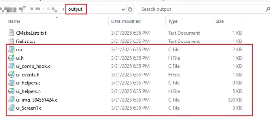

5.3 UI interface design completed, exporting UI files for easy use in subsequent code
Click on Project Setting
Set export path.
Complete the setup and export file.

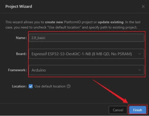

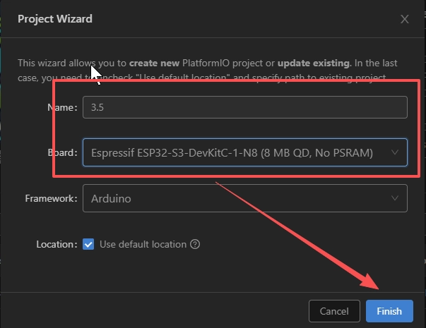

Click the PlatformIO icon, click QUIK ACCESS 'Open', then click '+New Project'.
Add a project name. Select "Espressif ESP32-S3-DevKitC-1-N8" for the board and Arduino for the framework.

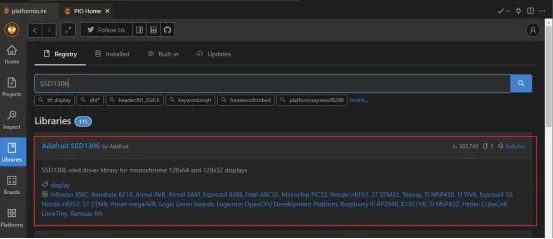

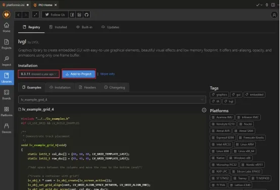

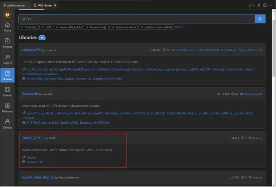

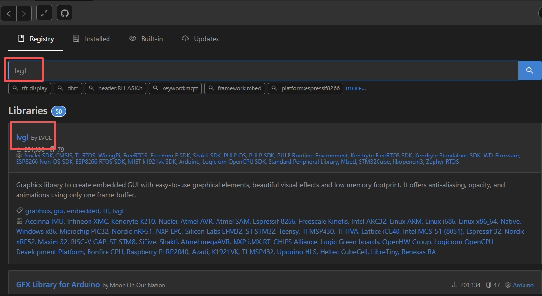

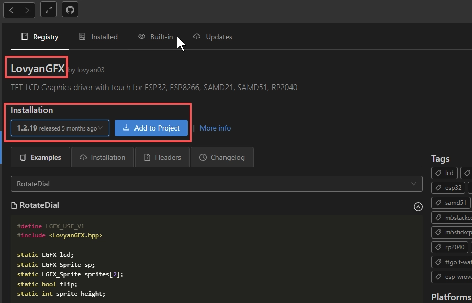

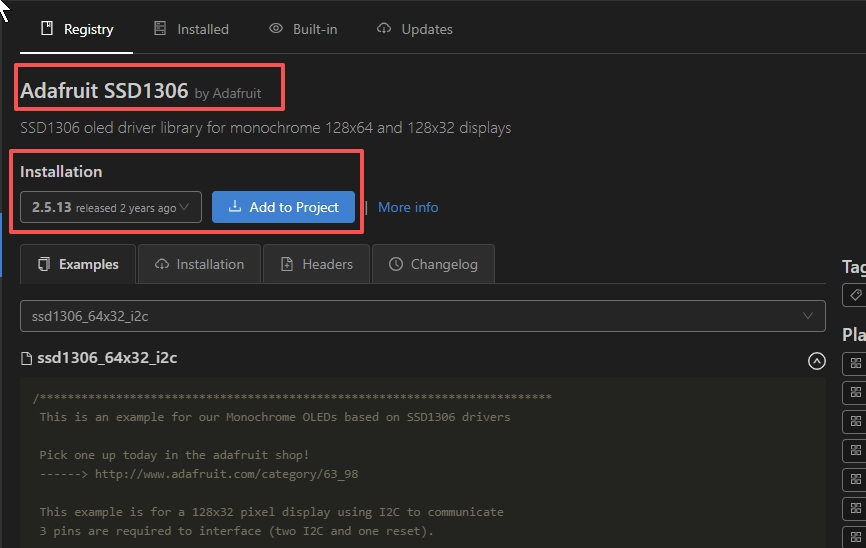

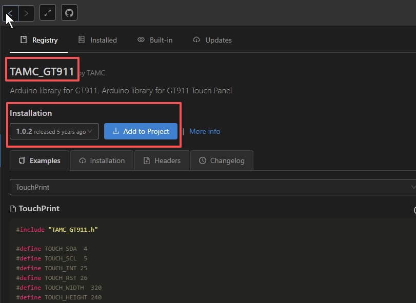

6.2 Add the necessary libraries to the PlatformIO project.

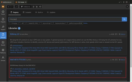

Click the PlatformIO icon, click ‘Libraries’, then search for the following libraries.
① Lvgl(8.3.11)
② LovyanGFX(1.2.19)
③ Adafruit SSD1306(2.5.13)
④ TAMC_GT911(1.0.2)

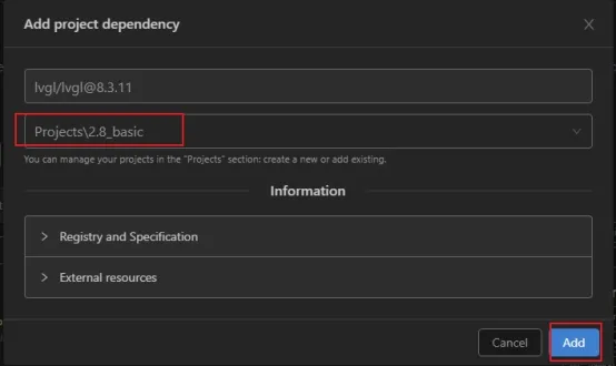

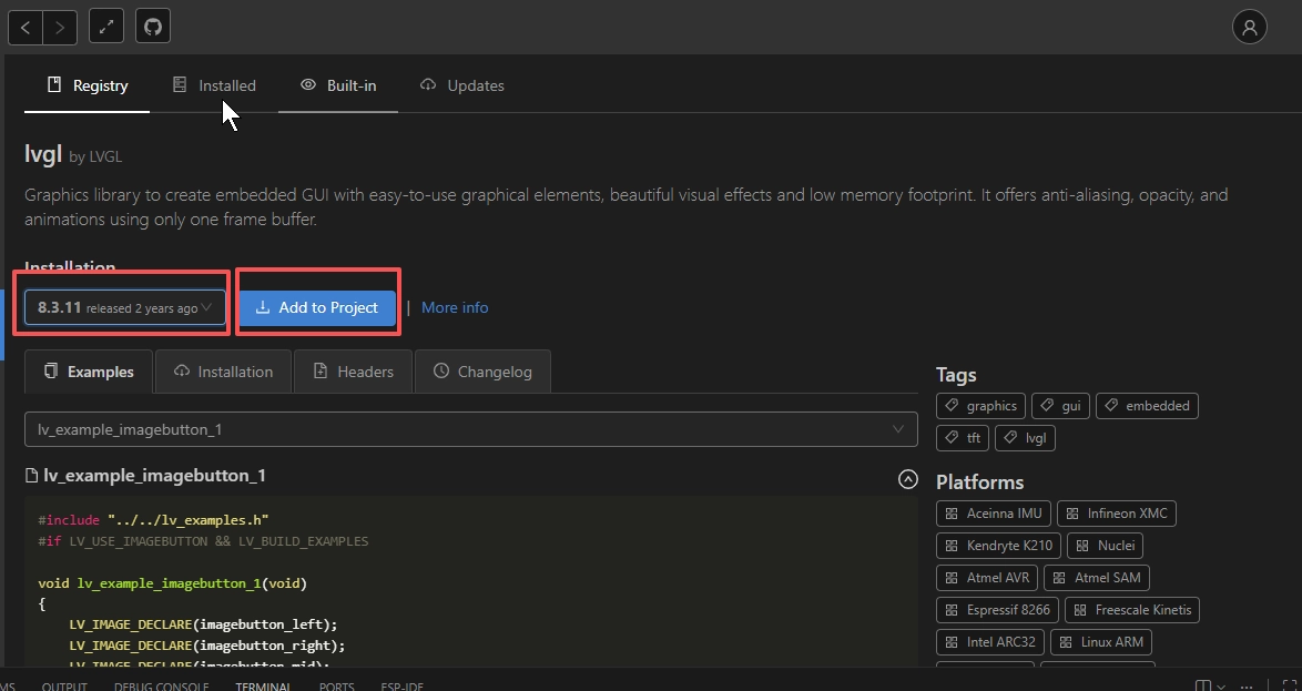

Click on the LVGL library.

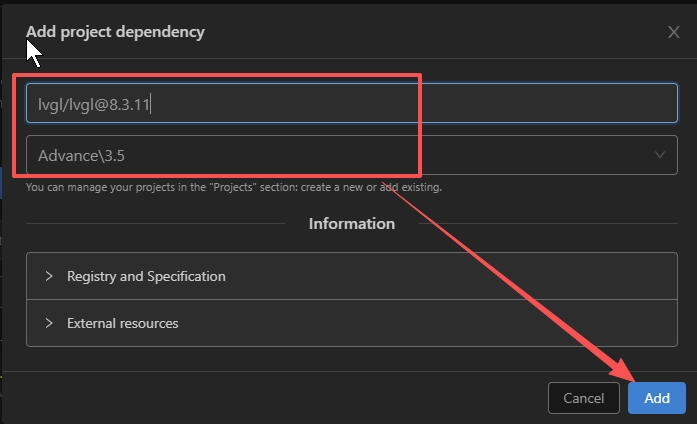

102
Select version 8.3.11 (which needs to correspond to the version selected when creating the project in SquareLine Studio), and click "Add to Project".
103
Select the corresponding project name and click "Add".
104

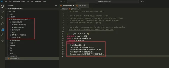

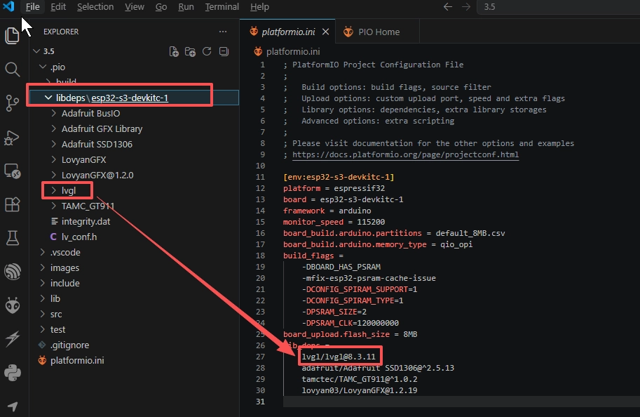

If the library is successfully added to the project, the interface will automatically jump to the PlatformIO.ini file and automatically generate the project dependencies.
105
Note: If the platformio.ini file remains unchanged, but the library that has just been added is present in the pio->libdeps->esp32-s3-devkitc-1 folder, then click on "Compile". The PlatformIO plugin will pop up a window prompting you to change the library dependency link in the platformio.ini file.
Repeat the above steps and add the remaining libraries one by one (just select the latest version by default for the library versions).
106

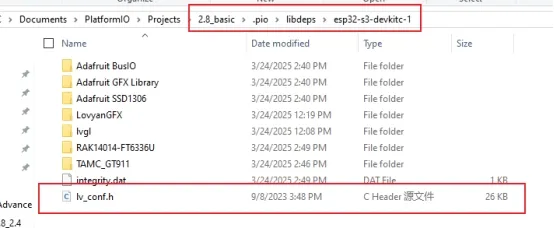

107
108

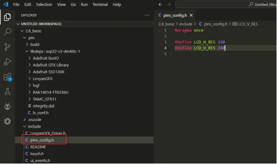

Place the lv_conf.h we provide to the path: .pio\libdeps\esp32-s3-devkitc-1-myboard in the project folder.
https://github.com/Elecrow-RD/CrowPanel-Advance-3.5-HMI-ESP32-S3-AI-Powered-IPS-Touch-Screen-480x320/tree/master/example
Under the PlatfromIO/.pio/libdeps/esp32-s3-devkitc-1 path.

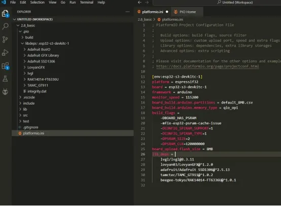

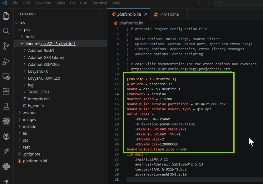

6.3 Add the chip configuration to the PlatformIO project
Open the platformio.ini file. This file is the configuration file of the PlatformIO project, which is used to define information such as the project's build environment, upload options, and library dependencies. Copy the following development board configuration into this file.
monitor_speed = 115200
board_build.arduino.partitions = default_8MB.csv
board_build.arduino.memory_type = qio_opi
build_flags =
    -DBOARD_HAS_PSRAM
    -mfix-esp32-psram-cache-issue
    -DCONFIG_SPIRAM_SUPPORT=1
    -DCONFIG_SPIRAM_TYPE=1
    -DPSRAM_SIZE=2
    -DPSRAM_CLK=120000000
board_upload.flash_size = 8MB

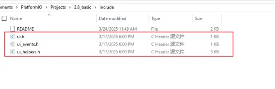

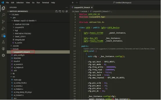

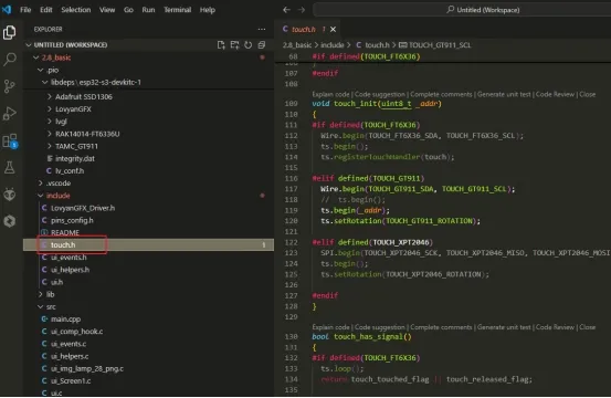

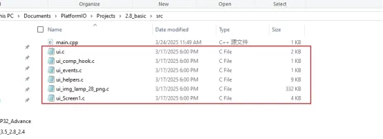

6.4 Add the necessary source files and header files to the PlatformIO project
Find the UI source files and header files generated by SquareLine Studio.
Copy the.c file in the UI file to the src folder of the PlatformIO project.
Copy the.h file in the UI file to the include folder of the PlatformIO project.

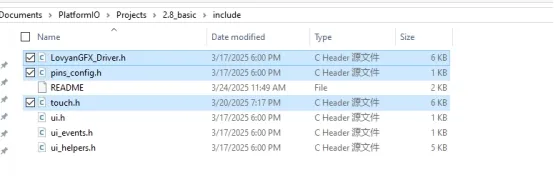

Similarly, add the display driver and pin definition header files to the include folder.
These three files have their pin configurations modified for the corresponding hardware. The pre-configured files are already available on GitHub.
Under the include path.

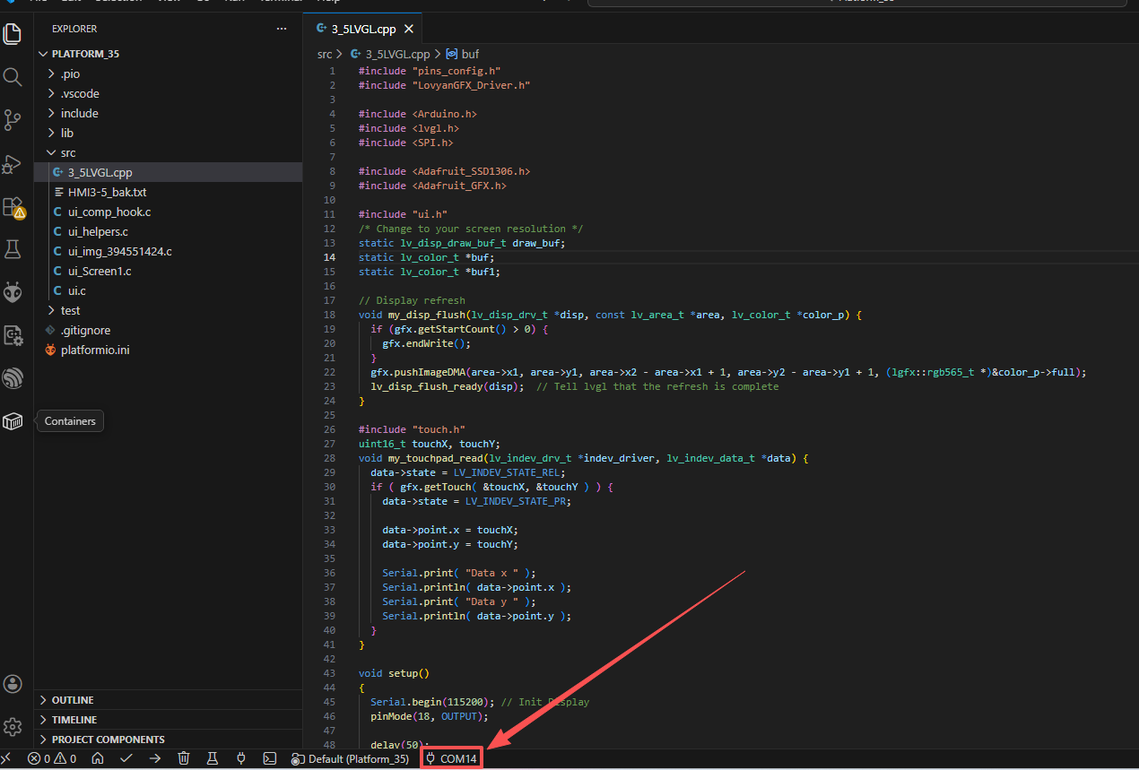

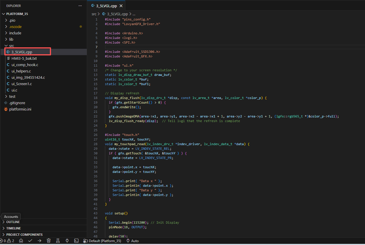

6.5 Write the main program in main.cpp
In PlatformIO, the.cpp file is an extremely crucial C++ source file. It serves as the core carrier for implementing program logic. It can define various functional functions to complete specific tasks, and it can also implement classes and objects, organizing the code with the object-oriented programming concept.
In terms of interacting with hardware, the.cpp file enables the writing of driver code to initialize, read from, and write to hardware devices such as sensors and actuators. Additionally, it allows for the writing of interrupt service routines to respond to hardware interrupts.
Moreover, the.cpp file supports modular development. Different functional codes can be encapsulated within it, which facilitates code reuse. In a multi-person team development scenario, different team members can be assigned to write different.cpp files, thereby improving development efficiency and the maintainability of the project.
#include "pins_config.h"
#include "LovyanGFX_Driver.h"
#include <Arduino.h>
#include <lvgl.h>
#include <SPI.h>
#include <Adafruit_SSD1306.h>
#include <Adafruit_GFX.h>
#include "ui.h"
/* Change to your screen resolution */
static lv_color_t *buf;
static lv_color_t *buf1;
// Display refresh
void my_disp_flush(lv_disp_drv_t *disp, const lv_area_t *area, lv_color_t *color_p) {
  if (gfx.getStartCount() > 0) {
    gfx.endWrite();
  gfx.pushImageDMA(area->x1, area->y1, area->x2 - area->x1 + 1, area->y2 - area->y1 + 1, (lgfx::rgb565_t *)&color_p->full);
  lv_disp_flush_ready(disp);  // Tell lvgl that the refresh is complete
#include "touch.h"
uint16_t touchX, touchY;
void my_touchpad_read(lv_indev_drv_t *indev_driver, lv_indev_data_t *data) {
  if ( gfx.getTouch( &touchX, &touchY ) ) {
    data->point.x = touchX;
    data->point.y = touchY;
    Serial.print( "Data x " );
    Serial.println( data->point.x );
    Serial.print( "Data y " );
    Serial.println( data->point.y );
void setup()
  Serial.begin(115200); // Init Display
  pinMode(18, OUTPUT);
  delay(50);
  // Init Display
  gfx.init();
  gfx.initDMA();
  gfx.startWrite();
  gfx.fillScreen(TFT_BLACK);
  lv_init();
  size_t buffer_size = sizeof(lv_color_t) * LCD_H_RES * LCD_V_RES;
  buf = (lv_color_t *)heap_caps_malloc(buffer_size, MALLOC_CAP_SPIRAM);
  buf1 = (lv_color_t *)heap_caps_malloc(buffer_size, MALLOC_CAP_SPIRAM);
  lv_disp_draw_buf_init(&draw_buf, buf, buf1, LCD_H_RES * LCD_V_RES);
  // Initialize display
  lv_disp_drv_init(&disp_drv);
  // Change the following lines to your display resolution
  disp_drv.hor_res = LCD_H_RES;
  disp_drv.ver_res = LCD_V_RES;
  // Initialize input device driver program
  // Scan iic
  uint8_t gt911_address;
  delay(100);
  /* Turn on backlight*/
  pinMode(38, OUTPUT);
  digitalWrite(38, HIGH);
  // Init touch device
  gt911_address = 0x14;
  touch_init(gt911_address);
  ui_init();
void loop()
  delay(5);

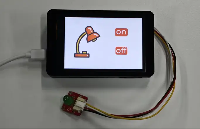

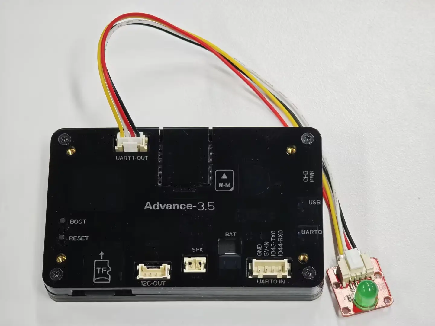

6.6 Burn the well-written PlatformIO project into the CrowPanel Advance ESP32 AI display
Connect the light bulb at the UART1 interface

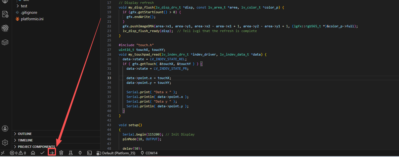

Select the corresponding serial port.

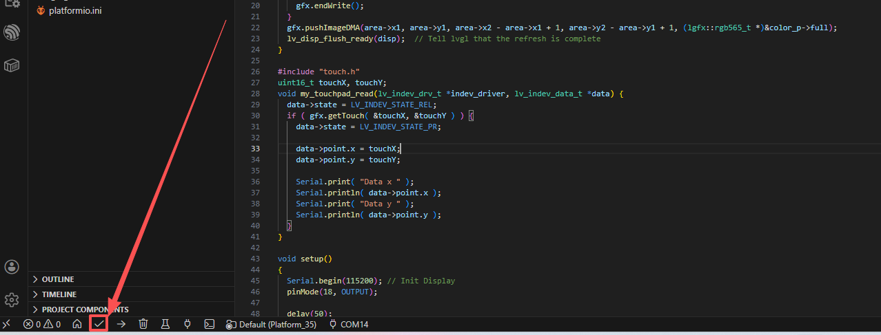

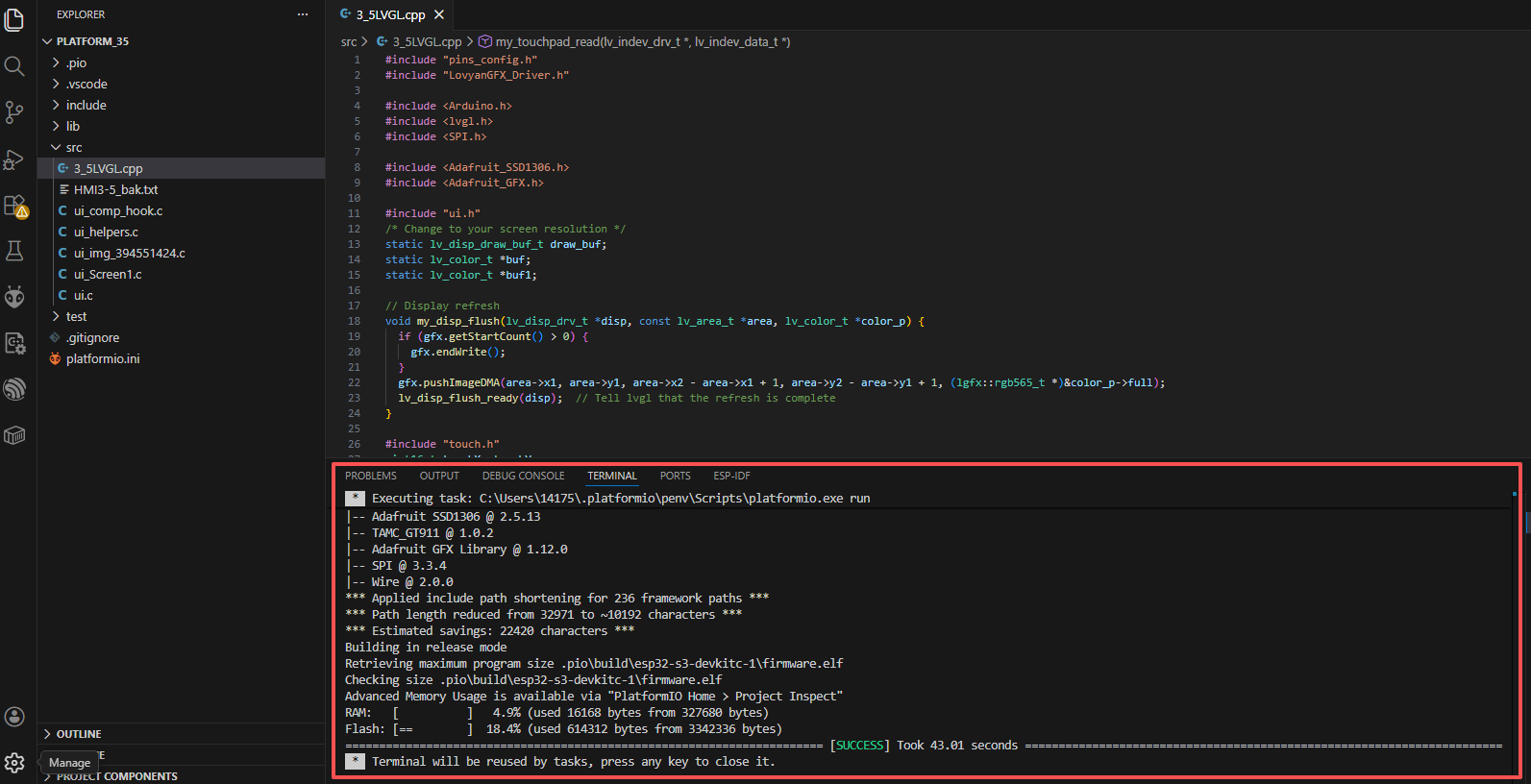

Click this button to build.
Wait for the compilation to be completed.

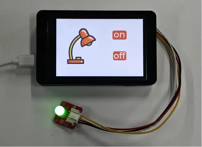

Click to burn.
Wait for the burning process to be completed.
So you can see the UI interface you just designed.
You can click the On and Off buttons to control the on/off of the lights
