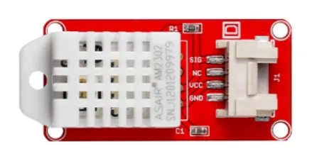

ESP32 Terminal RGB | Crowtail-AM2302 | Crowtail-LED |

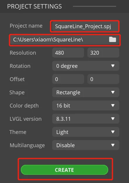

Set the name of the project, set the screen resolution to 480*320, set the color depth to 16bit, and keep other default settings. After setting, click CREATE to create the project.

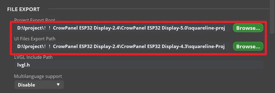

Export UI files.
Then click "APPLY CHANGES".

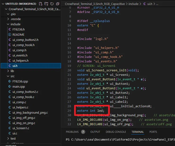

First, define a
extern int led;
in the ui.h file to store the status of the LED. The value of this variable is judged to control the on and off of the LED.Then find "FUNCTION" in the ui.c file. Here is the corresponding code generated when we add events in SquareLine.
When button 1 (ON button) is pressed, set the LED value to 1.
When button 2 (OFF button) is pressed, set the LED value to 0.

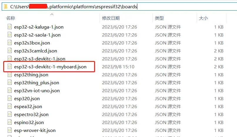

Place the esp32-s3-devkitc-1-myboard.json to the directory in the following picture:
Please click
to download the esp32-s3-devkitc-1-myboard.json.

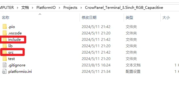

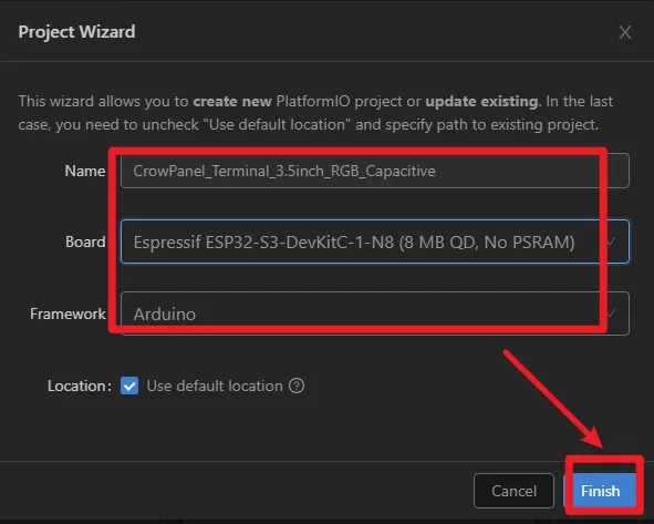

Open Visual Studio Code, click the PlatformIO icon, click QUICK ACCESS 'Open', then click '+New Project'.
Add a project name "CrowPanel_Terminal_3.5inch_RGB". Select "Espressif ESP32-S3-DevKitC-1-N8 (8 MB QD, NO PSRAM)" for the board and "Arduino" for the framework.
Note: The ESP32-S3-N16R8 development board cannot be found in the platformio configuration. Here, the board is selected as Espressif ESP32-S3-DevKitC-1-N8 (8 MB QD, No PSRAM). If you need to use PSRAM, the configuration can be modified in the platformio.ini file. The configuration is as follows:
[env:esp32-s3-devkitc-1] platform = espressif32 board = esp32-s3-devkitc-1 framework = arduino lib_ldf_mode = deep+ #Use the "depth +" mode when searching for library dependencies board_build.arduino.partitions = default_16MB.csv board_build.arduino.memory_type = opi_opi #Run mode for 8MB PSRAM build_flags = -DBOARD_HAS_PSRAM #Used to indicate to the compiler whether the current target device has PSRAM -mfix-esp32-psram-cache-issue #Compilation options to fix PSRAM cache coherence issues on ESP32 board_upload.flash_size = 32MB #FLASH size
This example does not use PSRAM and it does not need to be modified.

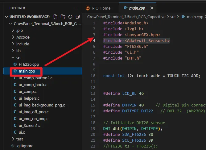

Write the main program in main.cpp.

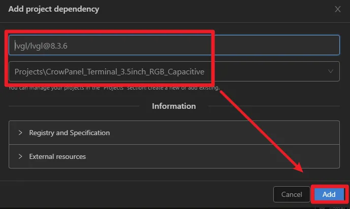

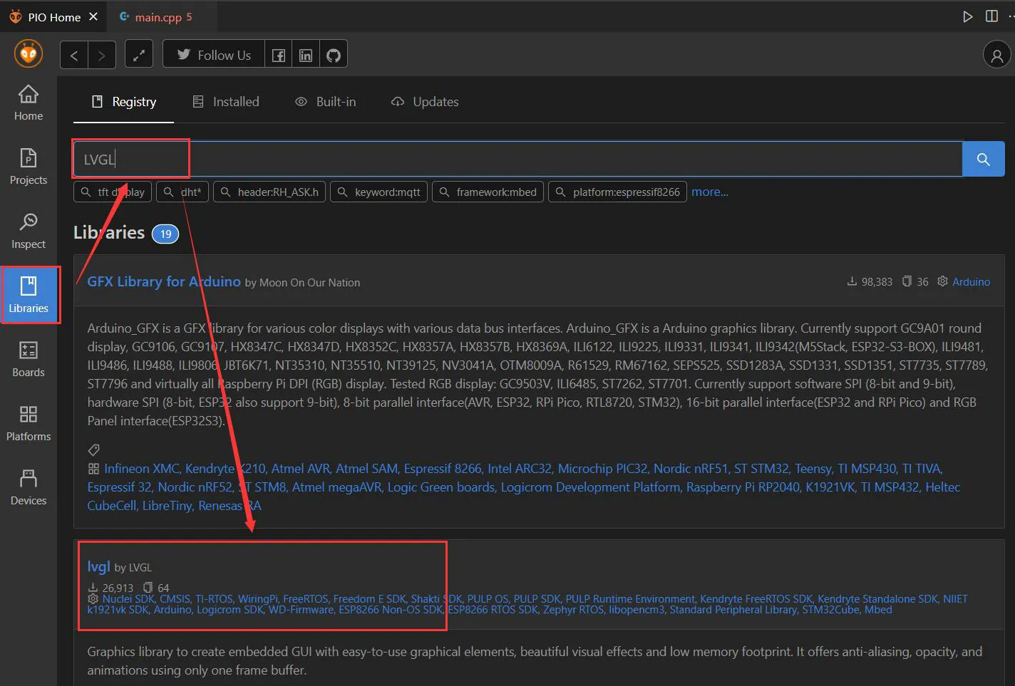

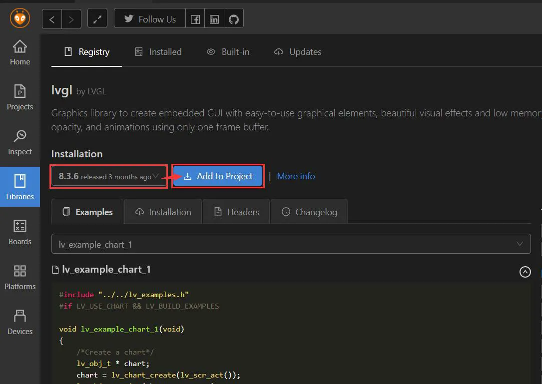

Click the PlatformIO icon, click QUIK ACCESS 'Open', then click 'Libraries'.

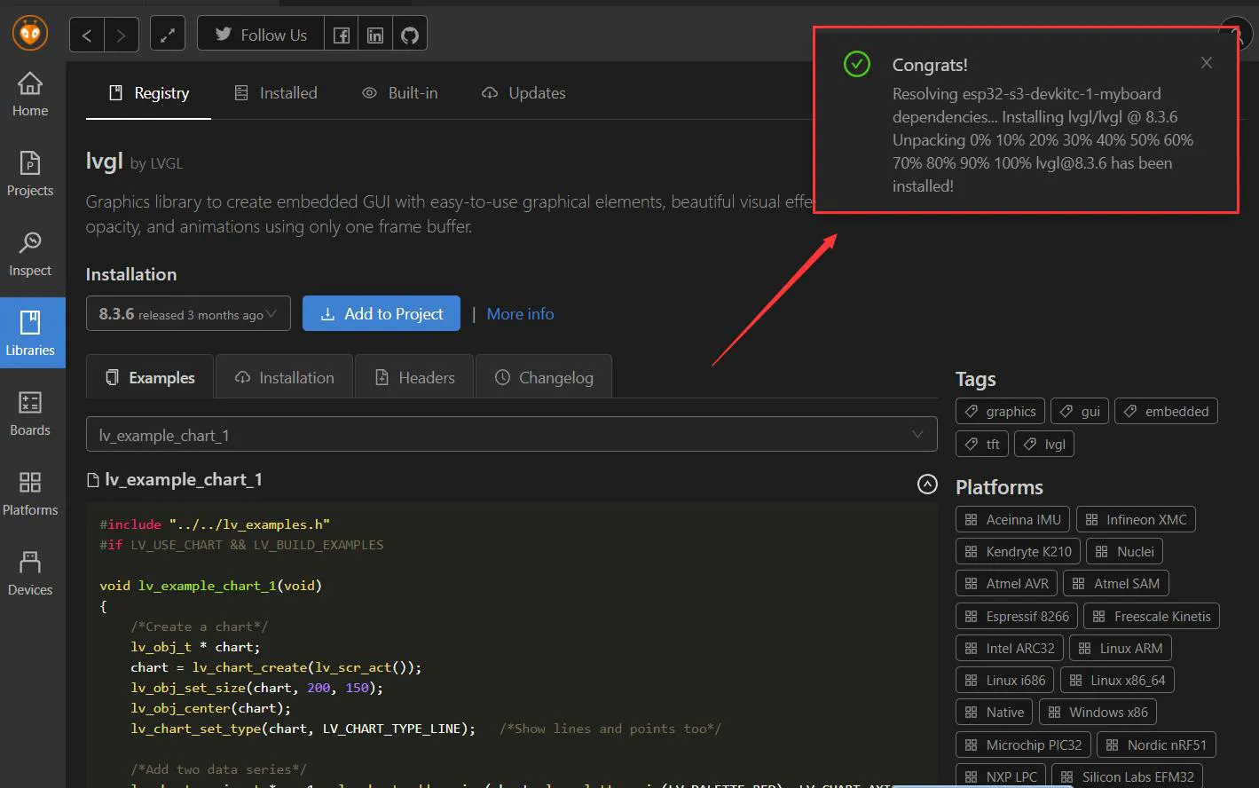

Search for LVGL, and add it to the project.

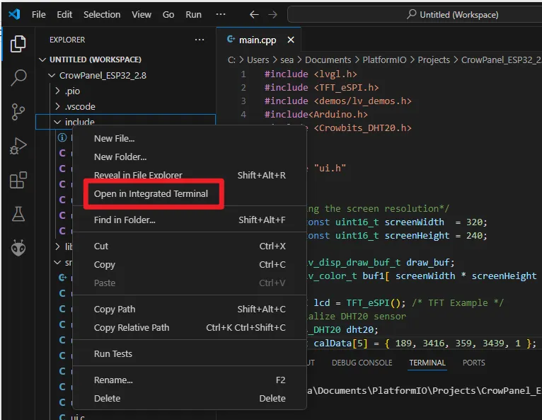

After adding, right click on lvgl and select "Open in Integrated Terminal"
Copy the "demos" and "examples" folders to "src" folder

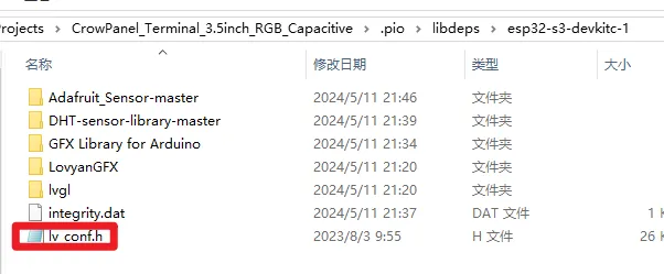

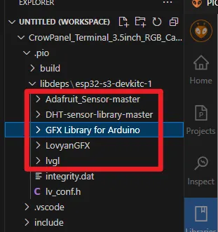

Place the lv_conf.h we provide to the path: .pio\libdeps\esp32-s3-devkitc-1 in the project folder.

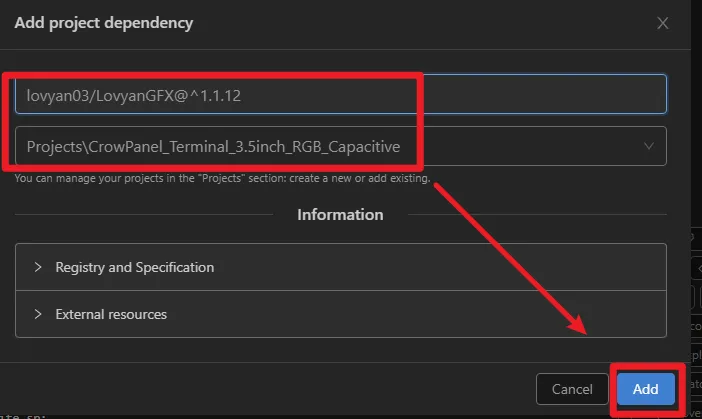

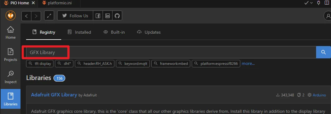

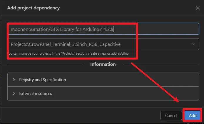

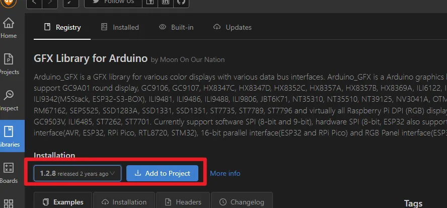

Add GFX_Library library.

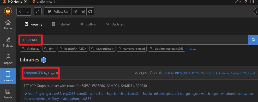

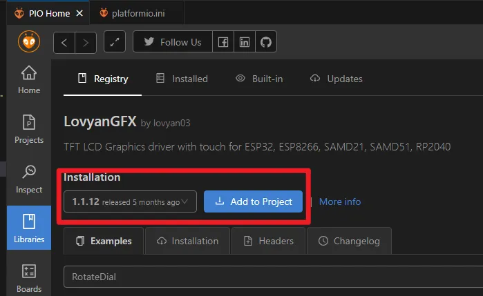

Add LovyanGFX library
We can see that the library has been added successfully!

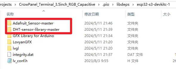

Add libraries for sensor.

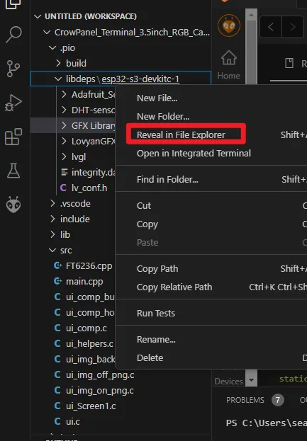

Right-click the "libdeps\esp32-s3-devkitc-1", click "Reveal in File Explorer", and select the sensor libraries we provided.

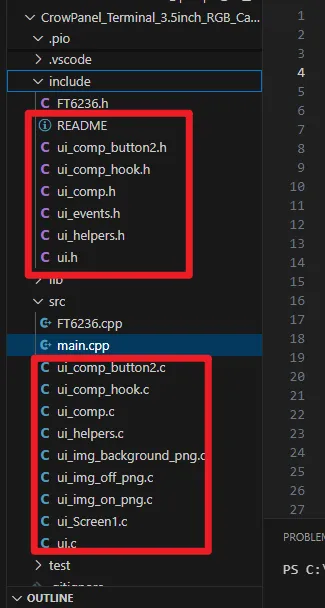

Add the UI file into PlatformIO Project¶
We need to add the UI file (generated from SquareLine Studio) to the PlatformIO project.
The .c files in the UI file should be placed in the /scr folde**r of the project file, and the **.h files should be placed in the /include folder.

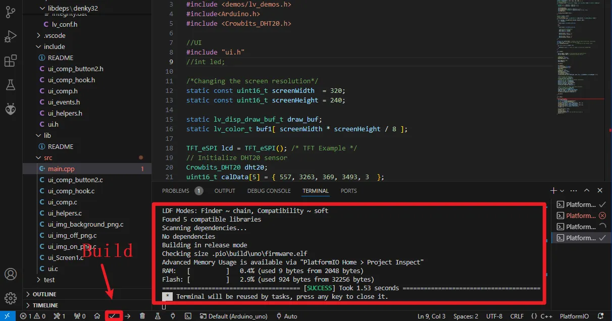

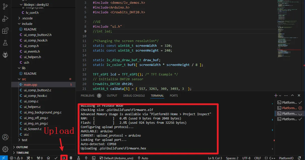

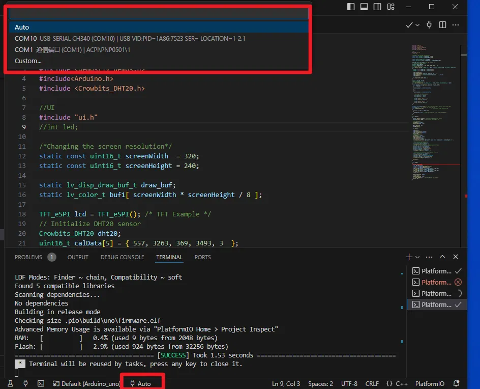

Compile the program.
Select the serial port and upload the code.
Here we select Auto. The software will automatically select the corresponding serial port for program download. If the automatically selected serial port is incorrect, you can manually select the correct serial port.
Click the upload button to up the program to the board.

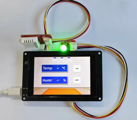

The program will run on the board!
