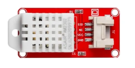

The example tutorial is an environmental monitoring project, demonstrate how to create a UI and use a Humidity&Temperature sensor to obtain the environment temperature and humidity and display it on the screen; and how to control the LED on and off by the buttons on the screen.
Hardware Preparation¶

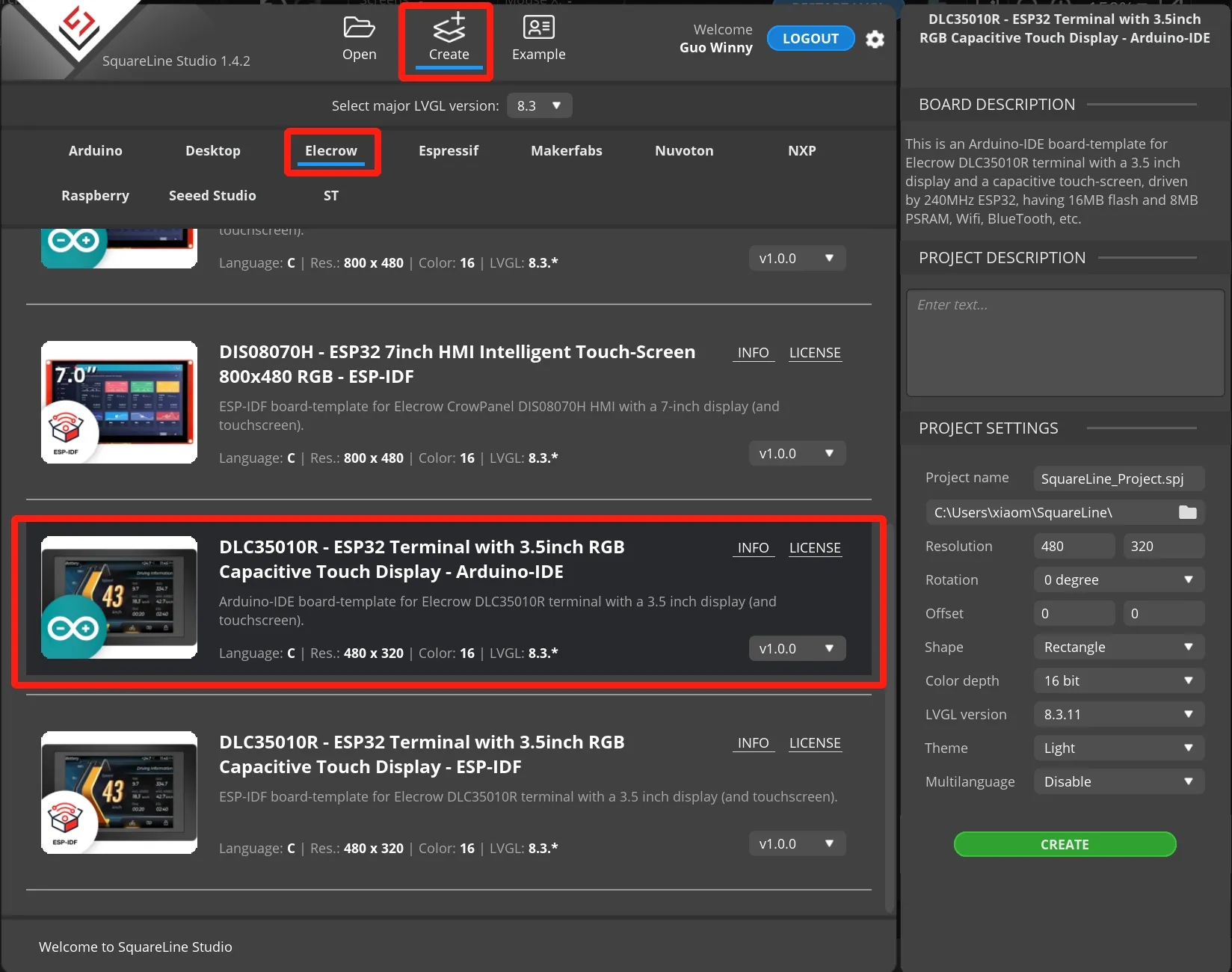

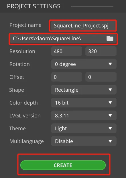

Open the SquareLine Studio and create a project. Select "Elecrow"->"DLC35010R - ESP32 Terminal...-Arduino-IDE".
Set the name of the project, you can select the folder to save the project. Click CREATE to create the project.

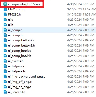

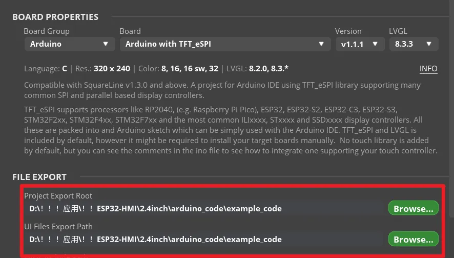

Export UI files.
Then click "APPLY CHANGES".
Please click
to download the main program(and the expert UI is included).

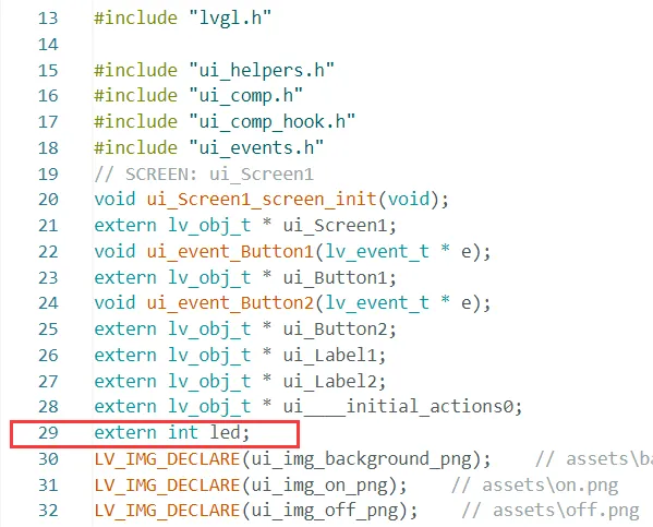

Modify the button event code.
First, define an extern variable in the ui.h file to store the status of the LED. In the main program, the LED light is controlled to turn on and off by judging the status of this variable.
- When button 1 (ON button) is pressed, set the LED value to 1.
- When button 2 (OFF button) is pressed, set the LED value to 0.

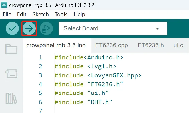

Build the Project with Arduino IDE¶
Get Started with Arduino IDE¶

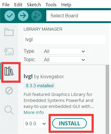

Install Libraries¶
#include<Arduino.h>
#include <lvgl.h>
#include <LovyanGFX.hpp>
#include "FT6236.h"
#include "ui.h"
#include "DHT.h"
#include <Arduino.h>
: contains the Arduino core library, providing commonly used functions and data types.#include <LovyanGFX.hpp>
: A library for drawing graphics on embedded systems, providing rich graphics functions and APIs.#include "FT6236.h"
: A library for the FT6236 touch chip to handle touch input.#include "ui.h"
: is a custom header file that contain UI-related functions or definitions.#include "DHT.h"
: to read data from the temperature and humidity sensor.
Please click to download the libraries we modified.

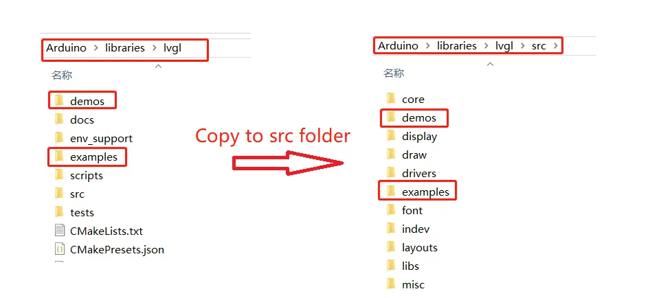

If you install the lvgl libraries by Library Manager, you need to copy the demos folder and examples folder and paste them to src folder. And modify the lv_conf_template.h file and rename it to lv_conf.h, and place it in libraries folder.(Please refer to the library provided)

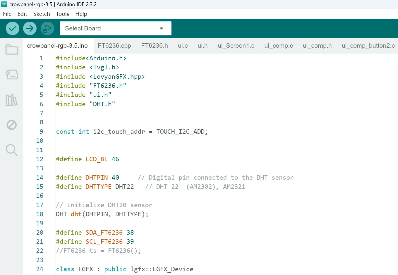

Basic Definition¶
Pin Definition
Touch I2C definition, LCD backlight definition pin, temperature and humidity sensor definition pin and initialization.
const int i2c_touch_addr = TOUCH_I2C_ADD;
#define LCD_BL 46
#define DHTPIN 40 // Digital pin connected to the DHT sensor
#define DHTTYPE DHT22 // DHT 22 (AM2302), AM2321
// Initialize DHT20 sensor
DHT dht(DHTPIN, DHTTYPE);
#define SDA_FT6236 38
#define SCL_FT6236 39
//FT6236 ts = FT6236();

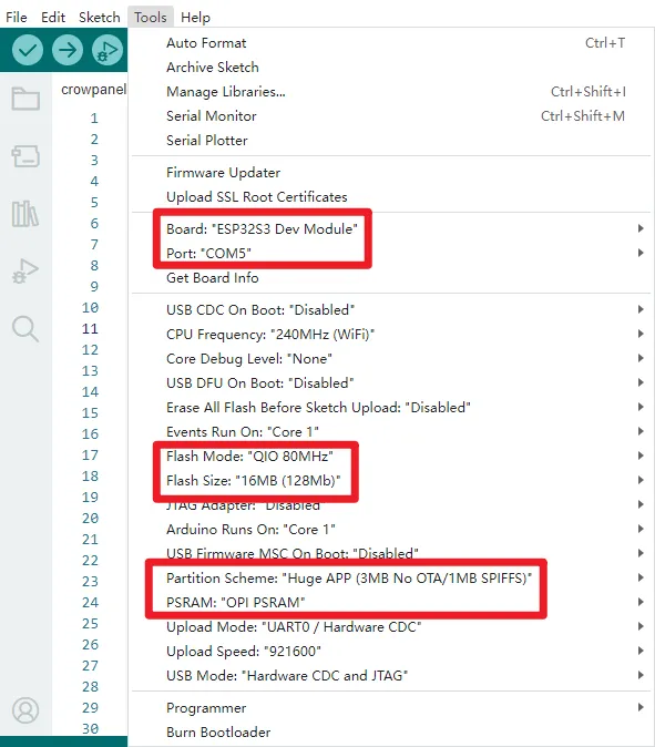

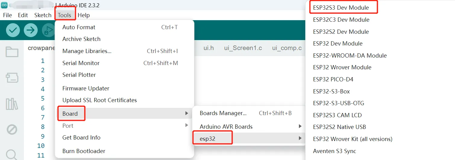

After completing the installation of the ESP32 board according to "Get Started with Arduino IDE" and the installation of the library according to "Install Libraries", open the program and connect the ESP32 Terminal to the computer via a USB-C cable.
Select Board: click "Tools" -> "Board" -> "esp32" and select "ESP32S3 Dev Module"
Select Port
Select the serial port corresponding to the ESP32 terminal board.
Upload the code

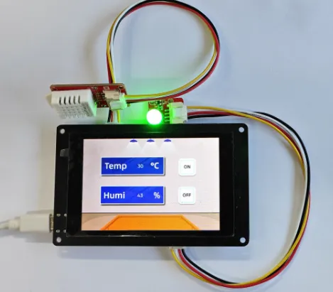

After the program is successfully uploaded, connect the sensor to the D Port(IO40) port and the LED to A Port(IO19), the temperature and humidity values will be displayed on the screen. Click the ON button on the screen and the LED will turn on. Click the OFF button and the LED will turn off.

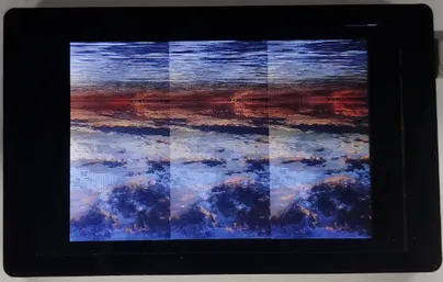

Example 2: Display the pictures from TF card¶
- Insert the TF card in to card slot
- Open and upload the F-photo.ino
- The pictures will show on the screen

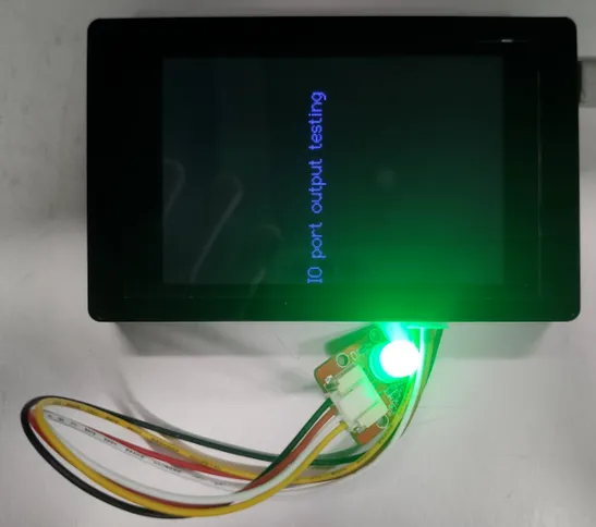

Example 3: LED Blinking¶
- Plug the LED into the D port
- Open and upload the D-D-PortOut.ino
- The LED will blink alternately

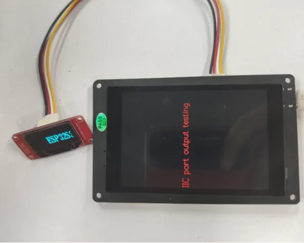

Example 4: I2C communication¶
- Plug an OLED screen to the I2C port
- Open and upload the E-IIC.ino
- The OLED screen will display the content sent from the ESP terminal

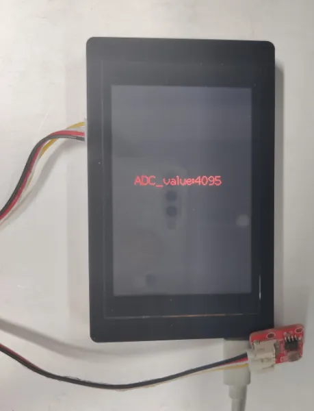

Example 5: Read the external ADC through the A port¶
- Plug a sensor into the A port
- Open and upload A-ADC.ino
- The value of the sensor will show on the screen
