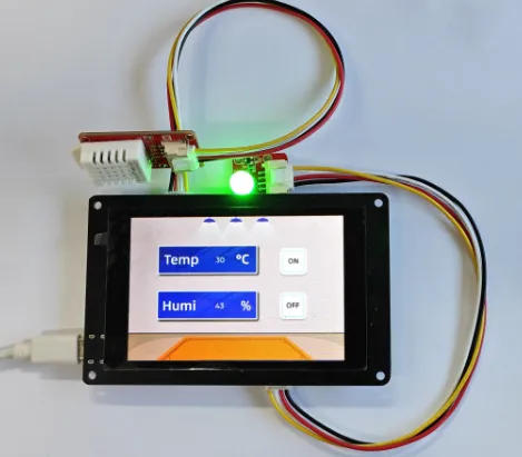

The example tutorial is an environmental monitoring project, demonstrate how to create a UI and use a Humidity&Temperature sensor to obtain the environment temperature and humidity and display it on the screen; and how to control the LED on and off by the buttons on the screen.

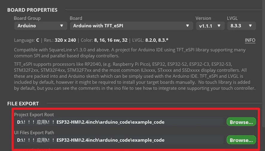

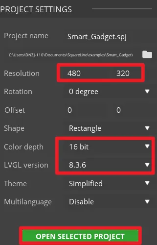

Open the SquareLine Studio and create a project. Select "Desktop"->"Micropython for Unix and other platform".
Set the name of the project, set the screen resolution to 480*320, set the color depth to 16bit, and keep other default settings. After setting, click CREATE to create the project.

Export UI files.
Then click "APPLY CHANGES".

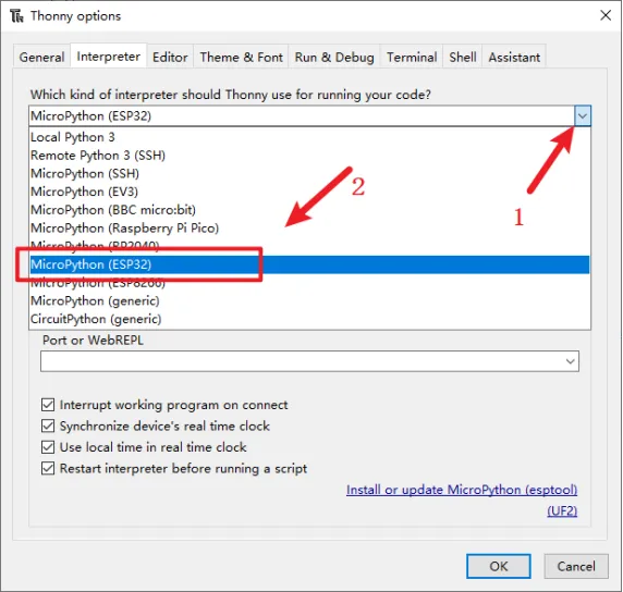

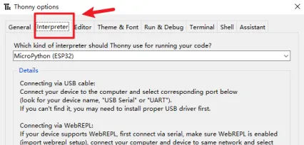

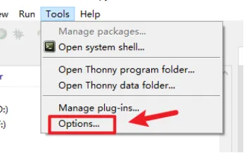

Open Thonny IDE and click "Tools"->"Options"->"Interpreter".
Select "MicroPython(ESP32)" for interpreter.

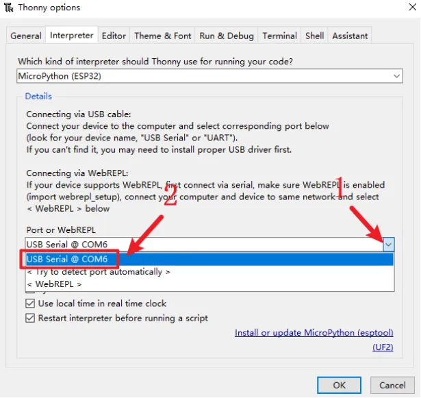

Select the corresponding serial port(or Try to detect port automatically).
Click "Install or update MicroPython (esptool)"
Click the icon with 3 lines, and click "select local MicroPython image...".Select the "lv_micropython.v1.19.1-ili9341-xpt2046.bin" and install.

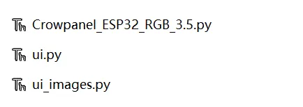

Please click to download the code file and libraries.
- The main code is "CrowPanel_ESP32_RGB_3.5.py"
- The "ui_image.py" is the libraries
- The ui.by is exported from Squaline Studio and needs to be copied into the main program

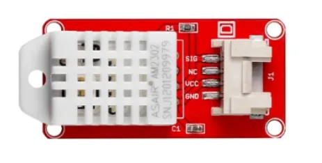

sensor = dht.DHT22(Pin(40))

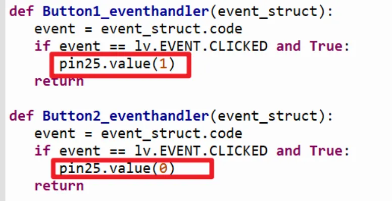

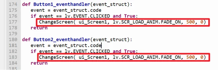

This part copies the code of ui.py generated by Squareline Studio. We need to modify the part that control the button.
From
to

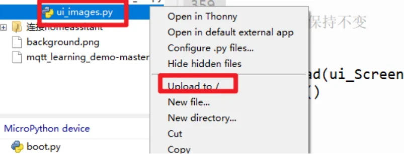

Upload the libraries¶
ui_image
In the upper left corner of the thonny, enter the path where DHT20.py is located, right-click DHR20.py, and click Upload to/
Waiting for uploading
The DHT20.py will be added to the MicroPython device column.

Click the "run" icon to run the main code.
Successfully uploaded.

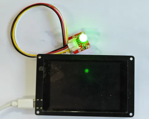

Example 1 LED Blinking¶
Plug the LED module to GPIO-D Port
Upload the led.py to board
The LED will blink

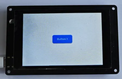

Example 2 Show the button on the screen¶
Upload the button-1-3.5.py to the board

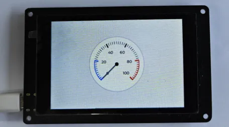

Example 3 Show the dial plate on the screen¶
Upload the biaopan-3.5.py to the board

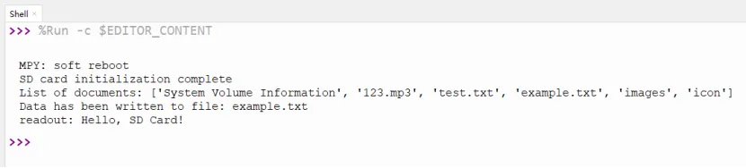

Example 5 Initialize SD card¶
Insert the SD card to the card slot
Upload the sd.py
