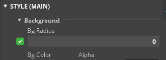

4 Make simple settings for the slider component:
①Set the main background color to transparent.
②Set the indicator and add a background image.
③Finally, set the KNOB.
5 Perform the same setting for the Slider module on the right, or copy the Slider from step 4 and change the background image.
