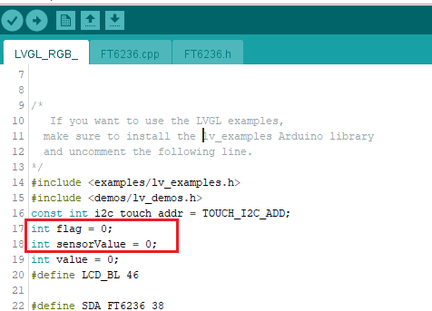

6 Add two variables in the arduino main program file for image switching and slider sliding changes.
7 pin 40 to input mode in setup().

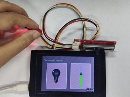

Operating effect:
After the program is successfully downloaded, check the effect on the screen.
