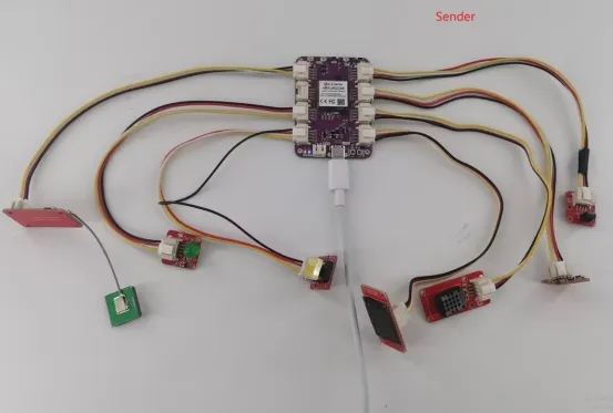

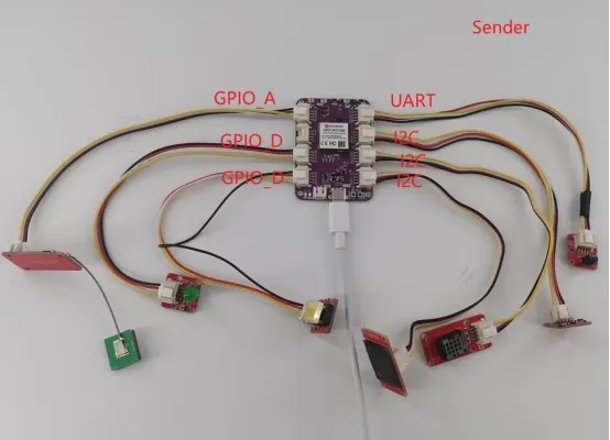

As shown in the figure below, we are using the nRFLRCC68 module with each interface connected to a sensor. This setup allows us to collect data from each sensor and transmit the data to another nRFLRCC68 module using LoRa technology. Finally, the received data can be viewed through the serial port.

Bulb: Connected to the nRFLRCC68 module's GPIO_D interface, which corresponds to pin 26
Button: Connected to the nRFLRCC68 module's GPIO_D interface, which corresponds to pin 12
DHT20 Temperature and Humidity Sensor: Connected to the nRFLRCC68 module's I2C interface, which corresponds to pins 13 and 14
Accelerometer: Also connected to the nRFLRCC68 module's I2C interface, pins 13 and 14
u8g2 Display: Connected to the nRFLRCC68 module's I2C interface, pins 6 and 7
IR Receiver: Connected to the nRFLRCC68 module's UART interface, which corresponds to pins 22 and 24
GPS Module: Connected to the nRFLRCC68 module's GPIO_A interface, which corresponds to pins 29 and 28

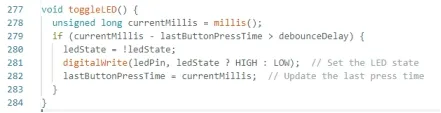

The main function is to turn the bulb on or off by pressing the button.

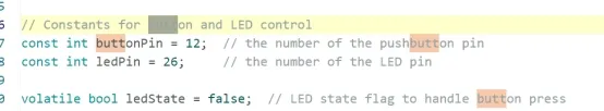

First, define the pins for the two interfaces.
Then, in the setup function, configure the pins as input or output and set the interrupt condition.
Interrupt configuration: connect the button pin (14) to an interrupt, assign the interrupt service routine to toggle the LED, and set the trigger condition to rising edge (i.e., when the button is pressed).
And then, set the logic for turning the bulb on and off.

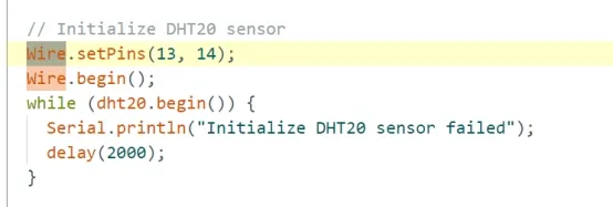

DHT20 Temperature and Humidity Sensor¶
Initialize the libraries and variables to be used first.
Then initialize the temperature and humidity sensor in setup.

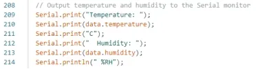

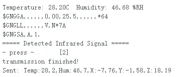

After retrieving the temperature and humidity values, you can print them to the serial monitor to check the values.

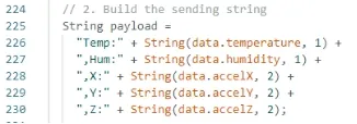

Then, combine them into the payload variable for easier transmission together.

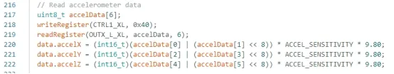

First, according to the technical manual of the LSM6DS3 accelerometer, explain and define its relevant registers.
Since both the accelerometer and the temperature and humidity sensor use the I2C protocol, their pins have already been initialized.
Then, in the loop function, repeatedly retrieve the acceleration values in all three directions.
The writeRegister and readRegister functions are custom functions we’ve written.
(You can refer to the code for more details, as the comments provided are quite detailed.)
writeRegister: Writes data to a register
readRegister: Reads data from a register
After obtaining the acceleration data, combine it into the payload variable for easier transmission together.
Finally, transmit the data to another nRFLRCC68 module.

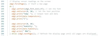

U8g2 display screen¶
In this experiment, we also added a display to show the temperature and humidity values.
At the beginning of the code, the display configuration is initialized.
Although the display also uses the I2C interface, here we are using software-based I2C.
And in the setup function, initialize the display.
Then, in the loop function, set up the display and continuously update the displayed values.

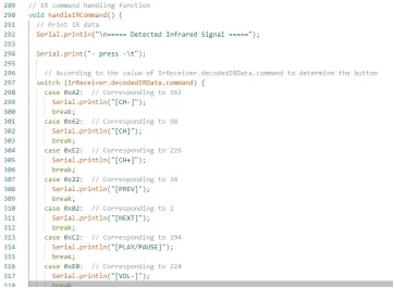

In the loop function, continuously process and receive the infrared signals sent by the remote control.
You can specifically map the key values represented by the infrared remote control buttons.
Here, I pressed the key value "2" on the infrared remote control.
After receiving the infrared signal, the corresponding information will be displayed in the serial monitor as shown below.

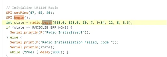

First, initialize the pins for the LoRa module.

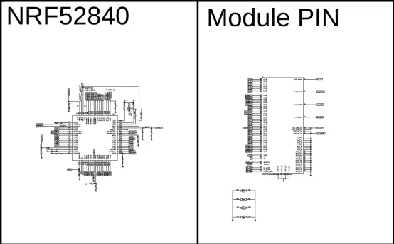

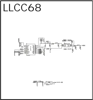

You can open the schematic diagram we provided.
In our schematic diagram, you can identify the pins required for the LoRa module based on the nRFLRCC68 chip's pins.

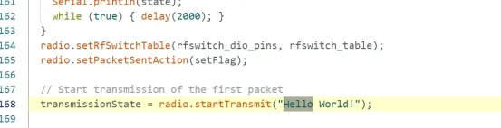

In the setup function, configure the relevant settings for the LoRa module.

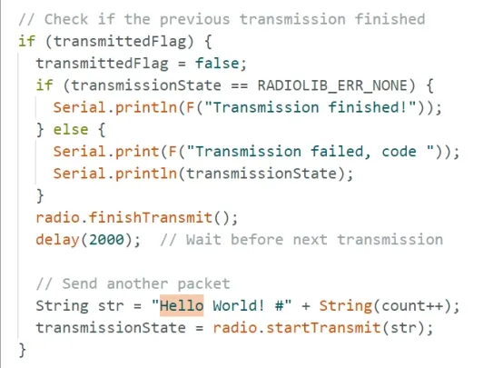

Finally, in the loop function, repeatedly send the data collected from the sensors.
The overall data sent by the transmitter is shown in the diagram below.

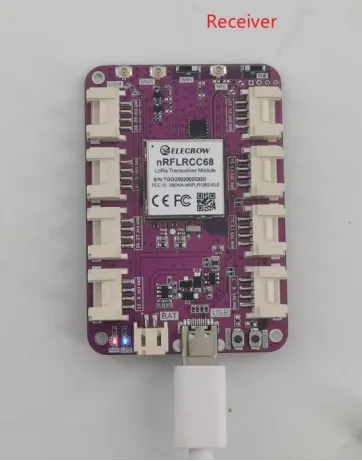

This is the overall structure of the transmitter. Next, let's take a look at the code structure for the receiver.
Receiving end¶
The receiver also starts by initializing the pins for the LoRa module.

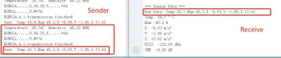

Next, the data sent by the transmitter needs to be parsed.
The parseSensorData function is a parsing function I wrote. I won't go into detail here, but its purpose is to parse the data that was packaged and sent over.

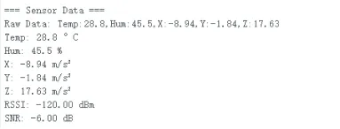

You can compare the sent message with the received information.
Perfect! The LoRa module successfully transmitted the data!

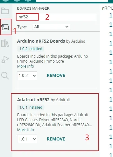

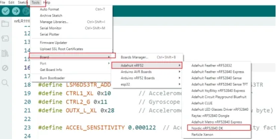

Since the nRFLRCC68 uses the nRF52840 as the main control chip, you need to install the nRF52 development board.
Open the Arduino IDE.

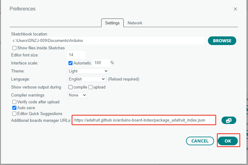

Go to File > Preferences (or Arduino > Preferences, depending on your operating system).
In the "Additional Board Manager URLs" field, add the following URL:https://adafruit.github.io/arduino-board-index/package_adafruit_index.json. If there are already other URLs, make sure to separate them with commas or new lines.
Click "OK" to save the settings.
Navigate to Tools > Board > Boards Manager.
In the search box, type "Adafruit nRF52", find "Adafruit nRF52 by Adafruit", and click "Install".
Once installation is complete, you can select the appropriate board model from the Tools > Board menu.

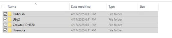

Use the library files we provided
